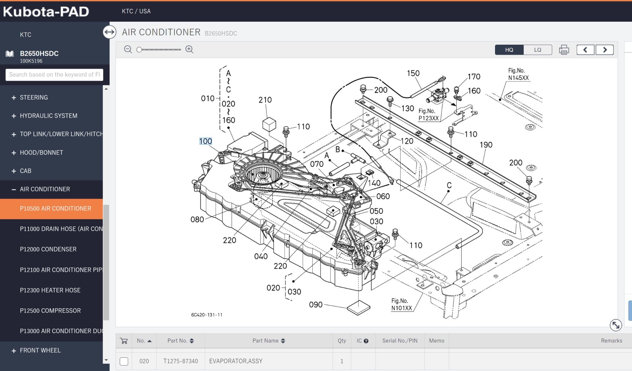

Maybe you didn't get a vent door rod in the correct position?
Start by looking at the illustrated parts diagrams here:
or

Will do, can you tell me what the valve at 150 is. I do not believe I any door rods between testing and reassembly, but I DO know that valve the little lever on top was bent, as well, it did not appear to have the sheath on the cable like it shows in the diagram. I even remember taking note and wondering how without the shield being retained the cable could even work. bent the lever back level, and even checked to make sure it moved. I do not know if I however got it back in the correct position so it seems a logical place to start.
Never worked on a tractor but repaired many things like that from bikes to lawnmowers, the concept is simple.
Do you know what that valve is and could it be the source of the issue?
Sabre
B2650
Apr 5, 2023
I just noticed you provided the link under the images, and I am using the pats diagram interactively now, likewise I have seen that is a water valve. Presumably to channel hot water for engine to heater component?
Therefore is it possible if stuck in the wrong position that accounts for why I am getting hot and cold at the same time?

I couldn't tell you. I do not have a cabbed B2650. I just wanted to provide you with a link to the parts diagrams.

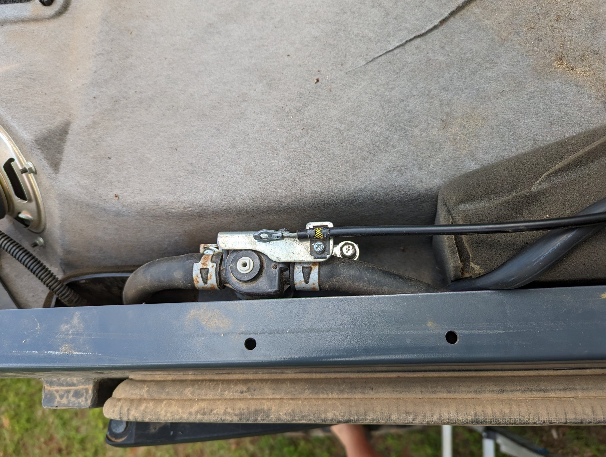

Alright, for posterity in case anyone else has a similar problem , this valve was indeed the issue.
At least half of it....
I took the top back off and watched the unit in operation, the servo that operates the doors, when it tried to rotate, could not fully.
The cable going to the valve had a kink in it I did not previous see.
This was preventing the servo from fully rotating AND preventing the valve from actuating.
I could likely get another cable and fix it properly, but this is east Texas, times a year I will need a heater are close to or at zero. Days I will need an AC, almost every day I am in that cab....
SO I disconnected the cable, rotated the valve open and took the lever off, AC working like a charm!
Hope it helps someone else.
