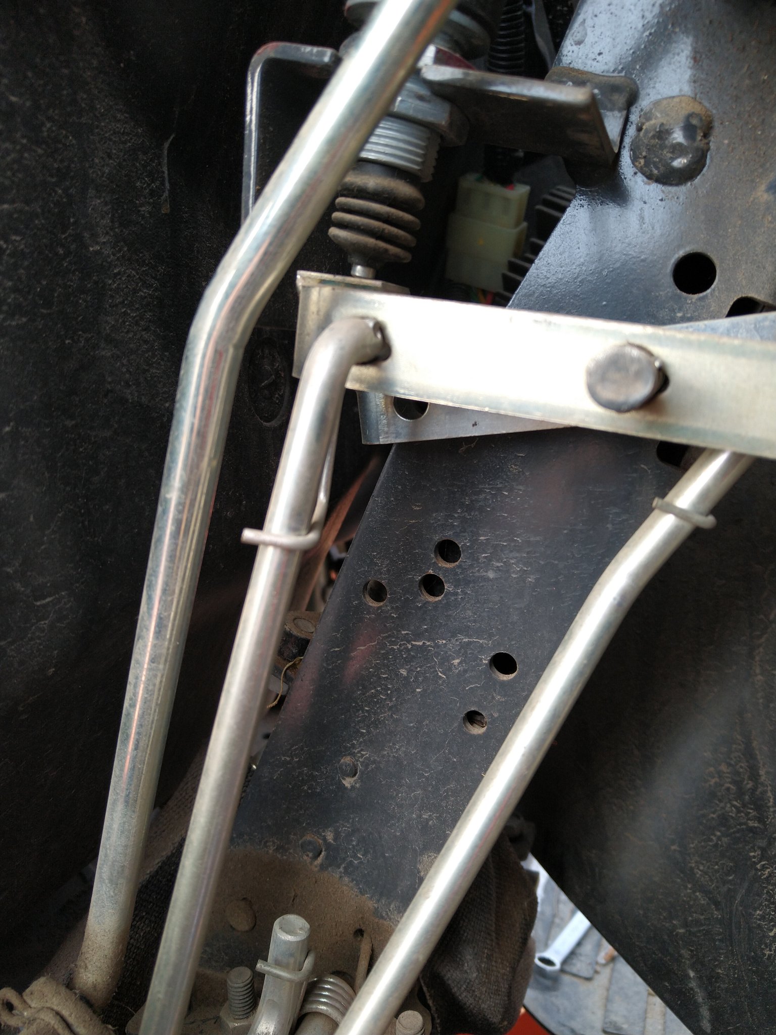

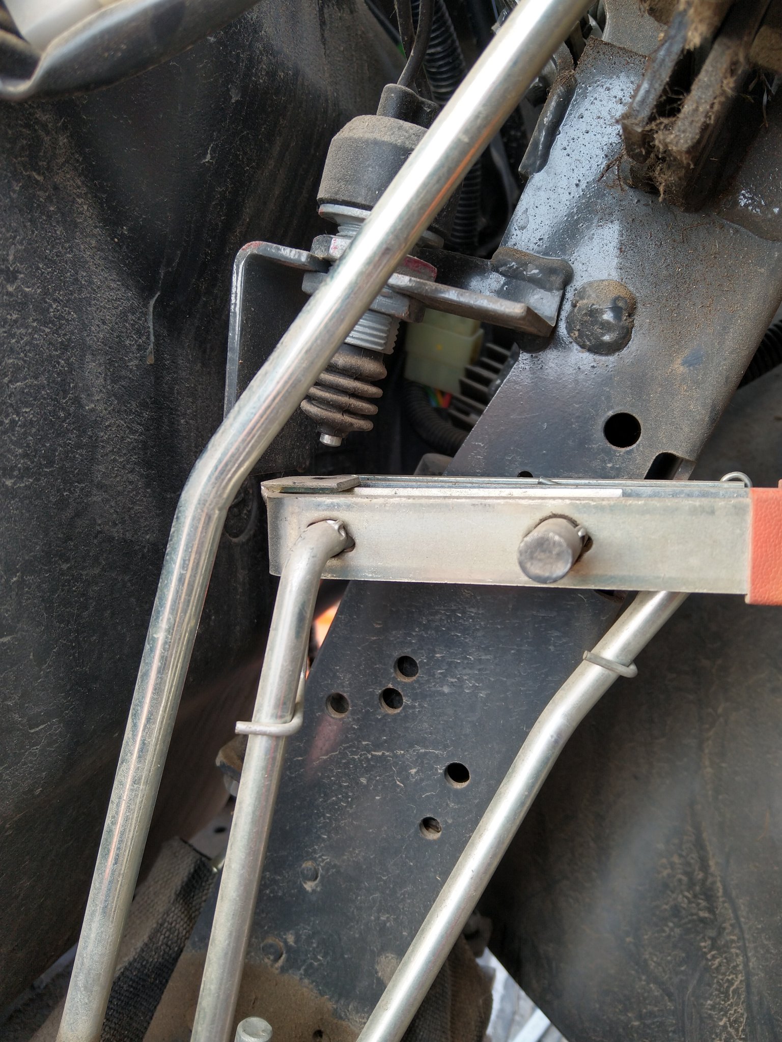

nbryan
Jan 3, 2019
1,307
829
Hadashville, Manitoba, Canada
Parking brake switch is tied into the insane amount of safety switched on the 2650. It allows you to run the PTO without an ass in the seat, at least on the cab models.
This is the parking brake to PTO interlock switch with my B2650 dash panel removed. I had to adjust the switch after doing maintenance adjustments on my brake pedals' travel, it wasn't pushing that button anymore with the emerg on, pto shut off if not in seat. Adjusting the switch lower fixed the issue.
Just showing it here as a possible reference for any shorting out search possibilities.
Brake off:
Brake engaged:
No wires near those levers in this area, anyway.
