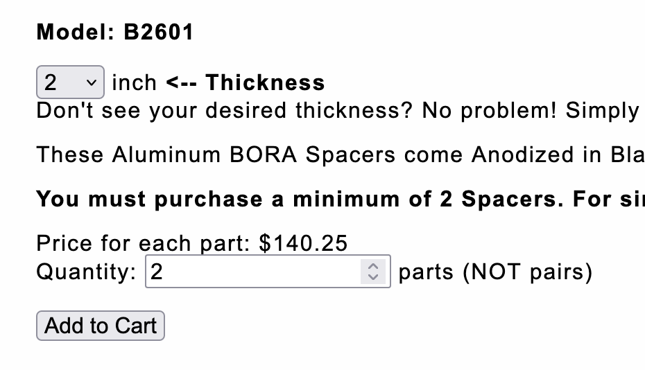

Thanks, looks like about $300. Sat on the 2601 today and it seems like 4" wider stance would be nice.
