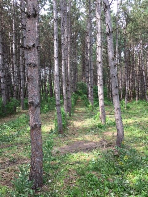

Have an overgrown pine tree farm that I am thinning over time. Tight rows of pines with widths from 70-55". Unfortunately, it only takes a single misplaced tree to deny access to my existing 64" wide tractor + 62" rotary cutter. Was originally considering a L3301 upgrade, but even with R1's at minimal width, my 62" (external width) King Kutter rotary cutter becomes the blocker. Therefore, a 48" rotary cutter and appropriately sized tractor appears the next best option.

Two pictures below to help visualize what I am up against. Thanks for any feedback.

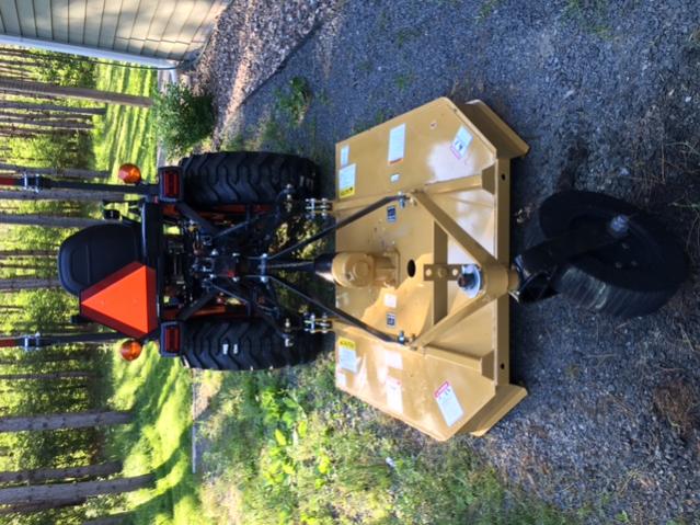

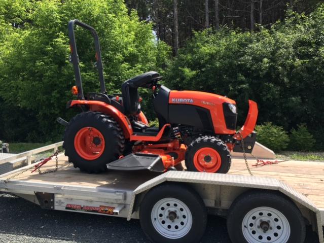

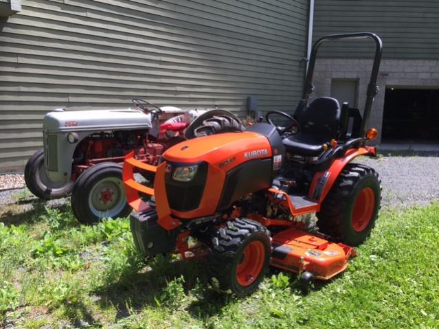

A couple critical parts (rear remote valves) were delayed and dealer got them later yesterday (Friday). He brought in a tech Saturday morning to complete installation and then delivered the finished product.
Tried out the MMM and it was so easy compared to the rotary cutter on the 8N. Biggest "issue" is the directional nature of the mower chute. Some operator retraining required to address this little aspect. The combination of power steering and ground speed independent of PTO speed almost made it too easy. Not quite twice as fast cutting on my first try, but pretty close. Best part is that it will be usable by the wife, allowing another operator in the seat.
First attempt at removing the MMM was frustrating. My own fault as my removal location was not as flat as expected. Suspect the R4s reduce clearance a bit and that can make it even harder if the ground is even slightly elevated. Had to reattach and find a better spot and then it went pretty smoothly.

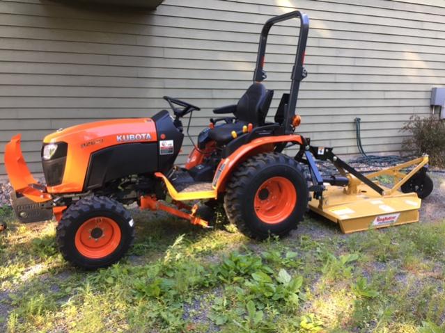

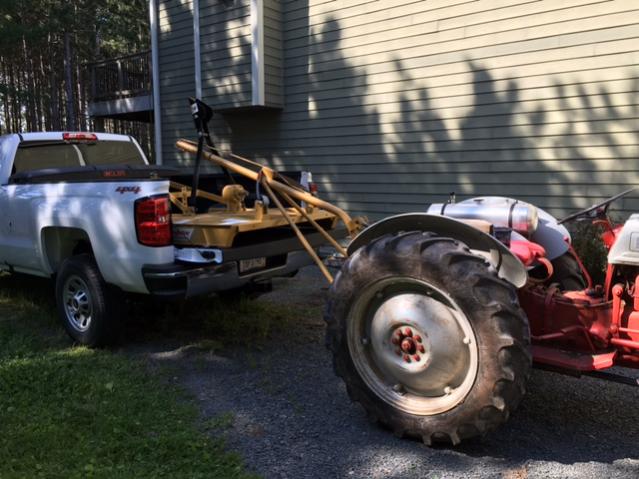

Having purchased my prior rotary cutter years ago, forgot the fun of removing from the truck and doing the assembly. (The Land Pride cutter is too wide and would have proven problematic-- however, midway through dealing with the King Kutter, was kind of wishing had just gotten one from the dealer.) Nonetheless, some persistance and the new one was seup. Per the picture, the 8N proved it was not getting replaced, just getting a nimble partner for certain tasks. Will run the rotary cutter through the trees tomorrow and see how it cuts the buckthorn.
Pictures:
#1- Arrival
#2- Next to its older buddy
#3- Older buddy unloading the rotary cutter (old school style)
#4- With rotary cutter attached
#5- Visual of tractor/rotary-cutter width match (one of my key criteria)

Spent 2.5 hours with the rotary cutter today and was super happy. Never got round to measuring the final tire width, but am guessing its closer to 49.9" (or just under). I tested the limits and managed to pass the tractor through a couple trees where the rotary cutter would not fit. Easy enough to resolve by backing up a bit and raising the cutter beyond the butt of the adjoining trees.
Compared to my 8N, it was almost too easy. The wife came out with a "replacement beverage" and I was so happy and focused, had not finished my prior refreshment. (Lets just say that does not happen often.) Fun little tractor and really appreciate how easy it is to maneuver!
