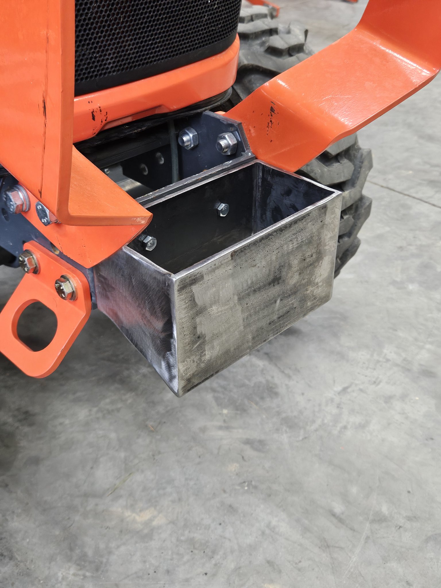

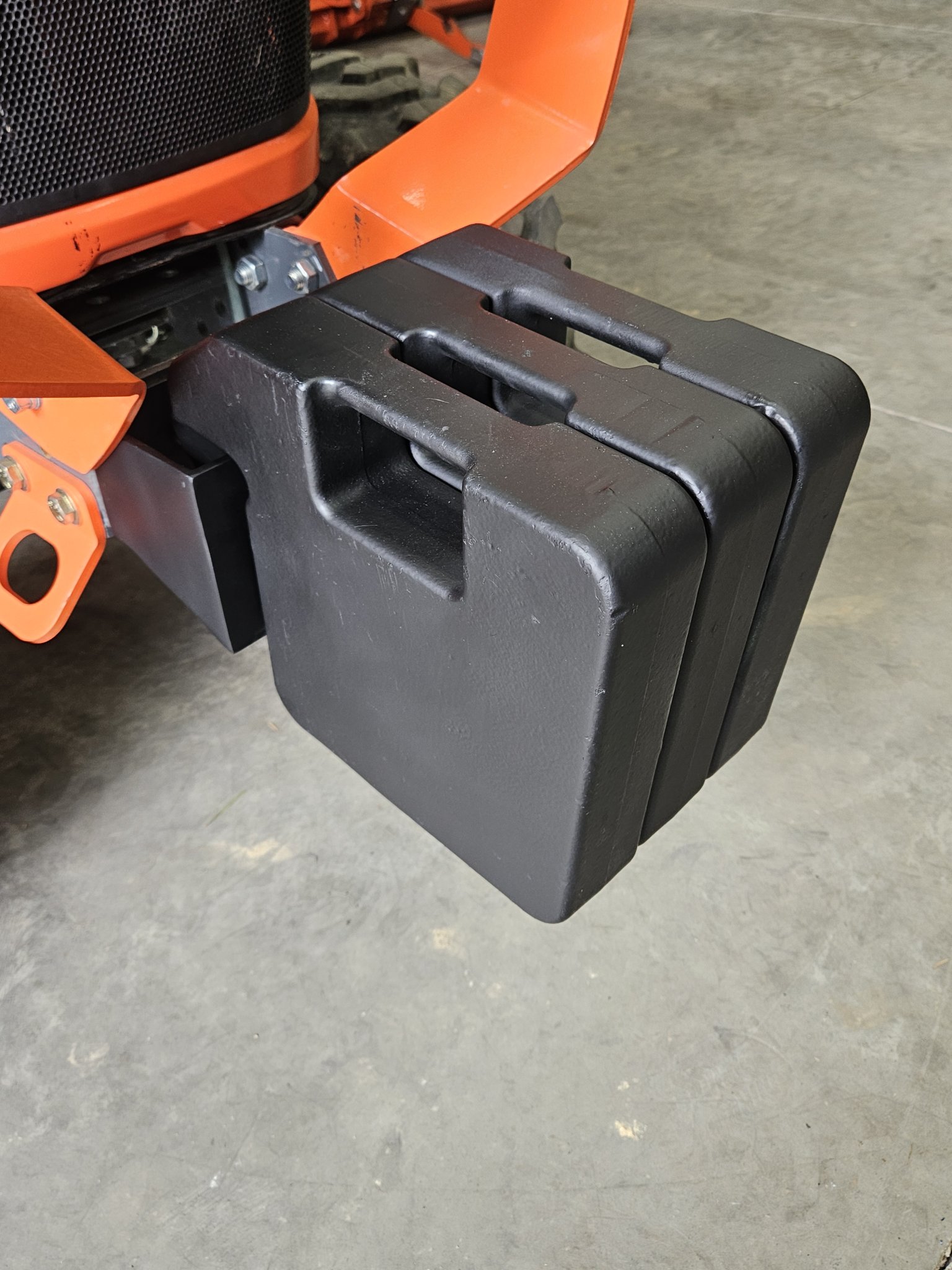

I struggled finding anything Kubota. Ended up ordering three of the 70# JD weights and fabing up a bracket. Bracket doesn't have to come off for FEL and weights just slip on and off bracket (no bolting the weights).

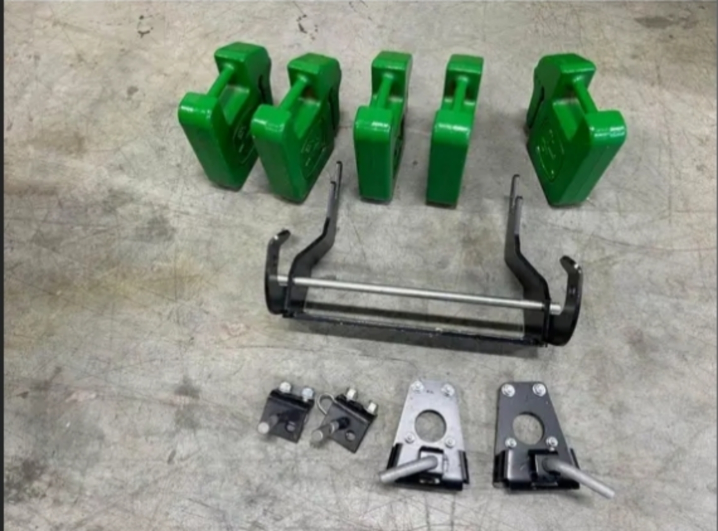

If you were in WA State (westside) I have a weight pack for sale. There are actually SIX weights. 300 Lbs. The package is meant to be used on a John Deere Signature Series.

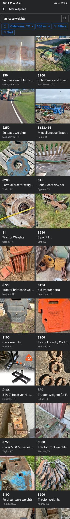

If you're a Facebook user, Marketplace is a good source. You might get lucky and find a set nearer you.
Update -->> You're surrounded by availability in the used market!

I have looked at used suitcase weights but, I haven't found any for a tractor like mine. Yes, there are a bunch of weights in the used market but, most are for skid steers and big tractors and won't work without building a custom weight bracket which then ends up costing the same as or more than new factory weights.
