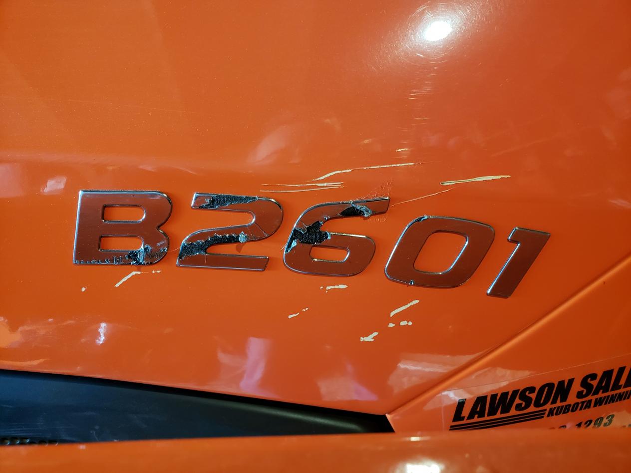

Just wondering if anyone else has scratched there hood while removing/installing the loader. One of the steel hydraulic lines seems to hit the hood if the tractor is not lined up perfectly.

I have about a 6" scratch on the hood where I must have hit the hyd line fittings. I noticed it the other day. They dont give you alot of room on either side so just have to be real careful.

The 2601 decal is all scratched as well as the hood. I think the dealership is going to replace the decal as well as paint the hood. I had a bx2230 for 13yrs and never had any issue removing and installing the loader.

Yup. Been there and done that. Pictures from SLAUSO looks just like my hood. Going to touch up the scratches to prevent rust and replace the Kubota decal. When I first saw what I did my initial thought was replace the hood. Checked the price and that's not going to happen any time soon. Just need to be more aware next time.

quick update: Kubota has agreed to replace the hood and decal. The hydraulic lines that came with the loader should have been straight where they connect to the rubber hydraulic lines. I showed my dealer pics of LA434 loader that had the straight lines. His parts listing only shows the straight steel lines. Kubota will replace the curved steel lines with the straight lines also. Will post pics when the warranty repair has been completed.
