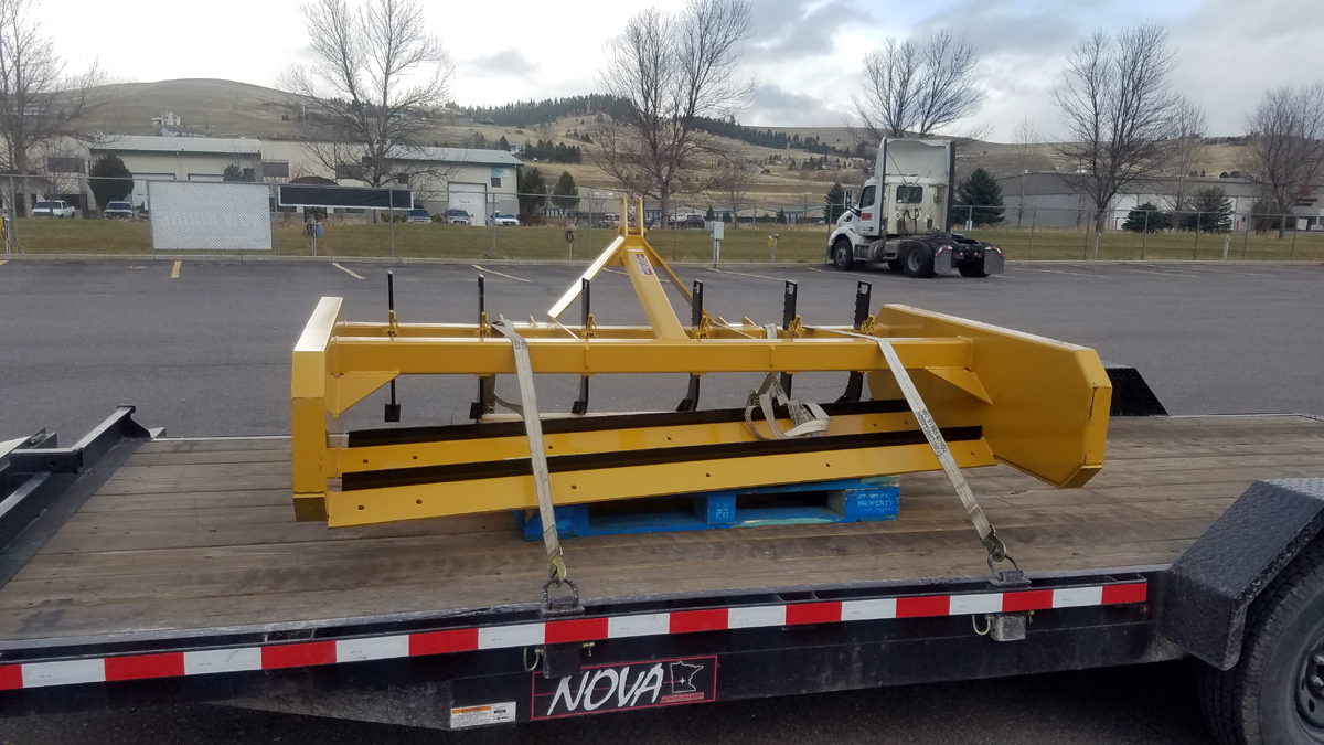

From the pictures, on the LP site, they seem to have the same adjustments. They are also both QH compatible.
One thing to consider is the GS1560 is heavier with heavier blades. I think that is an advantage as long as it isn't too heavy for your tractor. I don't think the GS1560 is. GS0560 is 350 while the GS1560 is 525 from what I've found.
Fwiw, I haven't had to adjust my blade height on my GS2572, and I've used mine for a couple of years.
