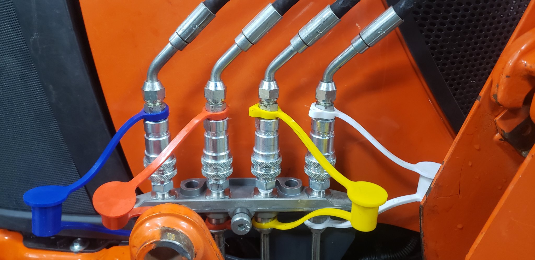

orange crusher - that looks clean. Nice work.

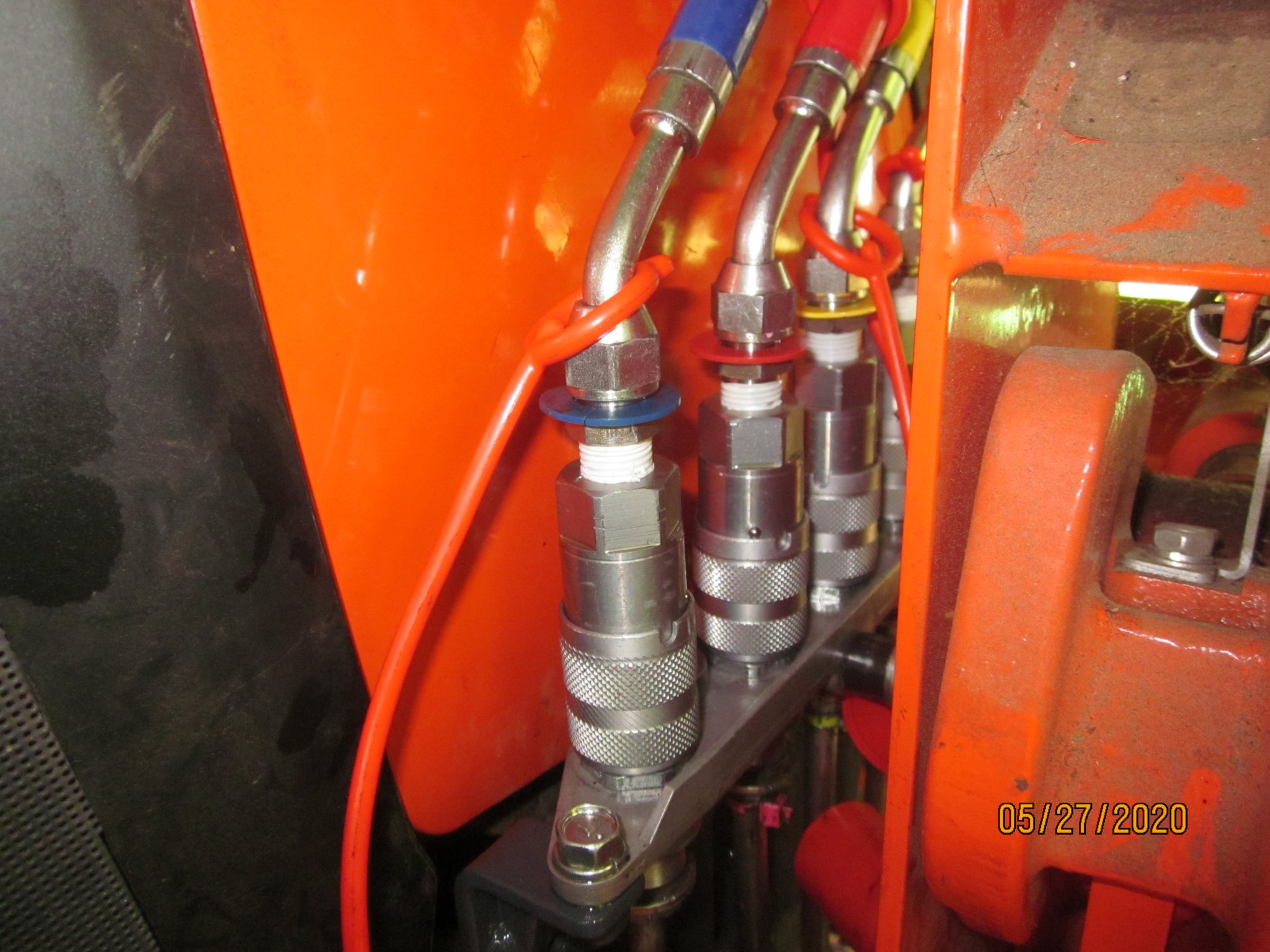

Here is what I ordered to convert the B2601. From Summit-Hydraulics dot com: 1/4” NPT female flat face female quick connect sku number FF14F-04N.
From Discount Hydraulic Hose dot com: part number 2404-06-04, 3/8” JIC male x 1/4” NPT male.
To confirm, the hoses on the loader (that feed into the coupler with the lever) are female 3/8" JIC?

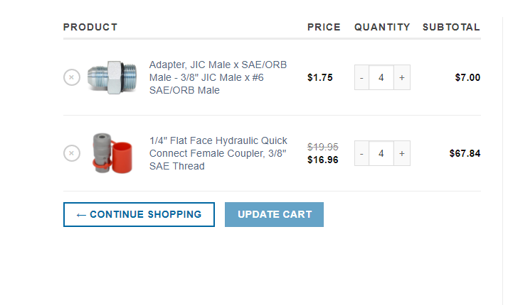

I'm thinking about ordering today. I'm going to get SAE fittings instead of NPT, and order everything through summit hydraulics.
greg86z28
May 17, 2020
303
172
South Central Wisconsin
Before I ordered I did double check. I've got female 3/8" JIC connections on my loader hoses. On the tractor side I've got 1/4" FF Male connections.
So it'll be 3/8" JIC Female (hose on loader) -> 3/8" JIC Male / 3/8" SAE Male -> 3/8" SAE female / 1/4" flat face female -> 1/4" flat face male (connector on tractor)
The bolded parts above are what I'm ordering from summit.
I think that's right or did I overlook something?
