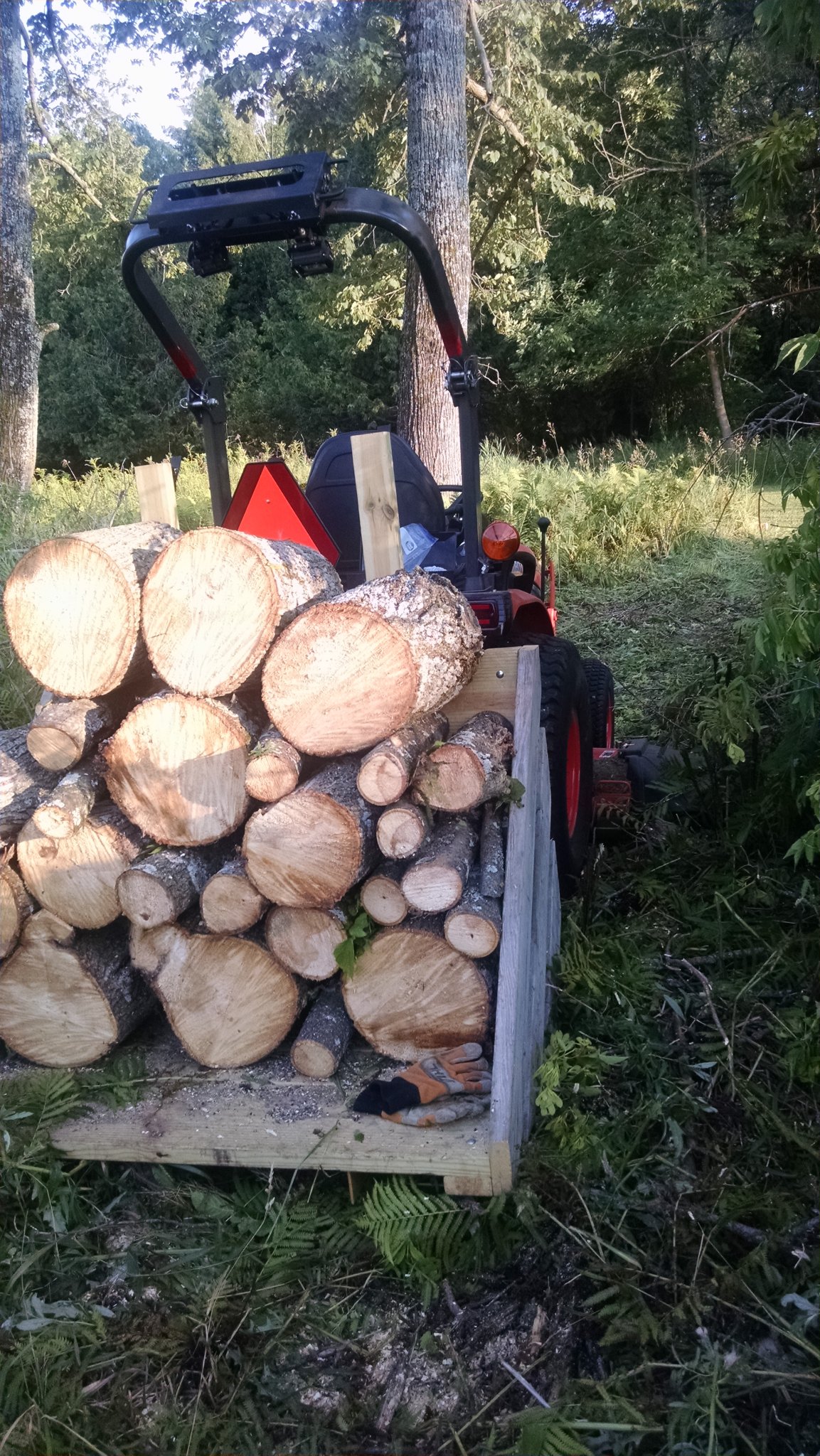

I put this whole thing together for 237 bucks.
3 point receiver adapter
receiver cargo carrier
Plano trunk

Me like! How does that hook up to the tractor? I can't quite see it in the other pic... thanks!
Its on the 3 point. The B2601 picks up a good amount of weight on back.
The 1st picture is without loader on.. the steering was light in front.

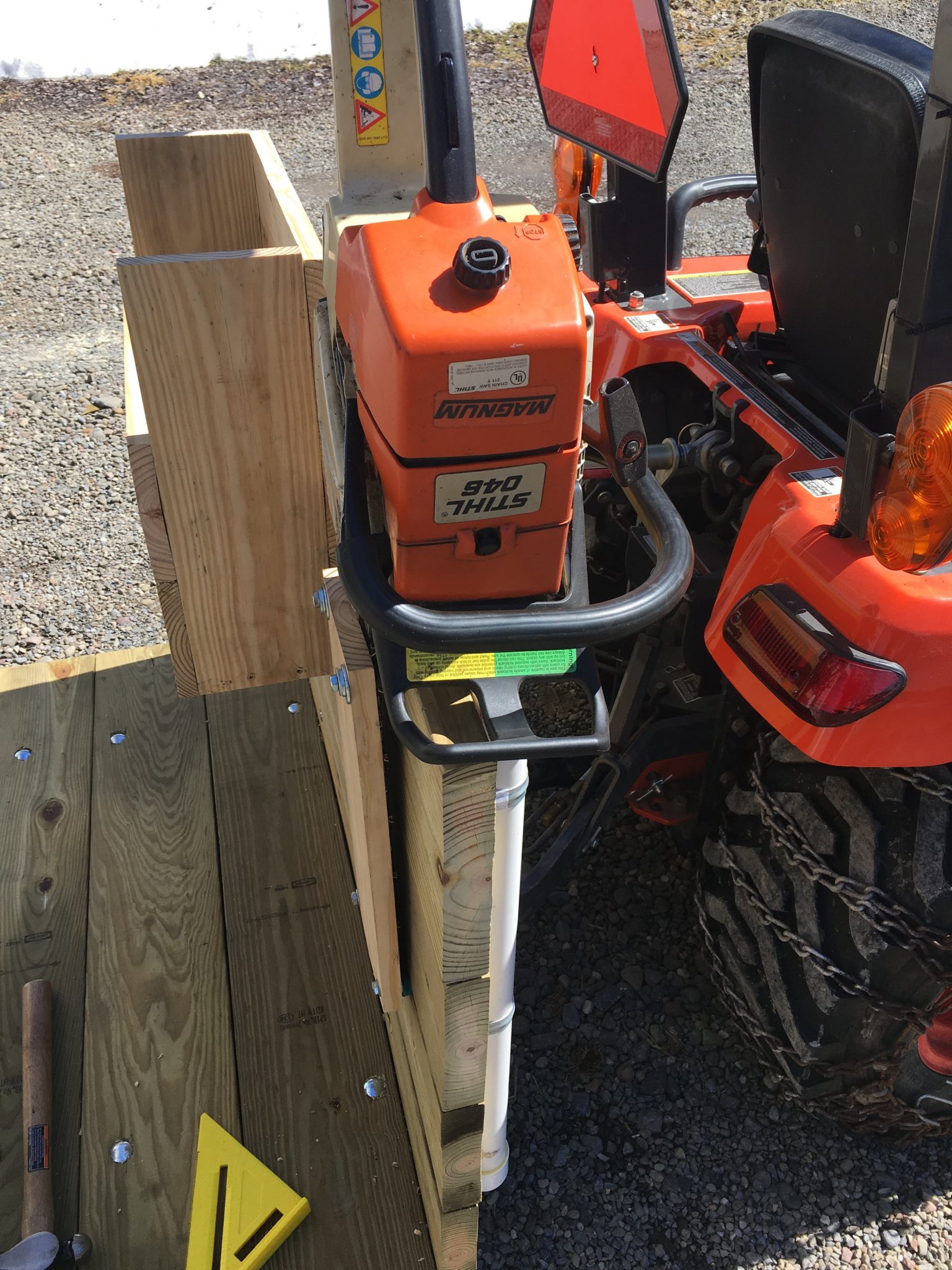

For the chain saw look into a Saw Haul.

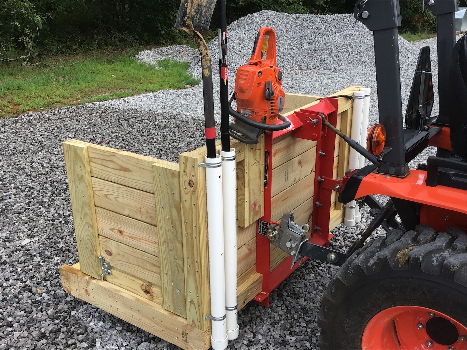

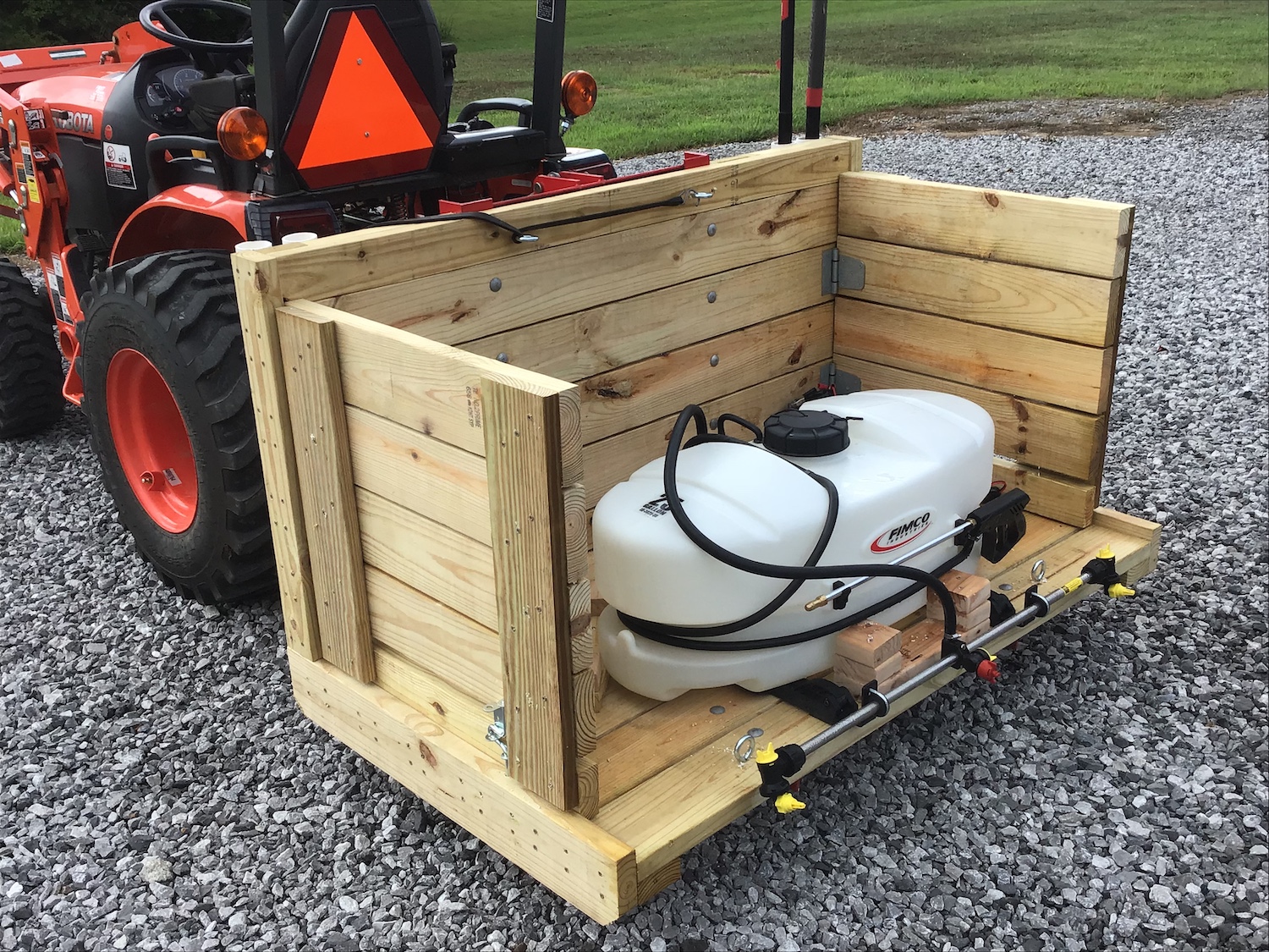

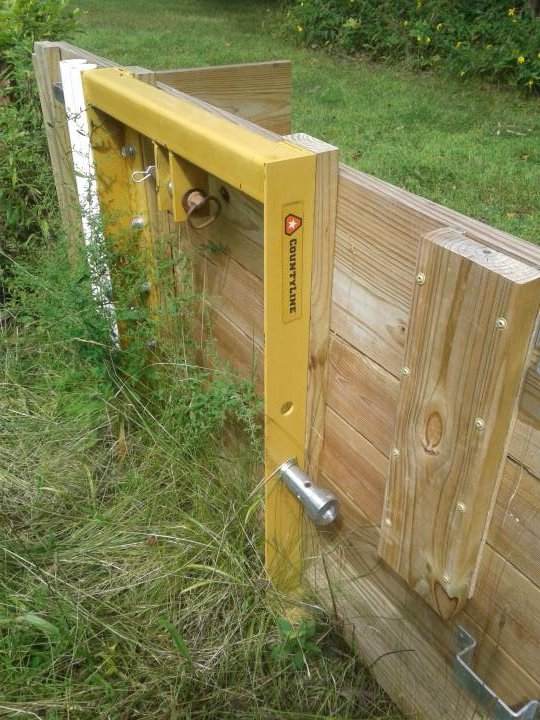

Just built for my B2601. Only thing left to do is finish the rear removable tail gate. Waiting on some Bed Claw plates to come in the mail and she will be done. Plans at DIY My Way.

Just built for my B2601. Only thing left to do is finish the rear removable tail gate. Waiting on some Bed Claw plates to come in the mail and she will be done. Plans at DIY My Way. View attachment 65165 View attachment 65166
Tom which frame did you use and where did you purchase? I can only find the one at TSC and requires some creative construction to get it quick hitch compatibile. Great job!

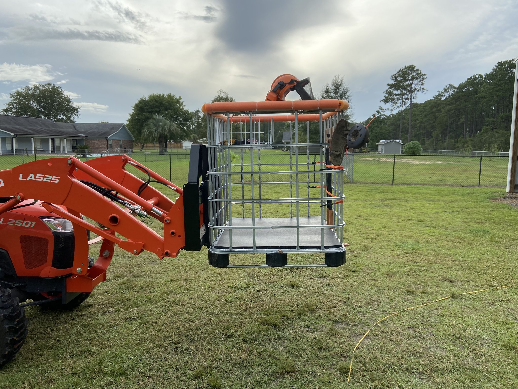

Also you can make a cherry picker pretty cheap. Built this for less that $100. Great for pruning trees and carrying equipment to the site. The “trimmer” is a combi system from Stihl
and is also a pole saw. Need pallet forks though. That obviously is not factored in the stated cost.
DIY my way has a follow up video on mods others made to his design. To provide clearance for the QH hooks, you only need some 2x4 spacers.
If you have already built it, you will need to make the sides 1 1/2 " smaller.
The frame is from Rural King, King Kutter I believe. My high priced Landpride QH15 quick hitch has been gathering dust since I got the Pat's Quick Hitch. Like the Pat's soooooooooooooooo much more.
Thanks. I looked for that Rural King one but can’t get it without paying huge shipping. I thought about the Pat’s but ended up getting the QH15 too.

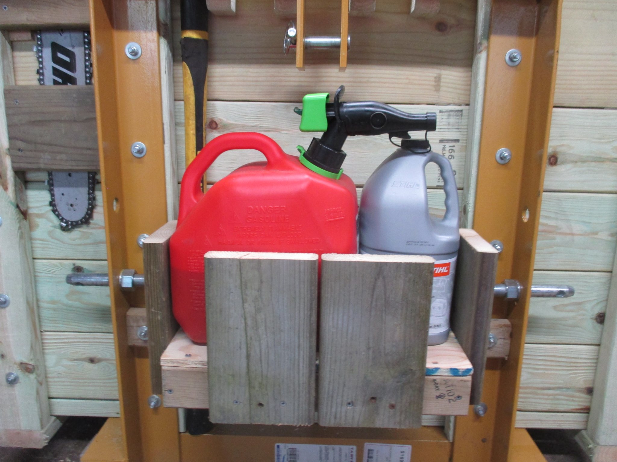

Carry-all here also. There are a couple pieces of PVC for rakes, shovels,etc.
Same frame as i7win7. Like he said, spacers are handy. I just knotched the back of the back 2x's, but a spacer is the easier way to go.
I think a must-have is a quick hitch. I can pick up and drop the carry-all in seconds.
