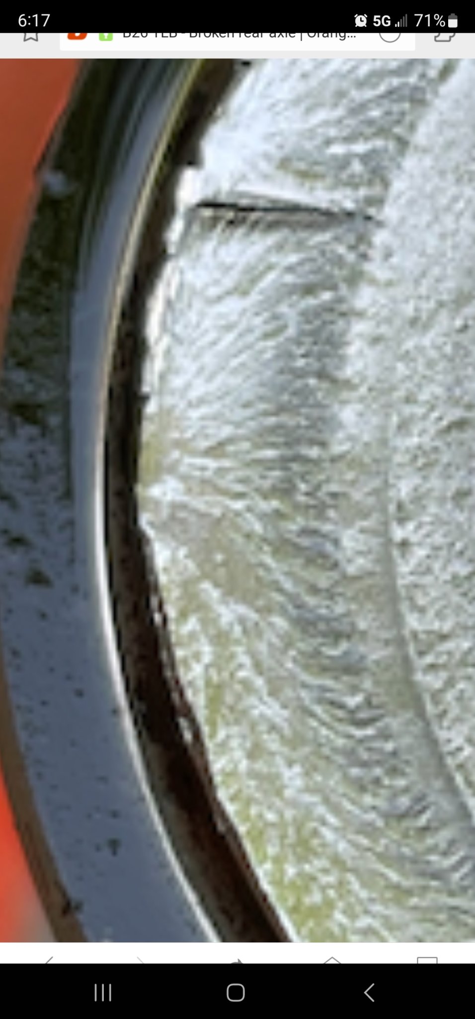

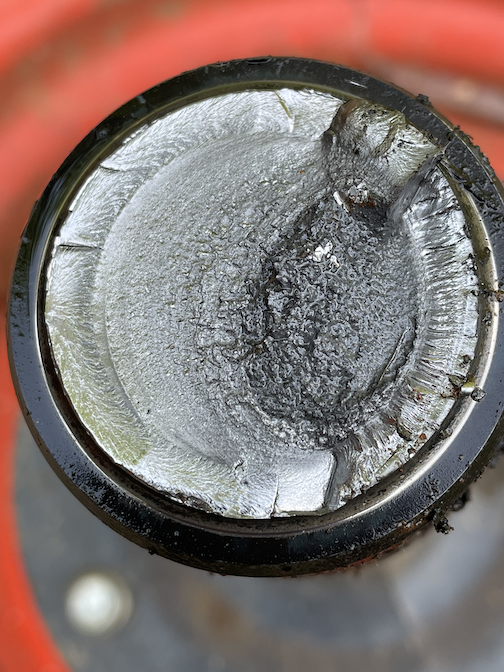

About ten days ago while repositioning my B26 TLB digging a trench, one of the rear axles broke. The break was just inside the transmission case. This means that a lot of UDT2 hydraulic fluid was dumped on the ground. For reference, this is a 2011 B26 TLB with 943 hours. I bought it used in 06/2021 when it had 842 hours.
At the time of the actual break, I was simply backing the tractor. The stabilizers were up. While doing the digging with the backhoe earlier the stabilizers were down.
The reason for my post is to see if anyone has had anything similar happen. My local dealer (Mason Tractor Company in Norcross, GA) has the tractor. I am hoping to meet with them in a few days to discuss moving forward.
Below is a link to an end-on image of the broken axle (as well as an attached file image). I am not a metallurgist, but this doesn't look like just a stress break. To me, it seems this axle may have had issues from the factory. I've asked my dealer to consult with Kubota on this. But the service manager doesn't think Kubota will be any help.
One complicating factor is that in 07/2021 (about 100 hours runtime ago) I installed a pair of 4" rear wheel spacers (from motorsport-tech.com) to improve stability. My property is not at all flat. The wheel spacers really improved the tractor's stability. But, they did push the rear wheels out 4" on each side. I know this would increase the stress on the axles, but it seems that Kubota has offered some sort of wheel spacers at some point in time. If true I would think the stock axles would not have been overly compromised by adding these wheel spacers.
Among my many questions are:
1) Would / should Kubota consider replacing the broken axle and associated parts (bearings and seals and fluids)?
2) I feel I should consider replacing both the rear axles not just the one, suggestions?
Thanks, Paul
Link to a photo of the end of the broken axle: Broken axle (end-on) photo
This appears to be a ductile fracture that transpired in short order due to the lack of oxidation that would suggest a long period failure.
It is plain to see the difference in microstructure edge to center owing to the transverse position of the evidence.
Whilst I cannot preclude a long or protracted period to the fracture, the evidence, as presented, suggests a short period of cycling to ultimate failure.
The area at 3 o' clock represents the final failure. Note the shoreline features directly opposite at 9 o' clock. These likely represent the origin direction of the initial failure.
Take note of where the fractures are pointing... that single point is a prime candidate for the initial failure.

looking at the photo, I would’ve guessed the initial fracture started over in the 3 to 4 o’clock area, and the final break occurred towards the 9 to 10 o’clock area…
This is only because the metal surface in the 9 o’clock area is freshly shiny, while the metal surface over on the 3 o’clock area looks much less fresh and shiny.
I’m certainly not claiming to know anything, and just stating my initial impression.

I am confident declaring the failure mode as "reverse bending".

sorry but....I can see that..
The BIG problem IS the wheel spacers. Unless Kubota offered them as an option for your tractor, it'll become a 'contest', with them arguing that the spacers you put on 'put undo stress' onto the axle, and was the cause of the failure. For the first +-800 hrs of use, it was fine, then 100 hrs of spacers, bang, it broke.
Unless you can show say 6-12 other ,same model tractor WITH 4" spacers , running fine with over 100+ hrs, I think you're outta luck and will need a at wallet for the repair.

The dark patch at 3 o' clock represents steel in tension, being torn apart and letting go at grain boundaries. That's why it's dark.
The light areas are the grains being sheared in half as opposed to being pulled apart.

I don’t see any signs of rust or corrosion that might indicate that the brake might have been occurring over time.
Was this failure likely a catastrophic immediate event?
Wheel spacers certainly did not do anything to delay the break happening. They only enhanced the opportunity for it to happen. Another unknown is how the tractor was used/abused in the 800+ hours before the OP bought it.
I think we agree on that point?

Many thanks to all the respondents to date. Particularly to 'hagrid' for the metallurgical commentary.
I'm under no illusion that Kubota would offer up anything. But as Jimmyjazz implied, it doesn't hurt to ask.
My conclusion from the comments is that I will forgo the wheel spacers after having both axles replaced. An expensive lesson! While the wheel spacers are great for stability on non-flat ground, they appear to be particularly inappropriate for use with a backhoe unless the stabilizers are rigorously used to completely elevate the rear wheels. Suffice it to say I have not been that rigorous. Another lesson learned! My guess is that ANY lack of use of the stabilizers with the backhoe could also result in a broken axle even without wheel spacers.
