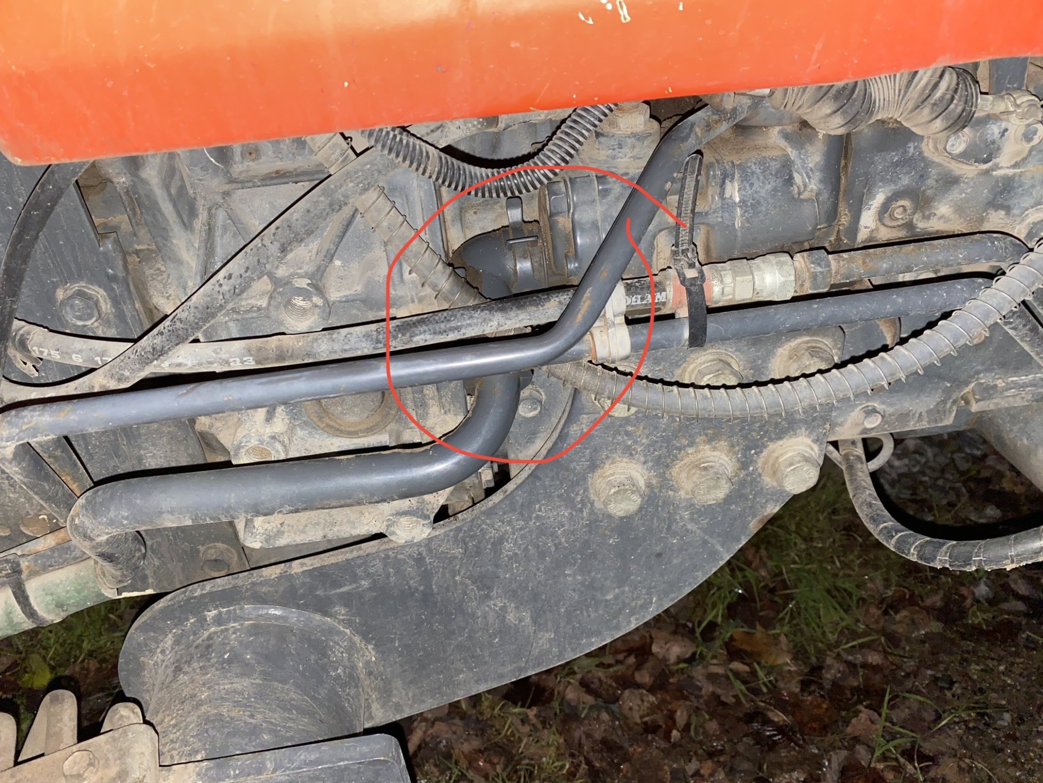

Ordered the new suction hose assembly which means the one piece pipe needs to be replaced.
My question to those who have done this is, when you get the long pipe out will a lot of hydraulic fluid pour? Is there a way to minimize the hydraulic fluid loss?

Best to drain the hydraulic fluid to start with. Drain into a clean bucket and filter when pouring back in.

I replaced the new line, new multiple piece design to eliminate stress on the rubber elbow during the 400hrs service so fluid was drained anyway. The line is near the top of the tank or above so shouldn’t be much oil loss if you don’t drain.
The hard line attaches to filter housing bolted to the oil tank. Just one bolt and o-ring seal but removed the rear tire to access. This also helps tilting the tractor to reduce oil loss.
My friend bought a new B26 about 2012 and was having to replace that rubber elbow frequently until the line upgrade. Rarely leaks at elbow but volcanos oil out the rear vent.

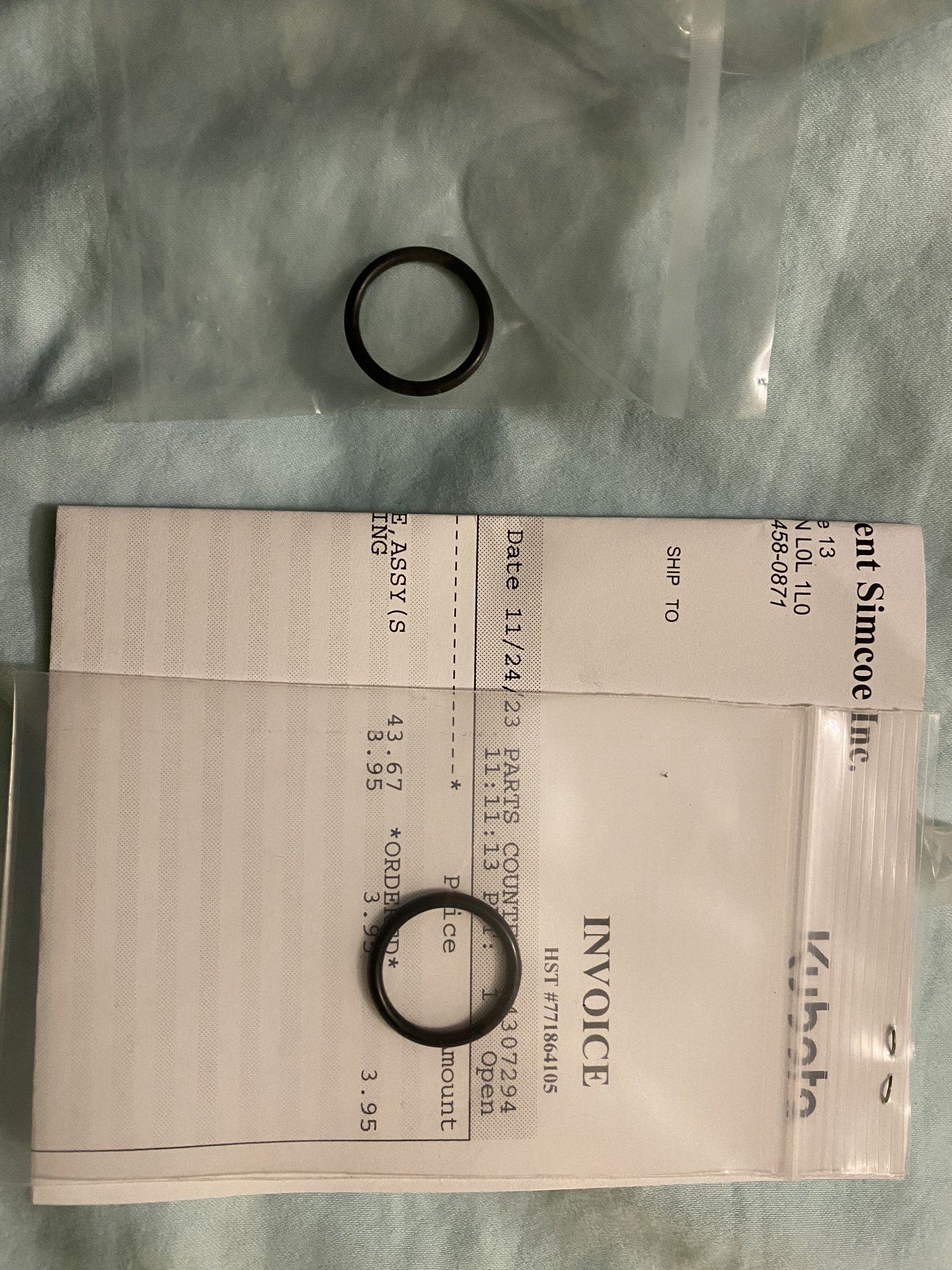

Picked up the parts and oil from the dealership couple a days ago. They attached an o-ring to my order said I'd need it. Who am I to argue, these guys deal with Kubotas day in and day out. Turns out there was an o-ring in the kit anyways.
Oh well, better an extra one than a missing one.

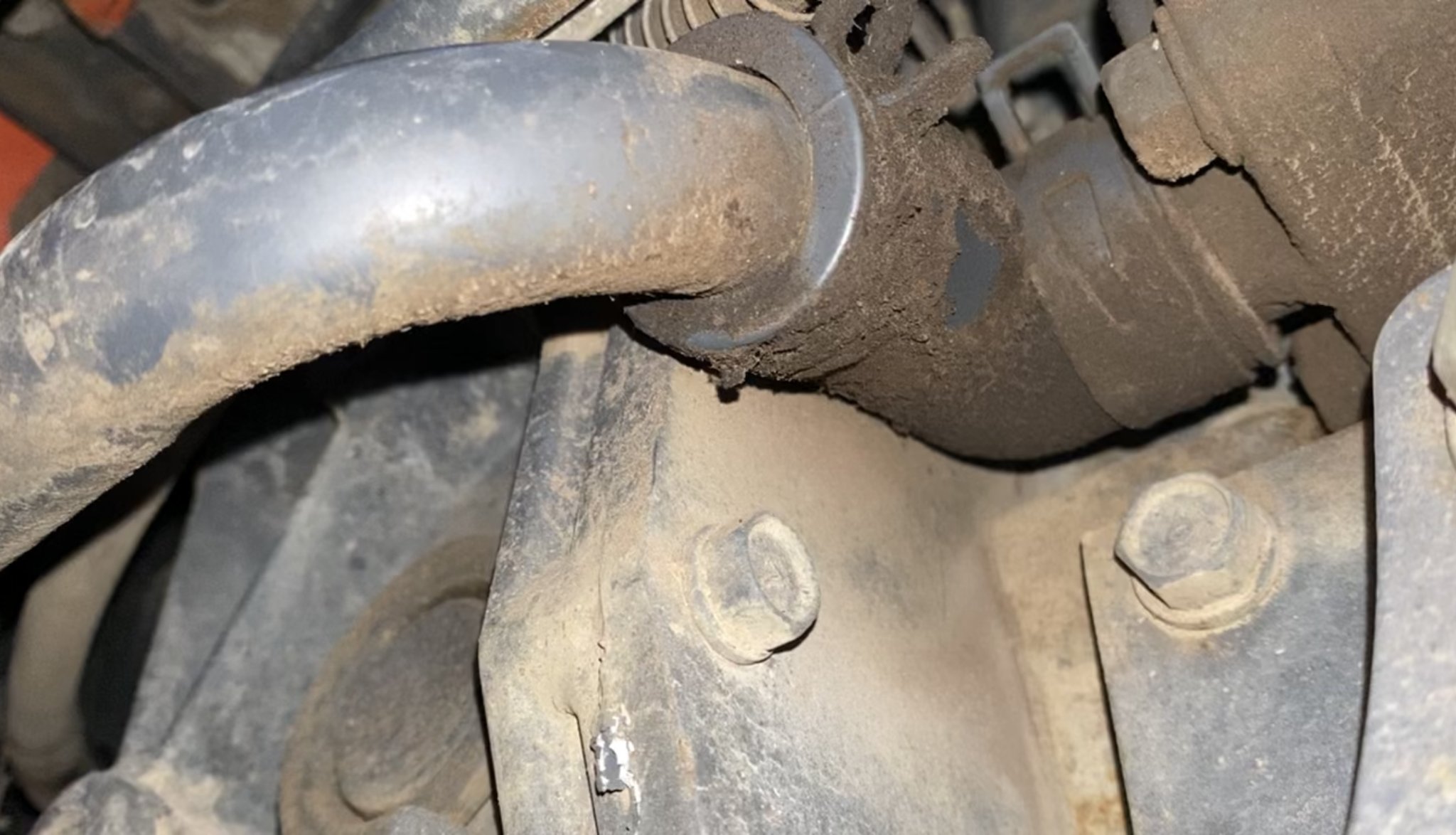

Took off the rear wheel and undid the front hose clips. Then the bolt holding the pipe on, with a 1/2" socket. When I pulled the pipe out of the rear oil started to geiser out of the hole so I put it quickly back on and grabbed a clean paper towel sheet and plugged the hole. Prepared the new pipe with the o-ring and replaced the plug with the pipe. This was at the rear. All in all I probably lost 1/2 a quart of oil. The front was less messy, only a few drops. One thing that surprised me was that the oil that came out was quite a dark color. Is this a hydrostatic transmission effect? This is my first tractor with hydrostatic transmission. I've never seen so dark hydraulic oil on any of my other tractors.
You were spot on about the elbow. Here's the post mortem

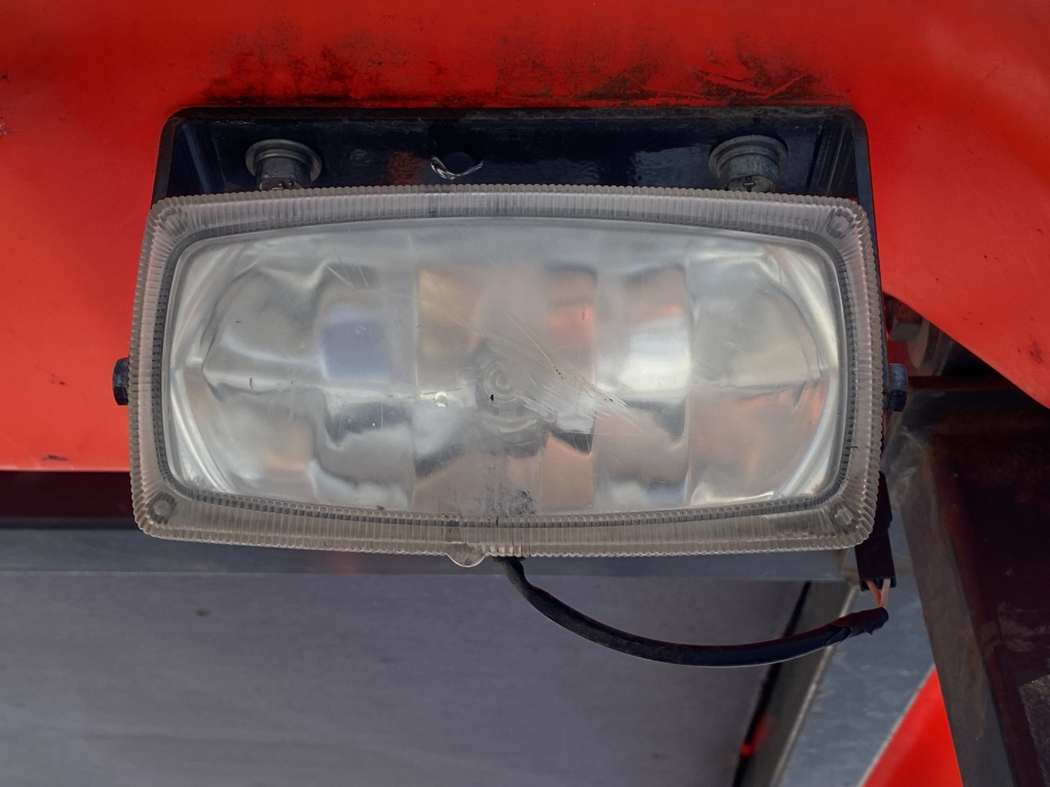

While I was at it I used some PlastiX on the lights lenses to clear out the fog.
Before
After

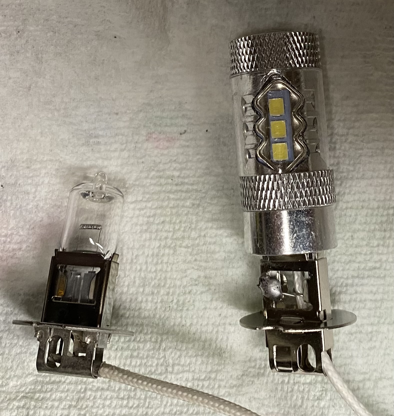

Ordered some LED bulbs to replace the halogen ones. Looking forward to get some action on this tractor.

Do yourself a favor. Return the LED bulbs and replace the lights/housing all together with LED. (if I'm reading it right and you're just replacing the elements)

I hear you about the LED bulbs, I might send them back, but thought I'd try and see if there's any improvement over the old halogen ones. My concern is the form factor and that they don't fit well in the lens mirror.

You were right, it was a waste of time. This model is just too long, doesn't fit. Other models seem to have a bigger rear so it won't fit at the back.
