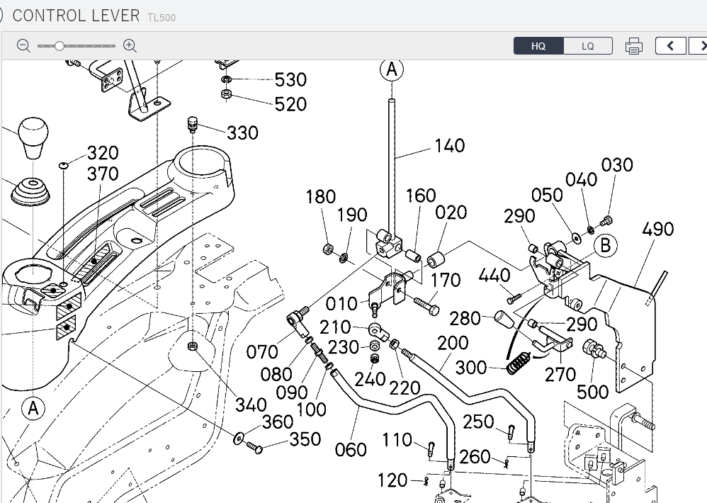

What loader is on your machine? Kubota parts online says TL500. Here is the joystick parts breakdown

#270 in the figure is the lock lever. If that isn't what is causing your issue, post a pic.
