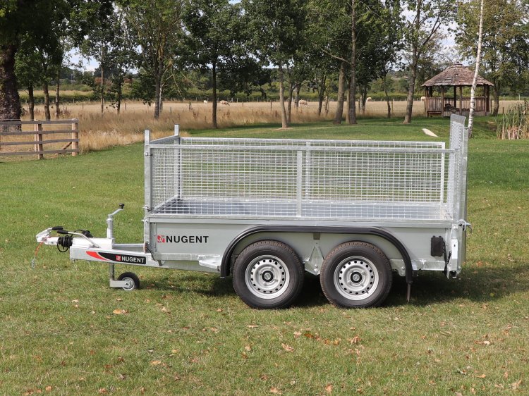

I wanted to see if anyone has had any success fitting a b2410 in a Nugent General Purpose G2512-2 trailer?

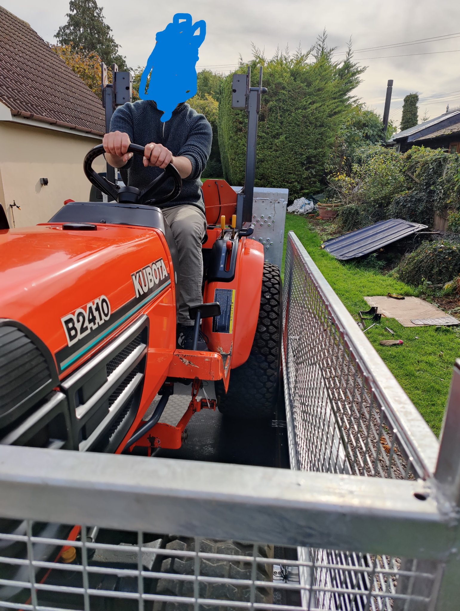

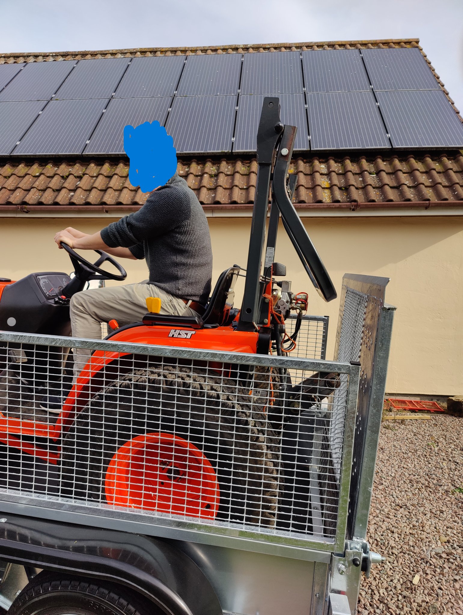

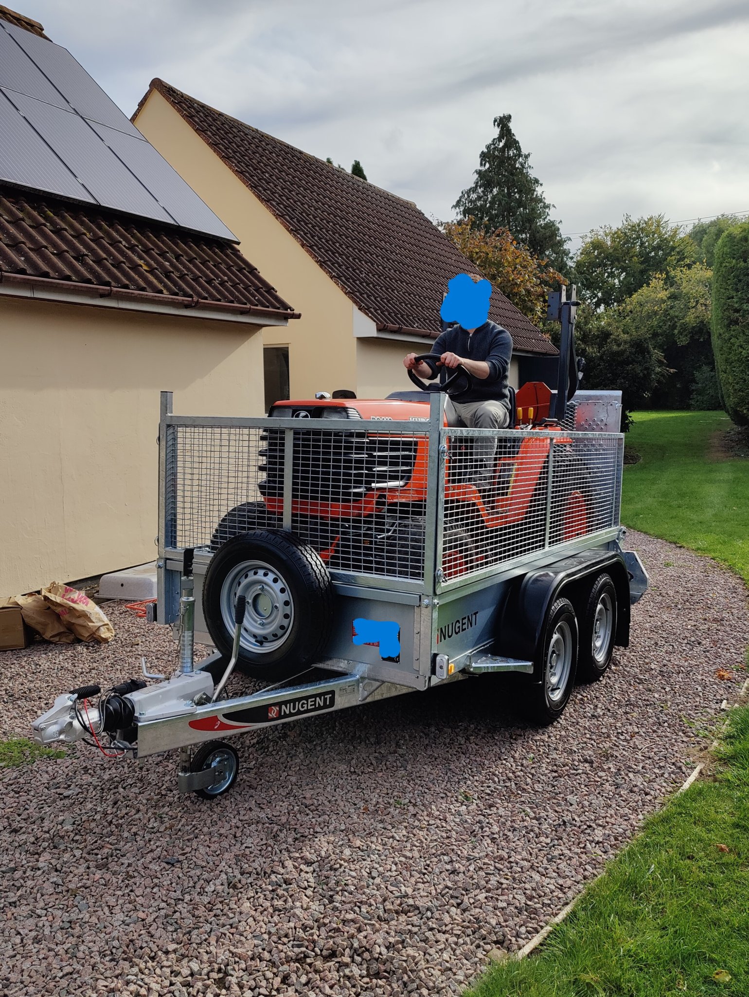

It has a 2000kg (4400lb) rating so weight isn't the issue. The dimensions are very tight but just about work! Plus it gives me a general-purpose trailer, on two axles which is very maneuverable. Overall, quite happy with it!
