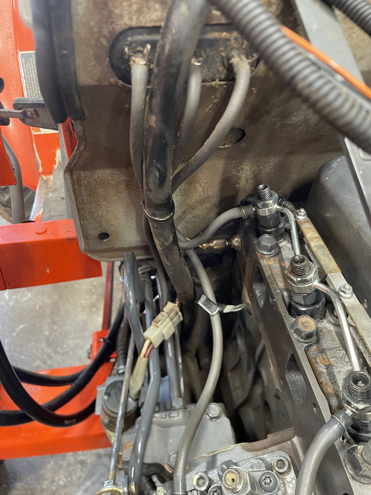

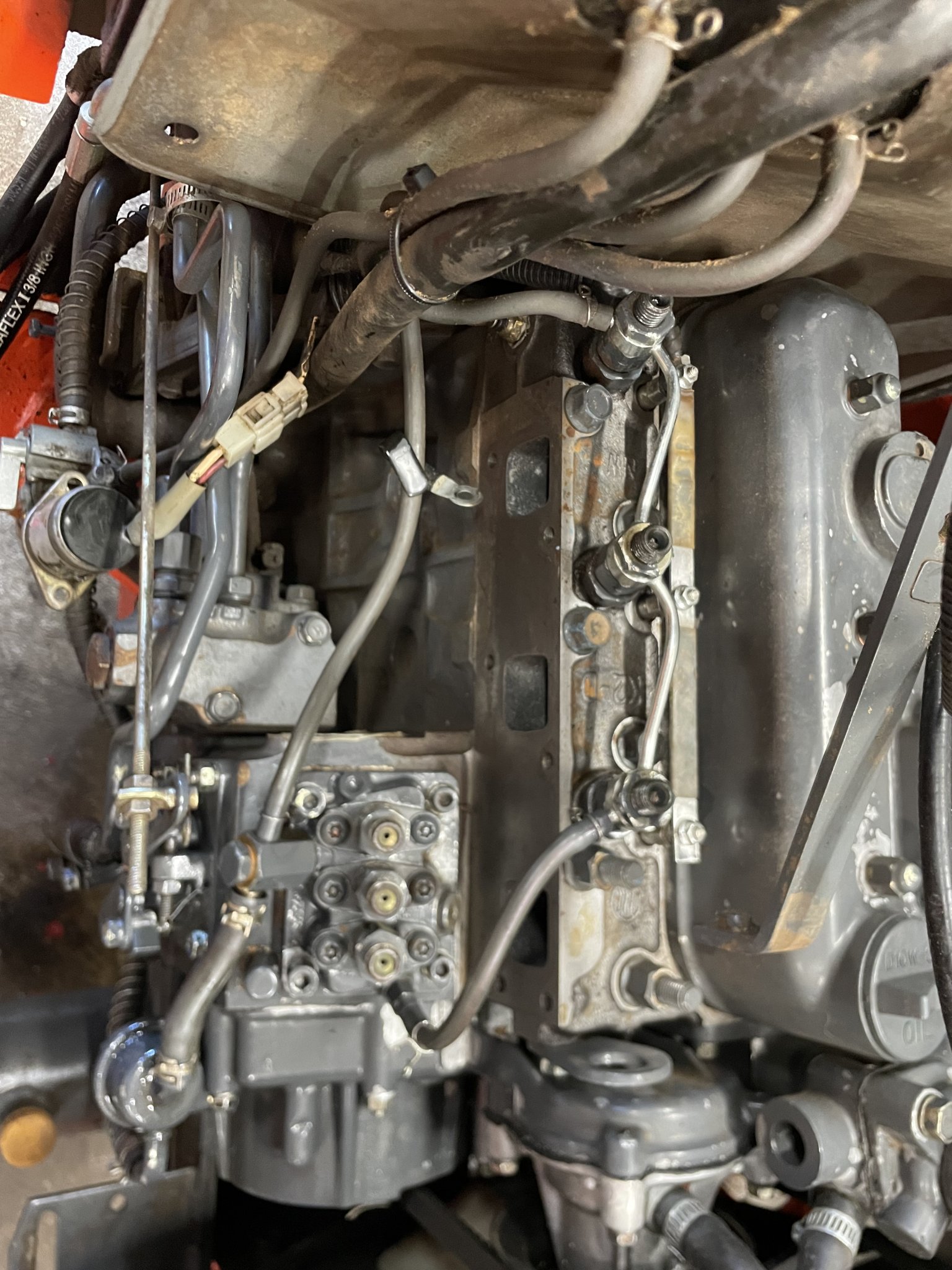

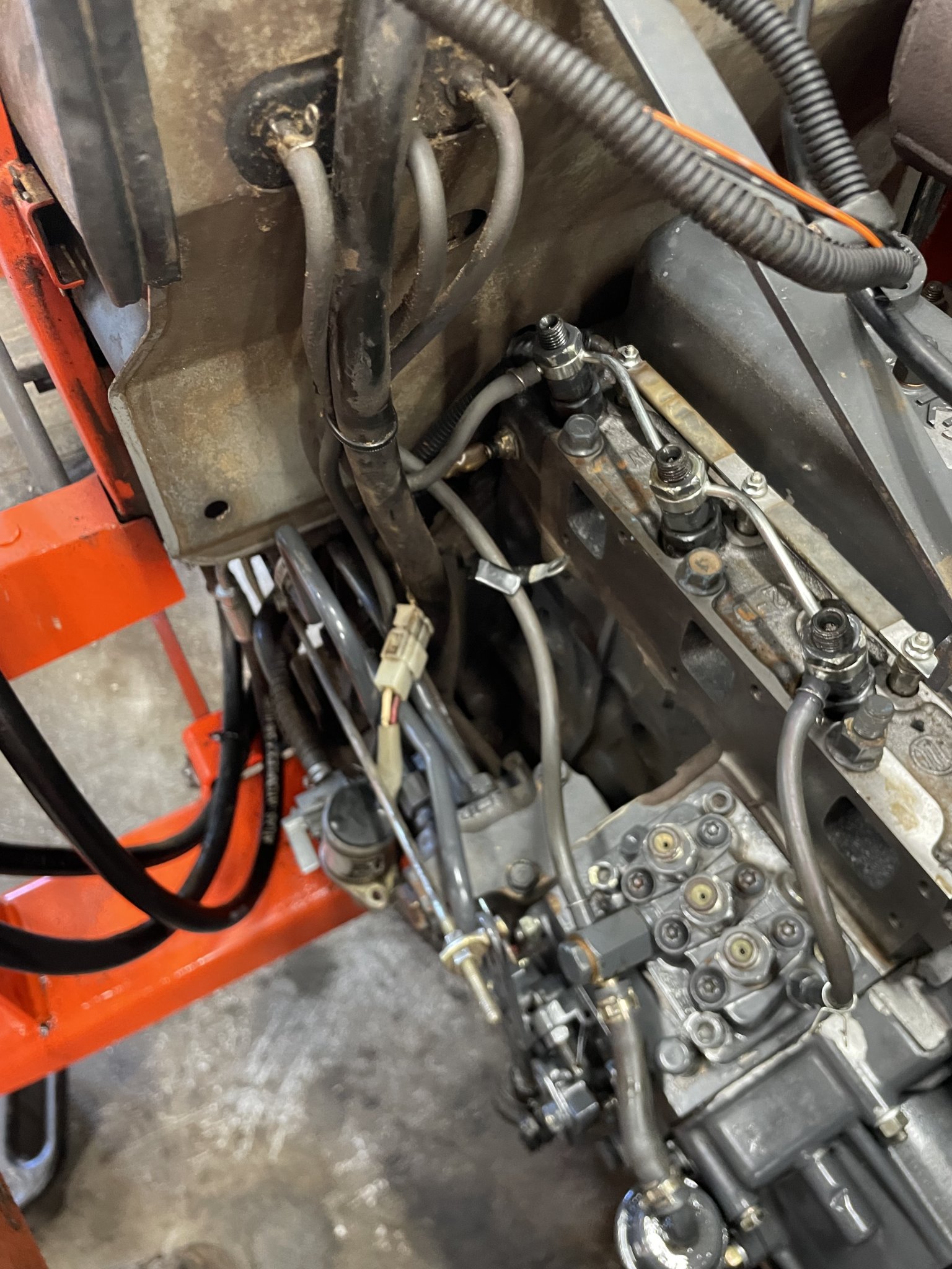

Can you post pics of how the lines are run. Just replumbed fuel system on b2400.
Had to replace the tank and went from 3 return nipples on tank to 2. Another wonderful kubota supersession, had to retrofit.

The return lines are run as such from left to right, looking at the tank from the front of the tractor - fuel filter head, injection pump supply fitting, injector line return.
Going to try to look at this later tonight. Been going crazy with work.
