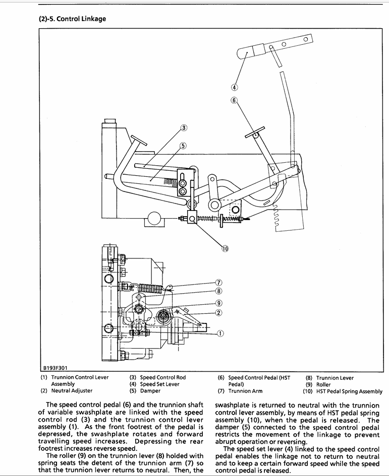

T thomen New member Equipment B2100 Aug 30, 2025 1 0 1 Australia Aug 30, 2025 #1 Hi all I forgot to take photos for this part of my b2100 disassembly.. It's the linkage that sits inside the chassis rail and hangs off the hst.. I was.wondering which way it goes.. the workshop manual has nothing..
whitetiger Moderator Staff member Equipment Kubota tech..BX2370, RCK60, B7100HST, RTV900 w plow, Ford 1100 FWA Nov 20, 2011 3,216 1,640 113 Kansas City, KS Aug 30, 2025 #2 From the WSM,
