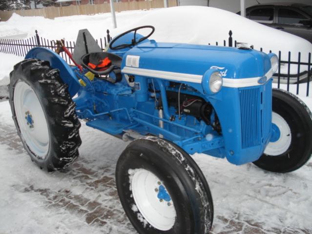

Slip and post a picture of that ole girl! :D Hey if your into restoration there are a lot of Kubota 23 HP and under mowers coming out of the woodwork with the economy the way it is... the bad :( thing is the cost of parts but I see more and more aftermarket parts daily...:)

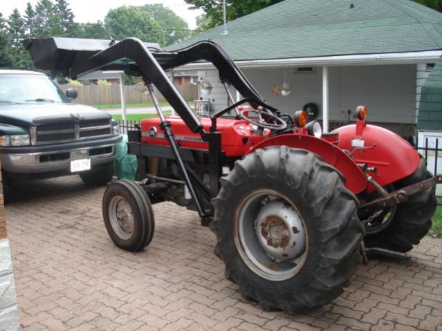

haha you might kill me if your a purist but i painted it blue and white! but everything mechanical was better than new on this machine after i was done with it... she purred like a kitten and theres on of my old massey too... once i get this kubota fixed i might look into an older one not to sure yet i never really look for these things they just seem to drop into my lap!

Beautiful job! Blue is better than Green! HA! Lets go to work on those Orange Ones now and you are what we need helping on this site. :)
