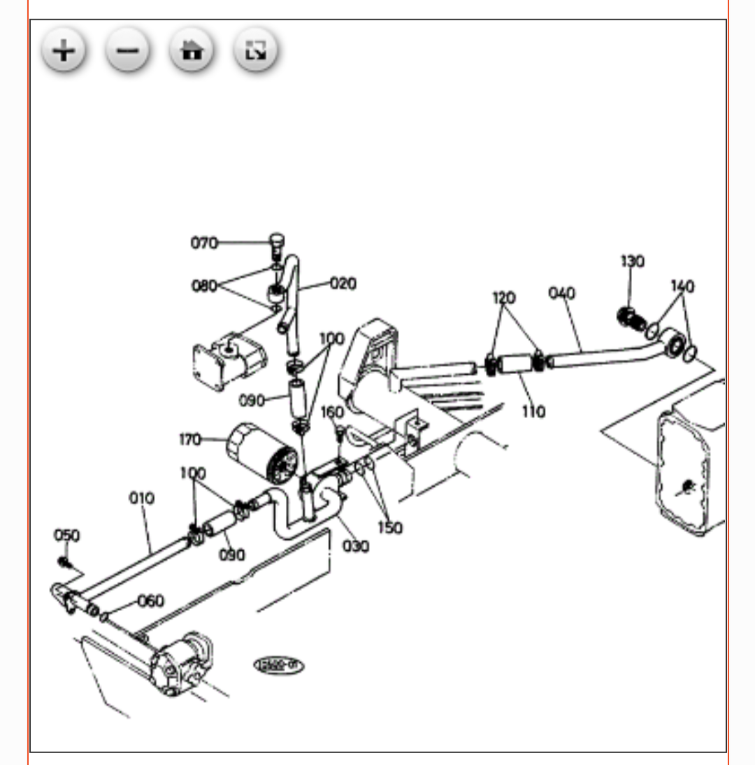

Now, back to your original problem. Are you using Kubota filter? Did you possibly leave the old filter gasket on? Filter adapter 030 cracked? The parts diagram below make it look like the suction line goes through the frame. Is that so? Did it possibly wear through? O-rings 150? I don't think there's a screen behind the banjo bolt 130, but I'd check for obstruction there. BTW, those are copper washers so you may have to replace or anneal them when you re-assemble. You could also have a leak in that side branch off 020 - that may be the return from the cooler.

Filters are kubota not double gasket for sure definitely could be a leak #150 I didn’t even realize were there… further looking into it is needed. I’m wondering what the best method to smoke test it might be check everything including the cooler for possible leaks

I'm not familiar with your model and don't have a WSM available, just parts diagrams, so my help is limited. Looking at them again, it appears there's a third pump. That's a separate charge pump to the hydro. It appears to take suction after the filter on the right side, then through the oil cooler, so any leak in the cooler or those lines could let air in. These pumps have o-ring shaft seals that could leak. I don't know of a pressure or vacuum test method. You might be able to isolate sections and put a little air pressure on them.
