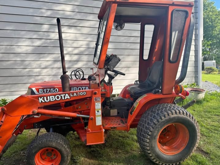

Posted locally to me ( new england) is a b1750 with 900 hours and a la300 loader. No known issues .. value ?? Its posted for $8500. Just had a 2000 dollar service with 2 new front turf tires.
Are these b1750 hst nice tractors?
And how much does the loader pick up weight wise? And what does this b1750 with loader weigh ?

I own a B1750HST bought new in 1994. It has an excellent 60" MMM with little used grass catcher but no FEL. It has proven to be the best major purchase of my life. Aside from excellent care, maintenance, and tubes in the front tires it has needed nothing in the past 32 years. I do keep it inside and avoid abuse. Obviously, I consider mine (at least) to be a great tractor.
These were available with both HST and gear type transmissions and valuation will depend upon transmission type as well as the other usual factors. 900 hours is quite low for a 30+ year old tractor. FWIW: Mine has about 675 hours and I would not sell it for $8,500.
Turf tires on front. Does it have turf tires on the rear? Gearing will be wrong if it has R2 or R4 rear tires.
Cannot provide accurate specs at this time as mine along with all documentation is currently in storage during a relocation.
The fact that I sold my 4 other Kubotas before relocation but decided to bring the 1750 with me should say something.

Tractor has HST i just added that to first post I forgot to mention the hst.
Tractor has 4 turf tires. What do you mean r2 r4 Tire? Sorry im a newbie tractor guy. I can turn a wrench tho.
I will add a photo to original post. It also has a cab with doors and heat.
6,139
1,879
Does it have a mower or do you need a mower? The original MidMount Mower will be nearly impossible to get, but you can buy rear mount mowers of various types.
R1 are agricultural tires (narrow with high lugs for traction)
R2= I don’t recall but maybe rice tires which are R1 with higher lugs)
R3 are the turf tires you have
R4 are industrial tires that are on true Tractor Loader Backhoes used by construction companies
R14 are newer style that is a combination of R1 and R4 tires
Most styles have specific rims that they fit so you can’t put R1 tires on R3 rims. R14 are somewhat more flexible on rim style (I think)

Aside from the FEL and cab, it looks much like mine and looks to have been well cared for.
It also appears to have the Bi-Speed Turn option, as does mine. This option is useful for mowing as it provides for tighter turns. It should always be turned off except when mowing, and especially when using the FEL, as failure to do so will wear out the Bi-Speed Turn torque limiting clutch.

Thanks for tire info. And it does not come with a belly mower.. what does the b1750 have a specific belly mower for it? Other kubota belly mowers wont work on it? And yes lots of options for 3pt mowers worst case.
They were sold with excellent 54" and 60" proper, terrain following mid-mount decks.
Finding a used one would likely be difficult.

To calculate the approximate FEL lifting, multiply the model by 2.2
Tractor Gal
Tractor Gal
BX23D MLB
Oct 30, 2020
581
225
NC
Loader model la300 x 2.2 = 660 pounds lift?
Notice the word "approximate." It's a way to have an idea of the weight load without having to go to the manual which says:
LA300 Loader
600 lbs lift (full at pin)
272 kg
