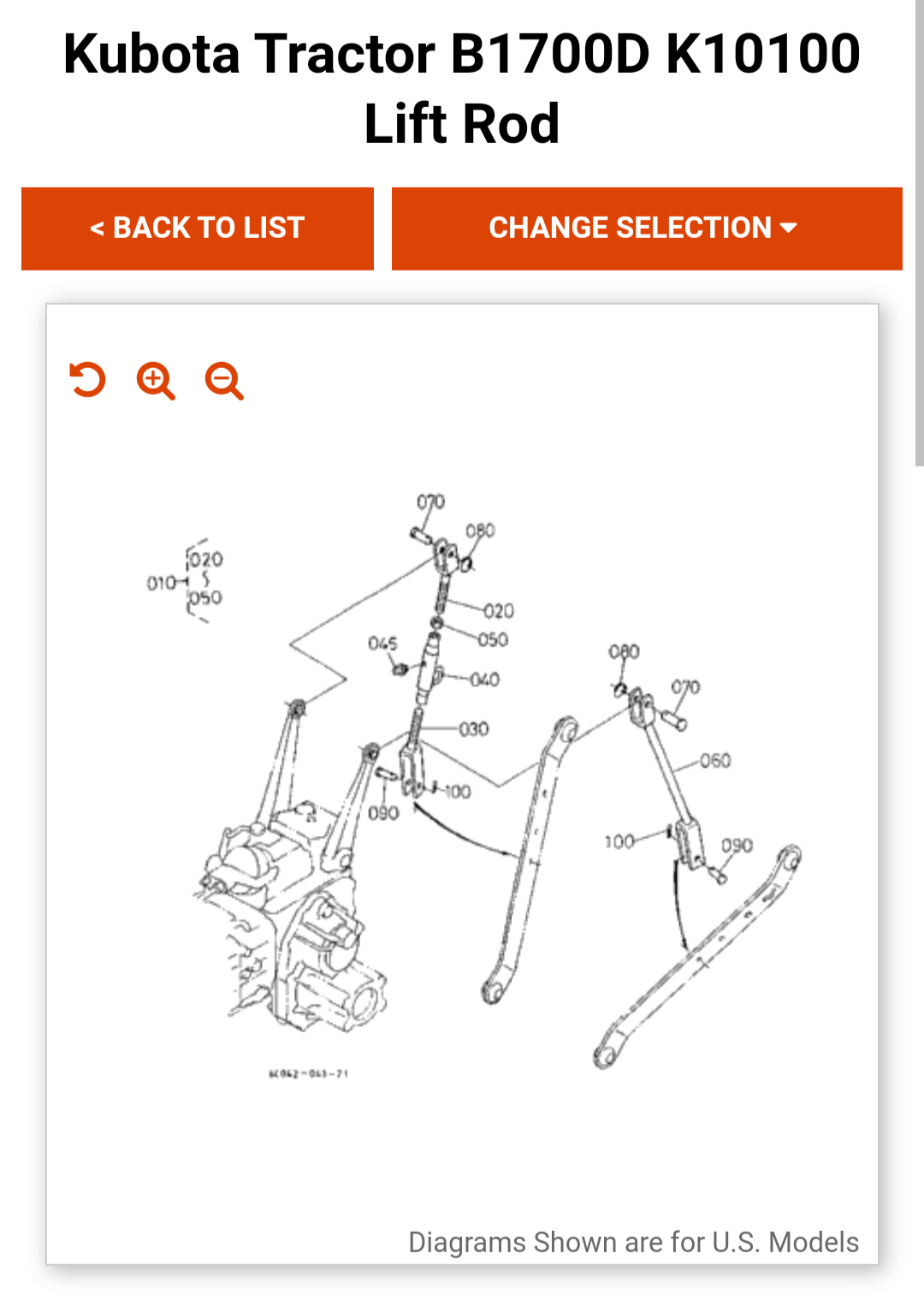

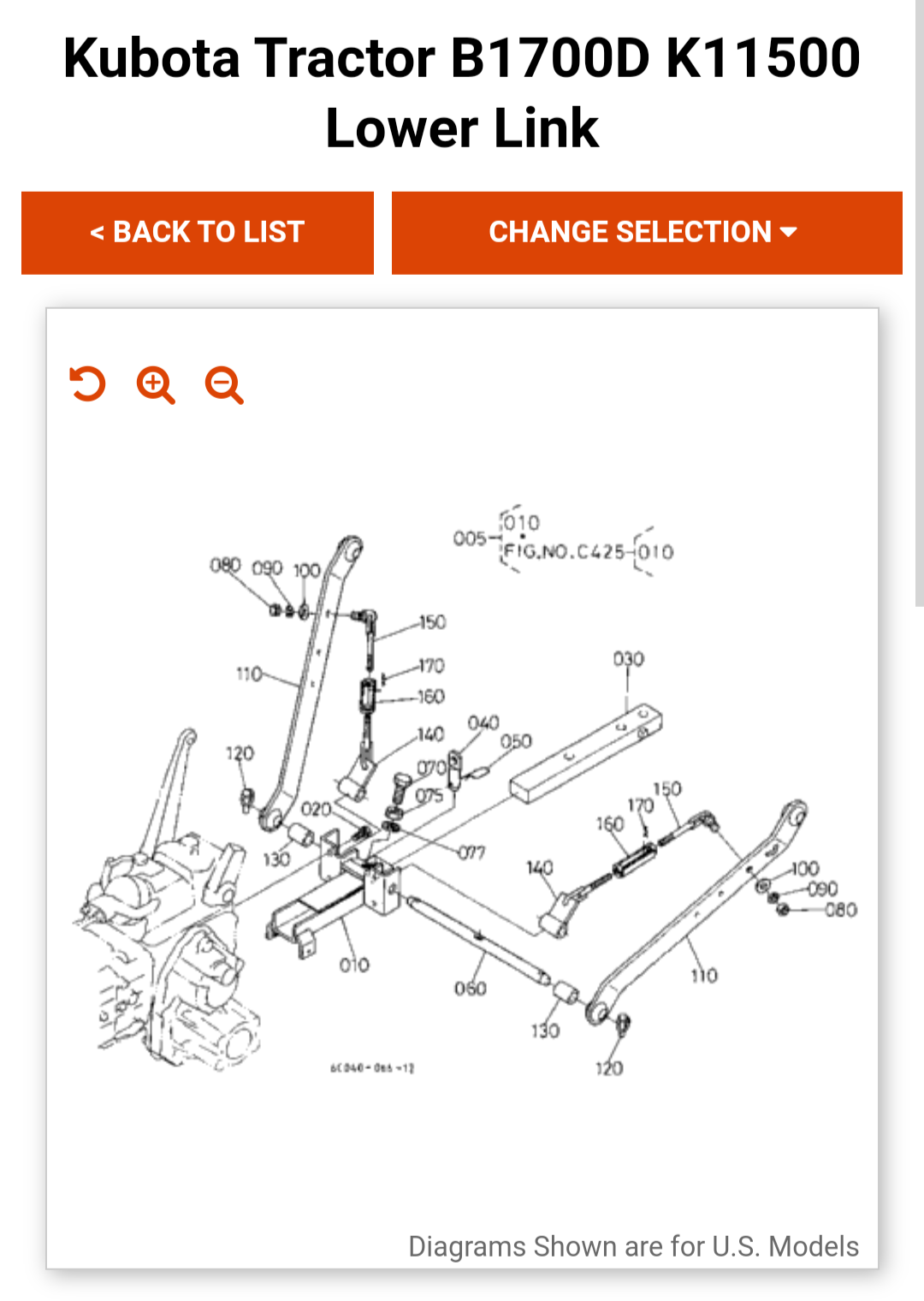

6. Here are some diagrams of the hitch on a B1700, which may be similar to yours.
Rod 060 slides through a bracket, which I think is already on your tractor. Based on a recent post, you may have to remove a wheel to install this rod. Then the stabilizer bracket 140, spacer 130, and lower arm 110 slide on each end, secured with a pin.
The lift rods are pinned to the lower arms and upper arms. The right-side arm is adjustable to allow for leveling or tilting the implement.
The top link is pinned to the bracket on your tractor and to the implement. Its length is adjustable to make the angle of your plow what you need.
