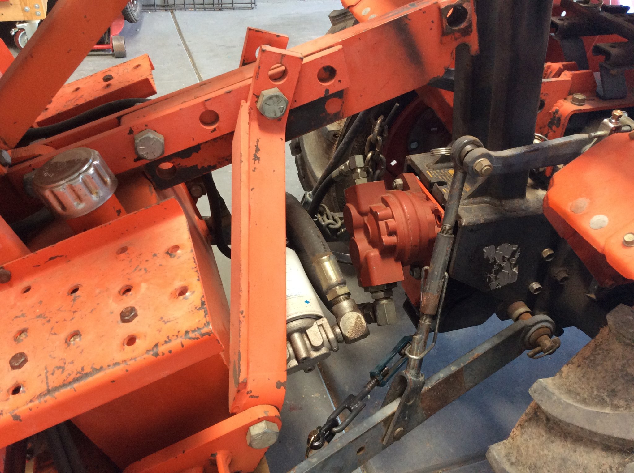

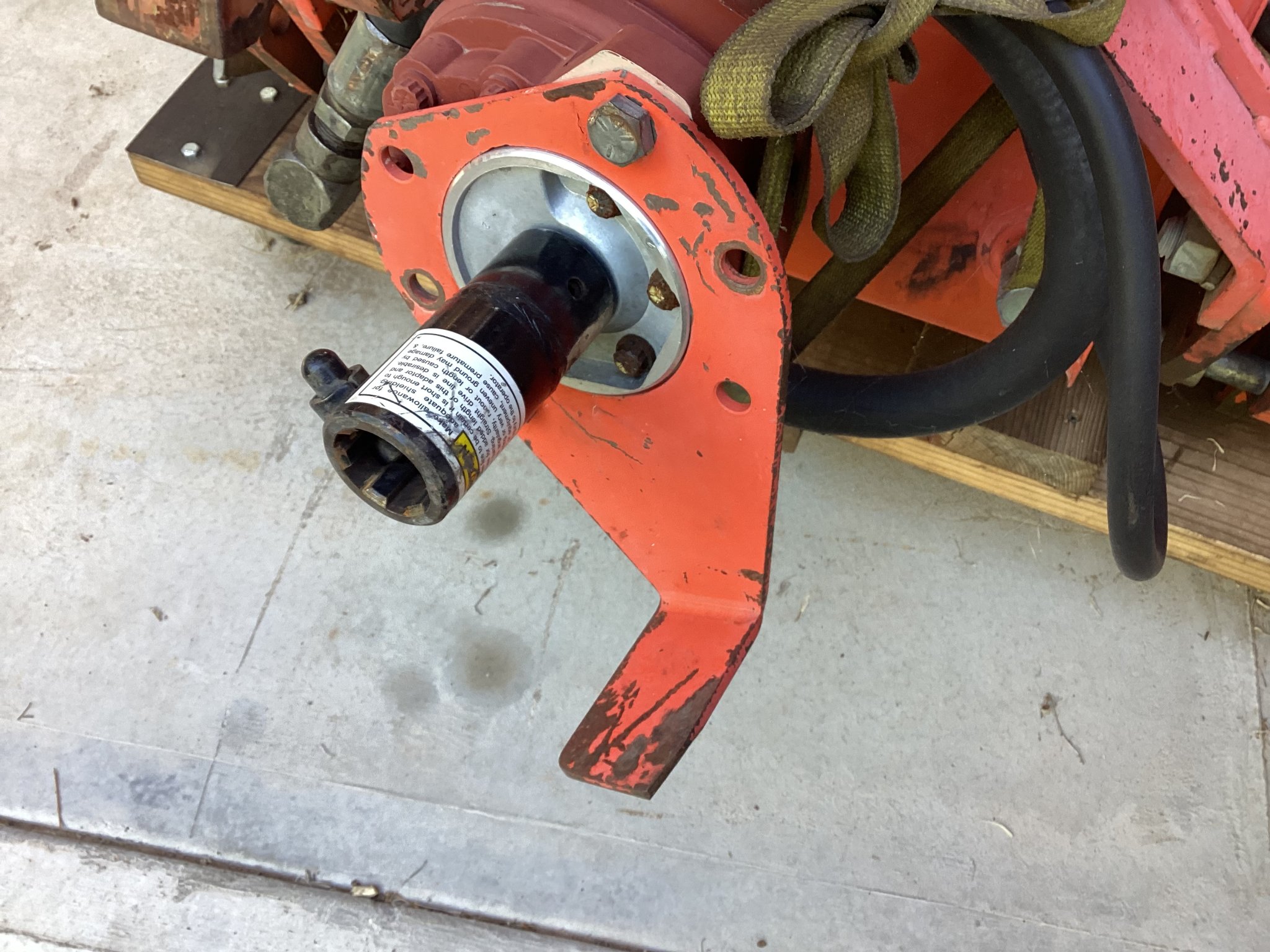

I finally got all the parts and subframe mounted for my B8200. I mounted the Cessna pump but cannot figure out where the anti rotation bracket bolts to the tractor. Can anyone lend a picture of their setup ?
Thank you!

I don’t have a good photo but I can say that mine just bolts to the pump not the tractor. Connect the PTO and the bracket is captured by the PTO shield to keep the pump from rotating. I’ll snap a photo of it in the morning.

I have a 3PH backhoe with no subframe, but it dose have a PTO pump with a anti-rotation bracket, and in my case the bracket slips in the draw bar slot I believe...
