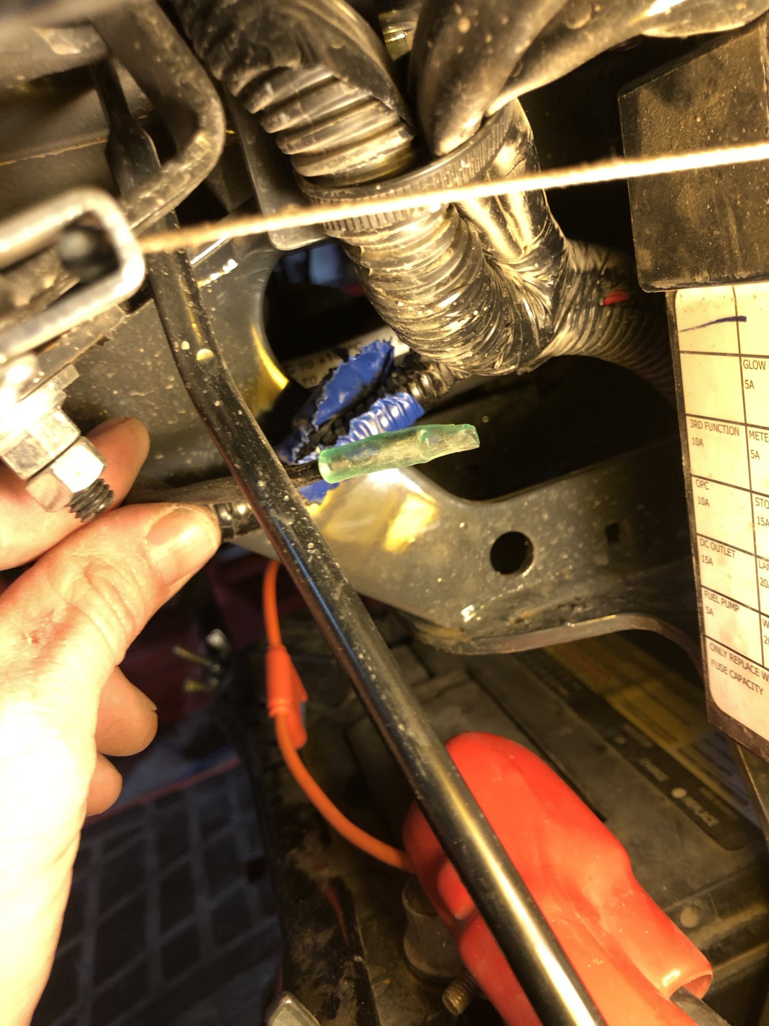

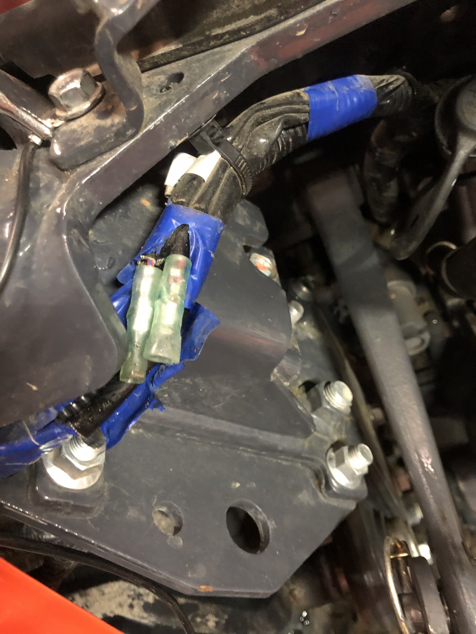

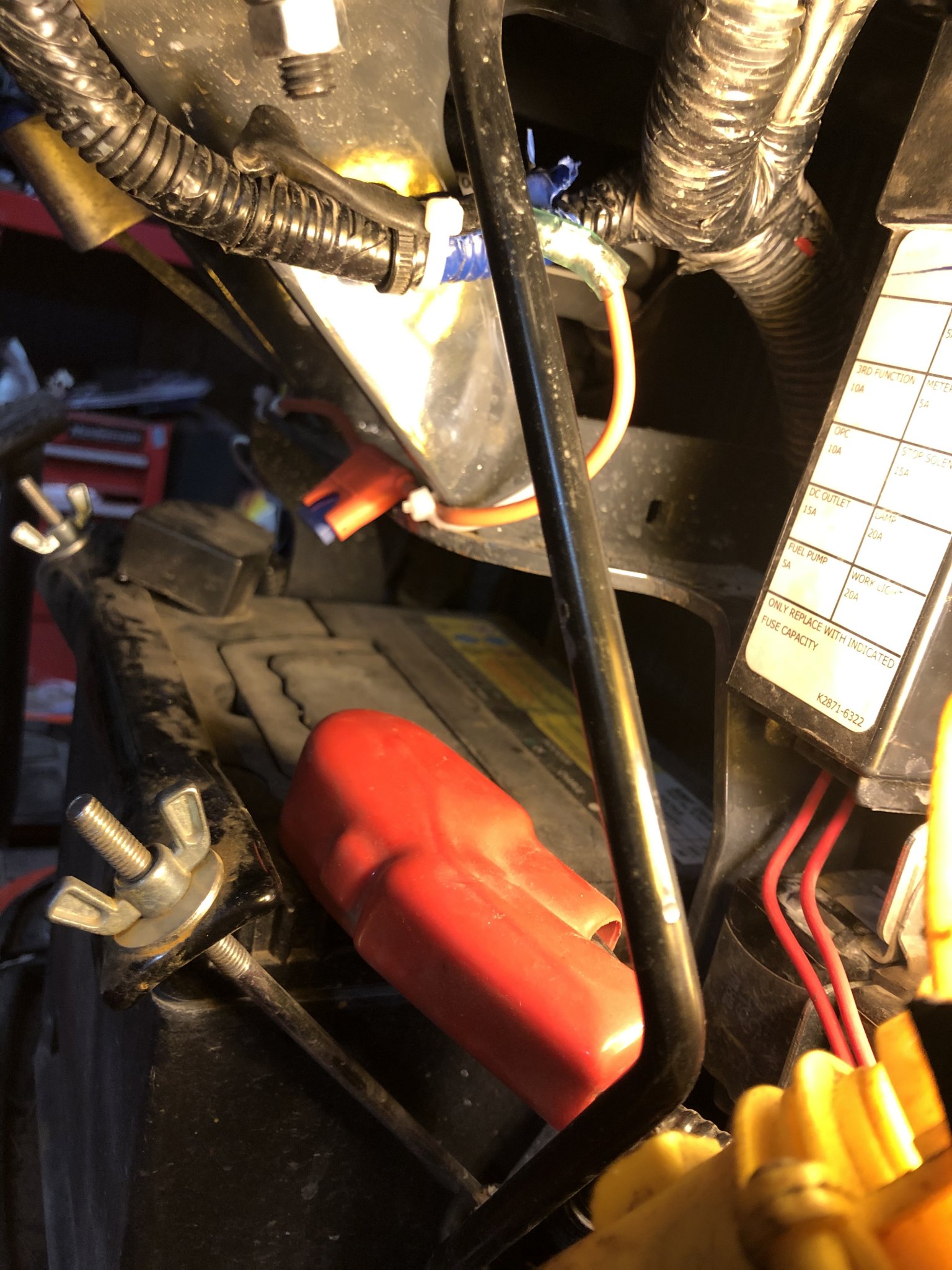

Hope someone finds this helpful. I wish everything manufactured could have this. i wired up some rops lights, and just went direct to the battery as I didn’t have a fuse terminal at the time. Had a service call for an issue with my 3 pt and the tech showed me where to find some power that’s already built into the harness, not sure what year they started doing this but it’s pretty sweet. This is my bx23s. Under the dash there is blue tape hiding a connector for key on power, so I ran my relay for my lights to it now they only turn on with the key, on the back of the machine there are 2 more, 1 is battery power and 1 is key on power. tech said just look around the harness on a kubota. Find blue tape and you have power for accessories.
pics, cause this is useless without them.
rear location under the frame on the left side
under the dash by the fuse block
my new key on power to my relay
