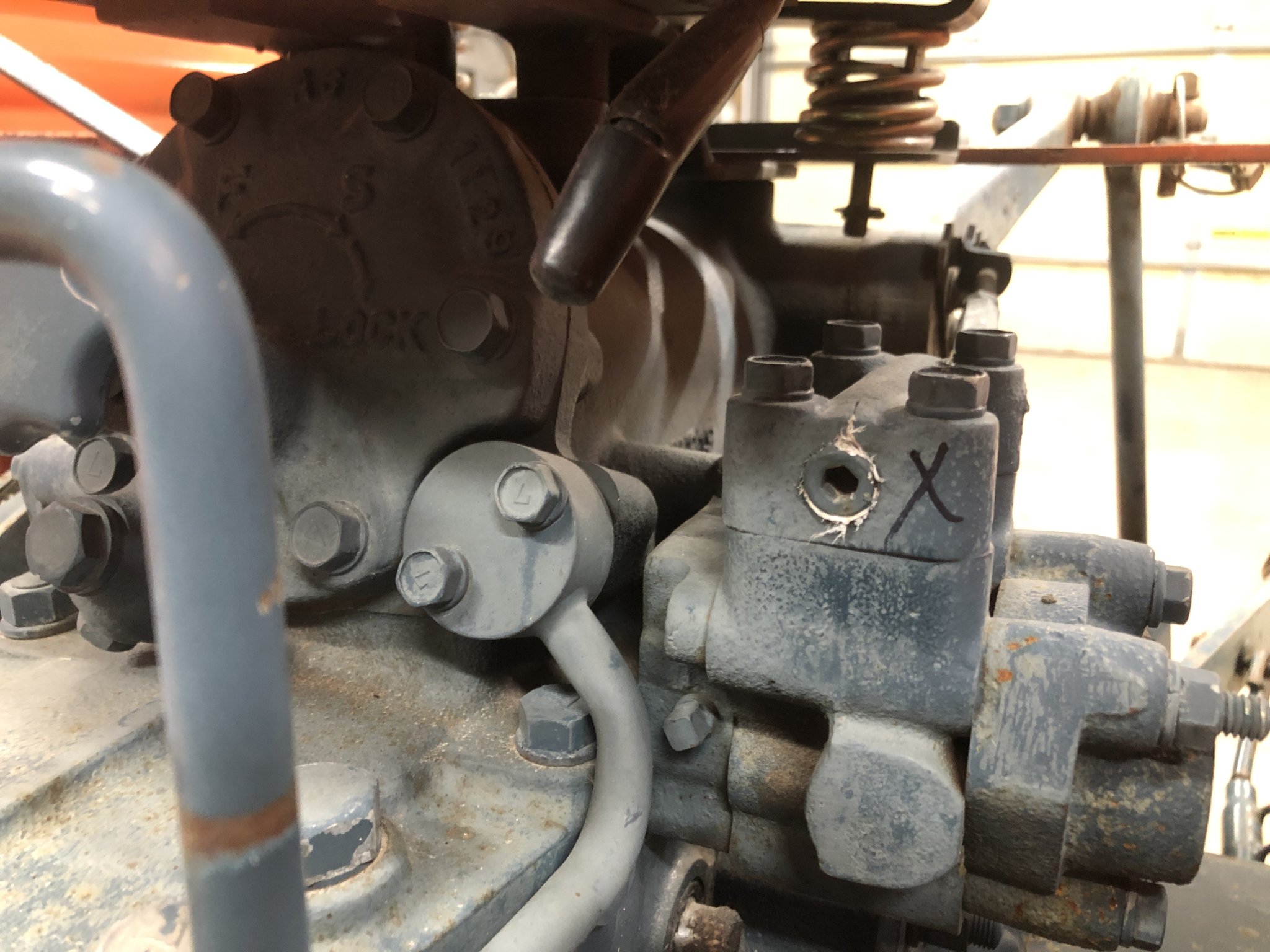

I have a L235 that I'd like to add aux. hydraulics to lift a dump wagon or maybe a hydraulic top link for the 3 point. I've had several Kubota tractors over the years (B7100, L2900) and both of those came with a block with threaded ports, blocked by bolts. All you had to do to add aux. was remove the bolts, turn a valve, and install the right quick connects. The manual for the L235 indicates that yes, you can add aux. hydraulics, but it appears that you have to find a block to attach to the hydraulic flange outlet. I found an old post with a picture of what I need. Does anyone have that part number or a lead on where to find one? I'll try to post a picture of the part I'm looking for. thanks

That one is not easily found. What is currently in that spot on your tractor. A picture would be nice.
Edit: I looked at the operators manual. That block uses teh same pattern as a bunch of other machines. The blocks used on them can probably be made to work on your tractor and I can supply one:

thanks for the reply. The first attachment is what I've got now. Looks to me like you take the four bolts out of the block with the "x" and you end up with what is shown on the lower portion of the picture from the manual. I assume the block I need would replace the shorter "x" block and give me two threaded ports.

See my previous post - I have you covered.
