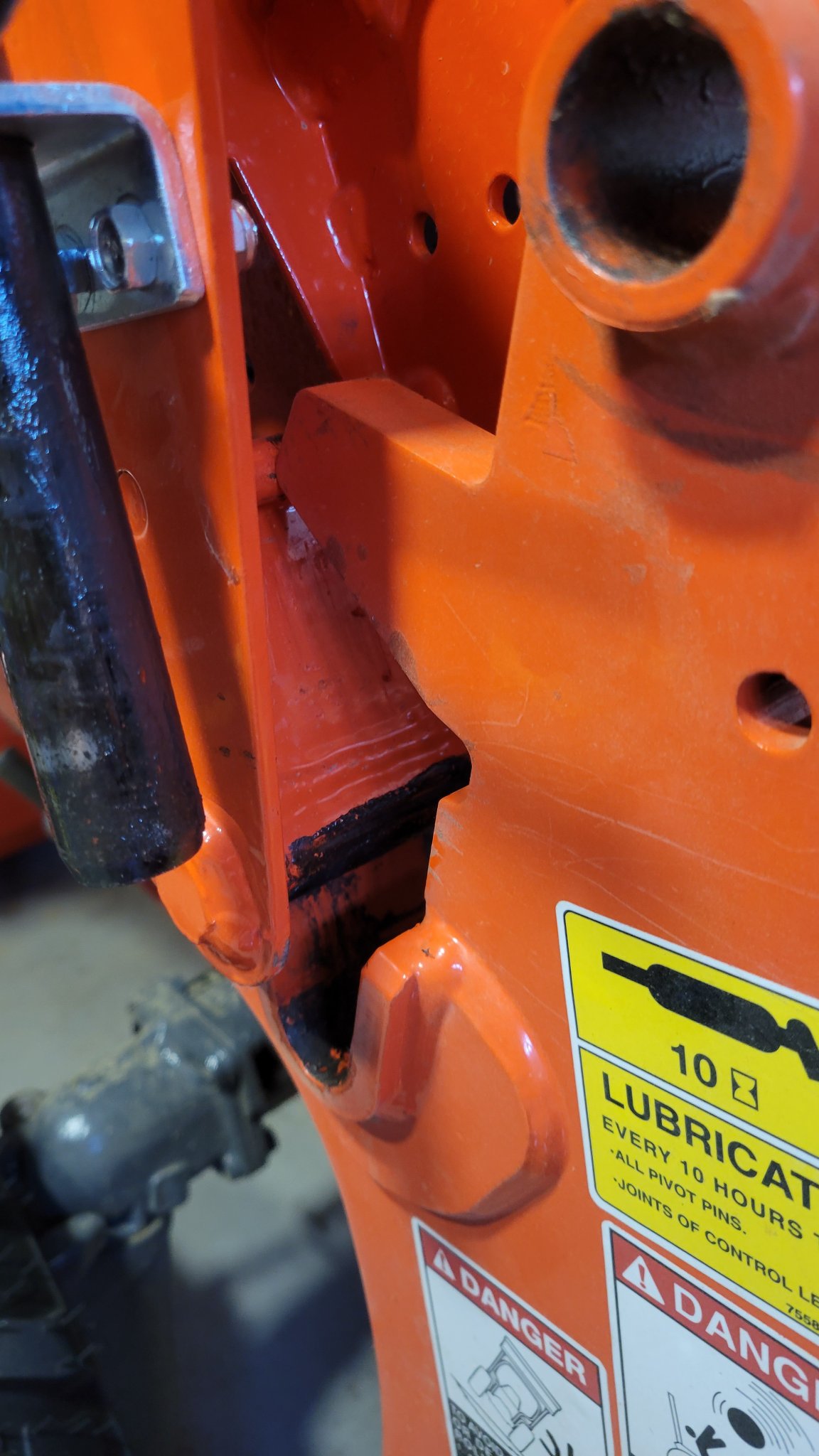

I know many of you never remove your loaders but for those who do, and also have a toothbar, do you need to remove the toothbar to reattach the loader? For the life of me, I can't get it to drop into the bracket with the toothbar on. Both the tractor and loader are in my garage with a concrete floor where I have attached the loader prior to the toothbar without a problem.

Only thing I can think of is the geometry change. Without it the loader used to align properly when dumping the bucket and drop into the bracket. Now at the point where it used to drop in it comes close but doesn't seat and then dumping the bucket further lifts the loader out of the bracket.

In the picture it looks like the bracket on the FEL needs to rotate a bit more. Try moving the joystick as though you are raising the bucket and I'll bet it drops in.
9,962
6,716
I agree with Chim....try a very slight pull on the 'stick....
The TB has extended your cutting edge a couple/few inches. I think you have your FEL on/off quite often. Just wondering if you need to adjust for that, and maybe not extend the curl cylinder as much, as you've rocked the rear mount enough to have to compensate for it....if that makes any sense..o_O :unsure: :geek:

Thank you all for the suggestions. I did what @chim recommended and I'm back in business. I owe you a drink buddy!

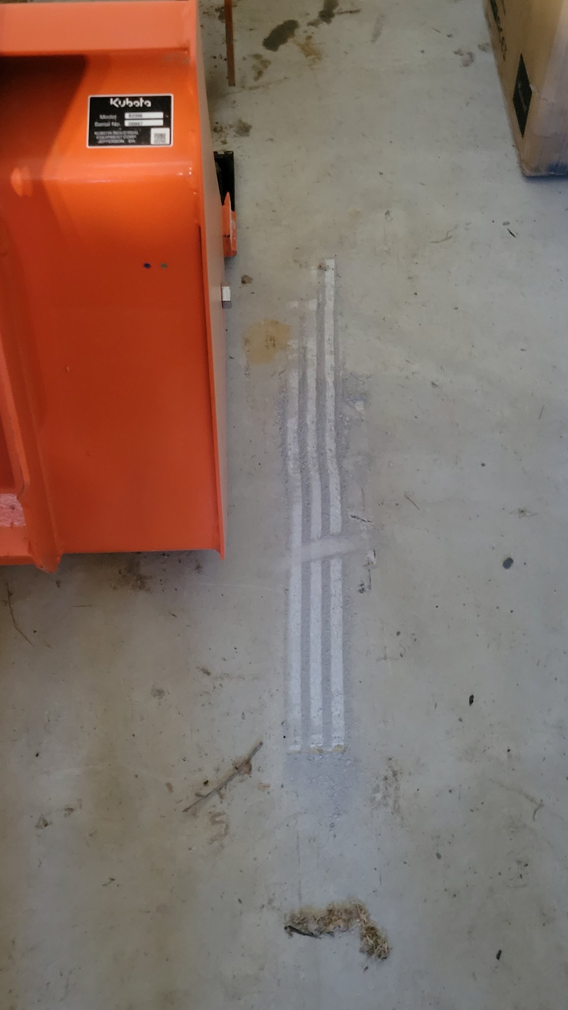

I have same tractor, loader and toothbar. It is doable without any additional plywood etc, you just have to learn the different angles for the dump and not care if you scar the concrete a little with the bar teeth. All the best!
je1279
LX2610 w/ 60" MMM, LP 72" Snow Plow, EA Wicked 55" Grapple, and Woods 60" BB
Dec 6, 2020
828
581
Upstate NY
Lol like this?
