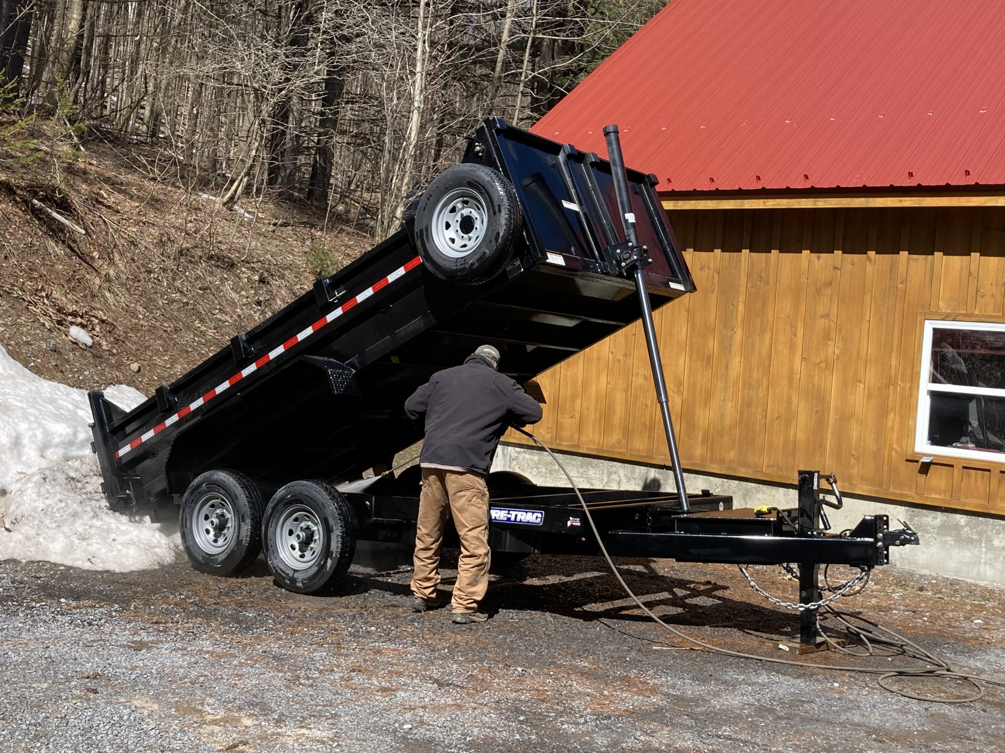

Got it home after a 2" snow event here in the North Country and NYS putting down 1/2 million tons of Salt, Sand and Brine on every road I was on.
A quick Pressure wash was needed. Very happy with it the way it tow's so far.
Working on the sideboards and head rail materials and getting them weather protected.

Nice!
Dump trailers are so useful. My 16ft PJ has 2ft sides and I bought the optional 2ft expanded steel side extensions which work great when picking up firewood. It worked well for the BX25 too. I'm hoping that the roads are free of snow, ice and salt in late April or early May when I pick up the new Kaufman gooseneck.

Tom - - I have a buddy with one similar. Got it shortly after he got a subcompact MF TLB.
He was doing a lot of driveway and drainage work around his house.
He could make a couple trips to one of the local gravel pits and dump before work.
Said it was one of his best investments. Made life a lot simpler/quicker....
Looks great - - - best wishes with it.

Uhh, I really want a dump trailer! I've had my buddies at my house the past 5 weeks while he does some work on our basement, so handy.
I really like the placement of the ram on the Sure-Trac. I've gotten a little aggressive with weight on my buddies that has a single, non sissor ram towards the back third of the box. It will try to lift the back of the dump body before it lifts the front to dump.

That is a nice looking barn!
Most manufacturers offer the "telescopic" ram. There are pros and cons of each. IMHO, the single ram non scissor is the lowest grade option.

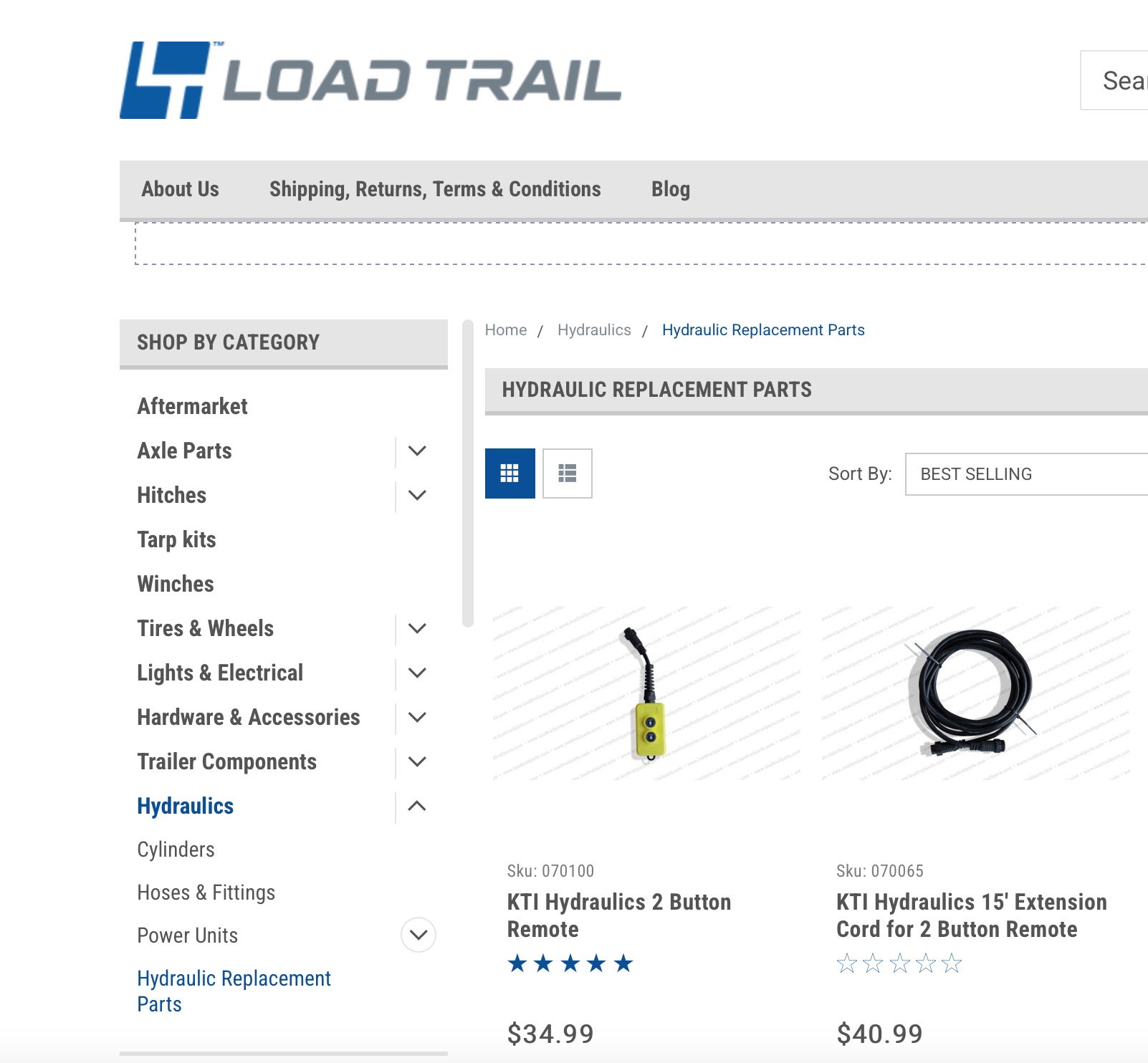

My LoadTrail came with a long lead switch box that can be operated from the cab of the truck.
I have those extension cords and remotes on all three PJ trailers, but with a big and long F-250/F-450 I have to add an additional extension. In addition, it's awkward and messy dragging the remote up to the cab, passing it through the window etc. When I head to the local dump, it's pretty nasty in the summer months with dust, wasps, stench etc., so if I could have the windows closed and A/C on I'd be a lot happier.

PJ does offer the telescopic with some models. I have seen them while shopping.
For in cab controls using the upfitters, I'm thinking of using a secondary cable. Not through the lighting harness. Part of the reason is safety. I could see myself inadvertently hitting the switch when picking up my coffee cup. Using a 2nd cable, I can leave it disconnected until I get out to open the trailer doors.
Good point! I'm ok with adding another receptacle to both trucks that would allow me to plug the extension from the hydraulic pumps directly into the truck and then into a cab mounted switch. Heck, I could even buy a 15ft extension as shown above and wire it to a switch in the cab, and leave the end tucked out of the way to make a direct connection to the extension from the pumps.
