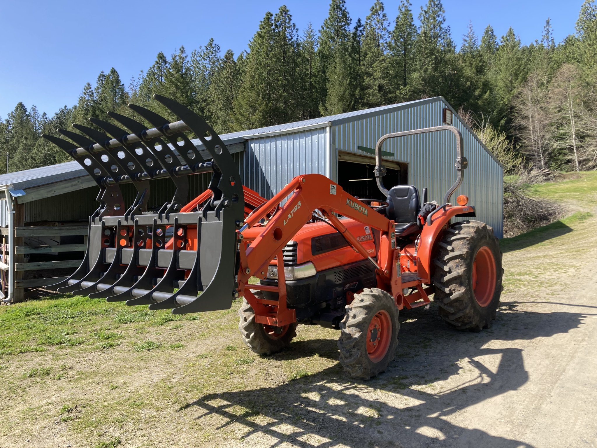

Thanks! Which version of CID did you get (Standard, Heavy Duty, etc.)? Also, probably a different thread but how did you decide to get the clam shell type vs the flat bottom type?

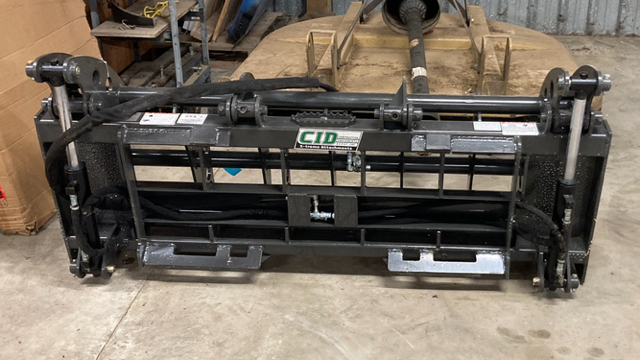

I got the standard duty, here's the spec sheet (or as close as CID comes to having available as a spec sheet).
I went with the clam shell style for handling brush from trimming Douglas Fir trees as well as winter deadfall. I don’t have a need to sieve rocks so I didn’t need that style. I really wanted a Land Pride SGC1060 unit (same style) but I wasn’t will to pay an easy two or three grand more for it. I did some window shopping with online specs, diagrams and photos as well as reading on the net what other grappler owners thought and their applications. Plus a friend of mine had the LP unit I wanted and did the same type of work I plan to with it. And I have another friend that does forestry commercially with a skid steer and he used the same style of grapple. Then I looked at the various grapples in person to the extent I could (which included CDI and LP as well as about 3 Chinese units). It’s also the style most forestry operators use here in the PNW.

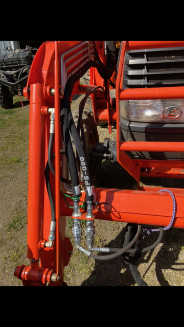

Do you have a picture of how / where the hydraulic lines are being routed out of your grapple? Mine are coming out of the wrong side so I need to modify things but was thinking maybe to being them out of the middle of the grapple.
Thanks!

Sure. Here you go. The lines on the grapple exit on the left side. I set up my 3rd function on the right side of the FEL. The hydraulic hoses are plenty long to connect to the 3rd function on my application. I have to use a bungee cord to manage the excess line.
The n my grapple, it looks like I could reroute the lines to exit to the right if I wanted.
Good Luck
