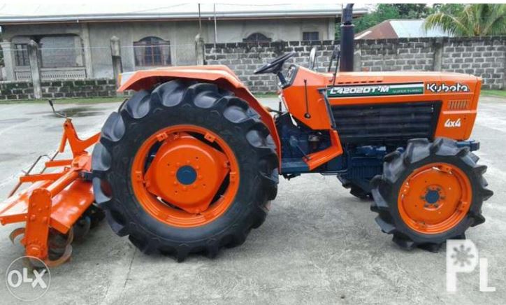

Interestingly, Daedong collaborated with Kubota for the L--02 series, and besides the transmission, also contributed the sheet metal design which you must admit, is somewhat unique for Kubotas:
From the side, it looks rather progressive for the late 1970s, early 1980s! I'm not going to show the front view. Butt ugly. [This one's for sale in the Philippines for about $10,000.] Gorgeous tractor!
Eventually, Daedong went on to market Kioti tractors, with some friction between them and Kubota over patent infringement in there...
