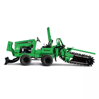

Your rental options do not include a ride-on-trencher with back fill blade (you said you have rented an excavator in the past)?
I rented a tracked trencher to cut a 180 foot trench in clay filled with rocks, and it was unstoppable and fast. Even with the hour plus round trip drive, I had it back in less than the 1/2 day time.
Appreciate the link. I've rented both depending on the application. Latest project was a 24" trench so the excavator was the only way. My mistake was not making sure that the excavators blade could pivot so backfilling took forever because I had to use the bucket. Otherwise, for narrower trenches you can't beat the ride on trencher.
