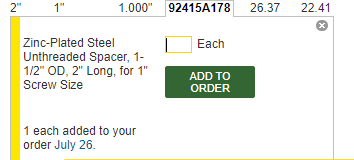

Wow didn't know about that place. They do have everything. Size is 1 1/2" OD 1" ID and 2 1/4" long. So thinking probably this. They do have stainless too but not sure how that would weld?

Welding on galvanized material gives off fumes that in excess cause health issues, so it might be better not to use galvanized material. Weldor will grind it off in the area of the weld, but that will take more time and probably cost you more.
Standard uncoated steel should be fine in that application, especially if painted.

You can weld stainless steel to mild steel, it actually welds quite nicely! But it is not stainless steel anymore after you weld it so why spend the extra money?
6,334
3,685
When welding galvanized steel it’s best to grind/scrape away the zinc in the area to be welded, mostly for the ability to insure good penetration but also to avoid the fumes associated with “metal fume fever” …. a short-term flu-like sickness if you breathe the fumes. If you weld galvanized steel do not hover over the weldment and keep your head in clear air to avoid the fumes. (It’s temporary illness and goes away in a couple days.). Hopefully everyone who welds avoids the fumes of ALL welding operations…NONE of it is good for you.
If you grind-away the zinc then you can use ”cold galvanize” paint (Rustoleum is my favorite) to re-coat the area after welding and wire-brushing the flux off.
Better yet….use plain steel and then paint it with Rustoleum.
