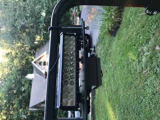

I've been checking posts and doing a lot of thinking about how/what to do about mounting some off road lights to my B2650. I think I copied a little something off several folks out there and I thank everyone who has posted their setups. While shopping at the mega hardware store my wife saw the waterproof switchbox and we came up with this idea. Two switches, one forward and one rear. By mounting them right up there on my mounting bracket I avoided putting holes on the dash, and was able to use the hot leads provided on the tractor. There are 15 holes in the mounting plate! And I chamfered each one to help eliminate rough edges. Still have to neaten up the wires and hit some of the shrink wrap with the heat gun but so far I'm satisfied with the result. And 7200 lumens should brighten things up when the sun beats me to bed! George
