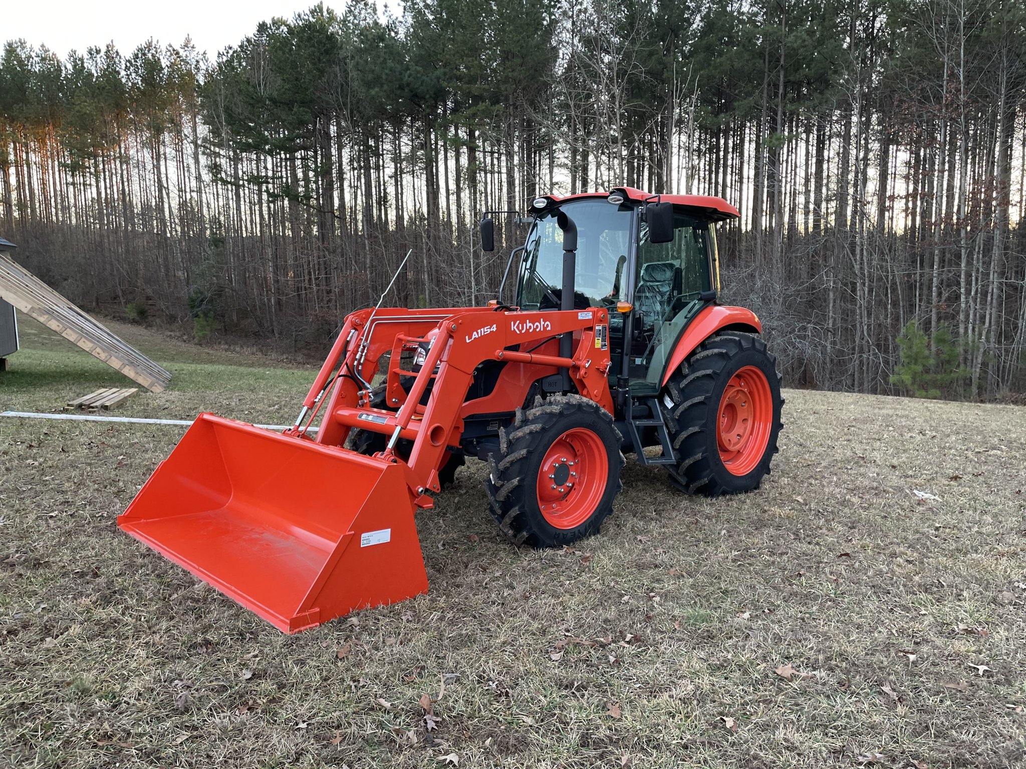

Just wanted to get everyone an update and thank you all for your input. Ended up crying once and went with an M7060 with the 12speed. Dealer gave me a great deal I felt like from shopping around as it had been on the lot a bit. Wasn’t long after the tractor I quickly started amassing attachments for specific jobs and little to no marriage fallout 🤣

Congratulations !
Where’s the pics of the beast?
What attachments did you splurge for?

Great decision. You must be super happy. Hydraulic front post hole digger must have cost a bit. Does the M have enough flow to drive it well (I know, of course the answer is yes.......)

Oh my. That’s awesome! I bet a person could take a nap in that cab if they needed too…I know I would.

Thanks everyone. So far really enjoying it! Yes the front hydraulic post hole digger was a bit expensive. But I liked that you can mount the head center or on the right side. Then drive down a fence line. In terms of flow yes. If I recall going with the 12 speed increased the flow quite a bit and put the attachment well within the usable range.

How much did that beast cost you? Ballpark figure is fine. I can only dream of having a tractor like that.
