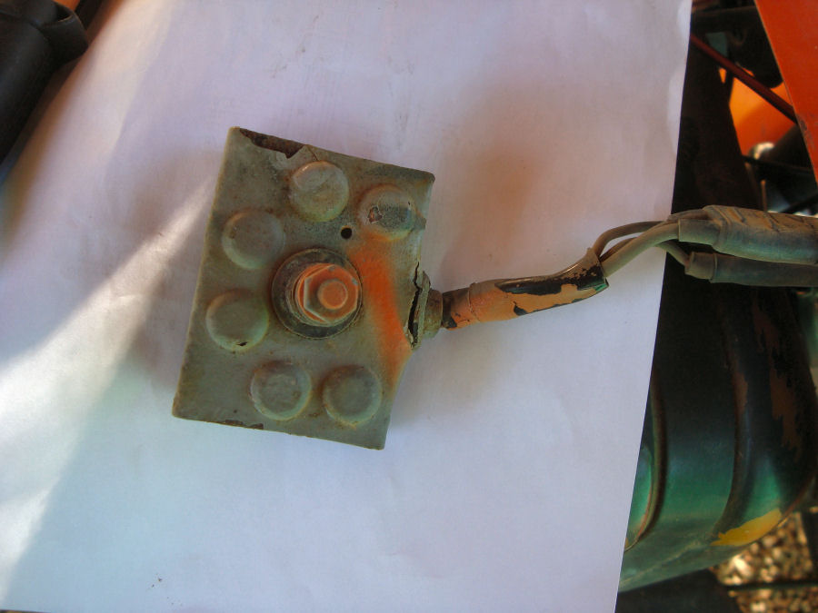

I started with disconnecting the alternator (dynamo) an measured the output. At high speed it varied between 30 and 40 volts which should be OK.

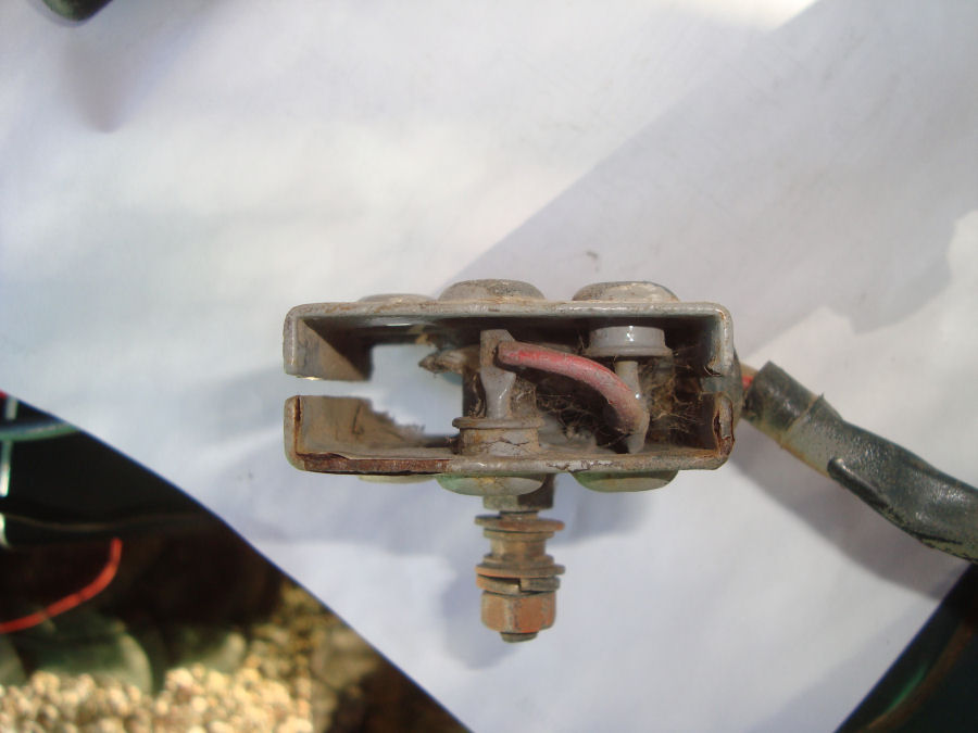

Then I removed the rectifier from behind the dashboard and measured continuity in the two leads from the alternator. Only one lead had continuity. Then I saw that there was another connector which was not connected to the alternator. This one showed continuity to the rectifier! :) So I used this instead and got charging! :D
I am however worried that there is no regulator only a bridge rectifier what I can see. :confused: One explaination could be that the old engine had only a low output dynamo in the fan so there was no risk of overcharging the battery. The D950 engine have a dynamo with larger capacity (about 14 amp) and therefore might need a proper regulator?

I tested the rectifier today and as suspected the voltage rose to 16 volt with the battery connected which is to high.
When I turned on the headlights it came down to around 14 volts.
Therefore it seems necessary with a regulator so I ordered a voltage regulator with rectifier for Onan John Deer 318-420. This is good for 20 ampere and set at 14.4 volts. I found it on Ebay for US $ 21.
