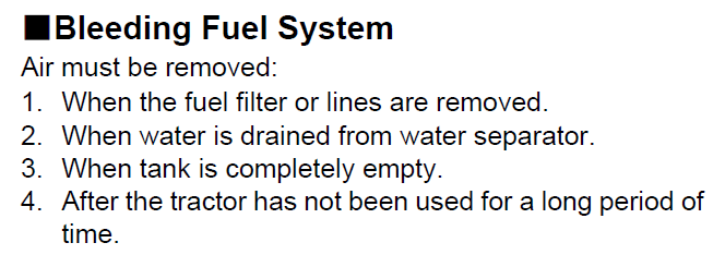

Maybe I should clarify my comment. There is a 'bleeder' but it's on top of the injection pump and when you change fuel filters or clean the separator you will have air in the bowl. You open the valve on top of the injection pump and allow the pump to expell the air in the system. That is the only 'bleeder' anywhere in the fuel system.
Air entering the bowl while the engine is operating (which has zero to do with filters) is a result of what I stated.

Gee... I have the Kubota WSM's for both mine but the owners manuals state that as well. In detail I might add.
Again (for the last time as it's getting tedious), if there is air in the plastic fuel bowl when the motor is running (not when changing or renewing anything), there will be a issue upstream from the housing. Could be a fuel line, could be the bowl gasket, could be a cracked bowl. You need to diagnose the issue and correct. real simple.
