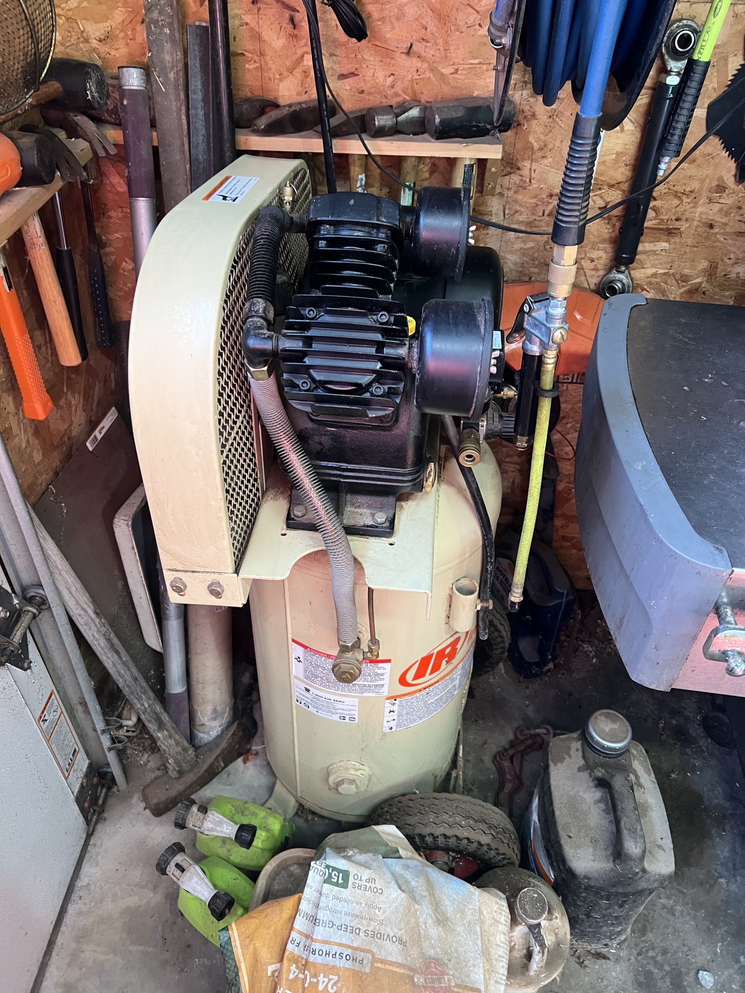

I ended up with a 20 Gallon Ingersall-Rand.
It's not anywhere near 9cfm or an aluminum tank. It's quiet, and has a 100% duty cycle.
I would NEVER go back to an oilless compressor. I gave my old one to my neighbor across the road. I heard it running last year.....from the inside of his garage....

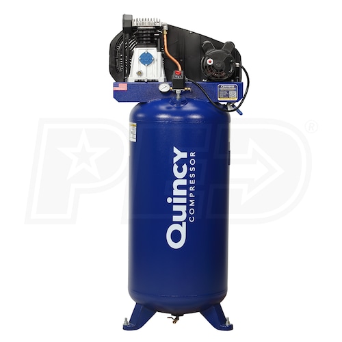

Too many amps!
This might be the ticket
I have the "little brother" to that one. Quincy, 26 gallon, 120V model.
It's a fine little compressor that has performed admirably thus far.
It powers my impacts and my CNC plasma cutter pretty well.
I don't have any "hard numbers", but it is "noticeably quieter" than the old Craftsman that it replaced. (which still works, but has been retired to the cottage)
Although if I were to "do it over", I would have picked something like you posted, maybe even bigger.
As a side note: I tried an "Oil-less model" about 25 years ago. After about 15 minutes of using it, I boxed it back up and returned it to Sears, due to the insane noise level. Not sure how the new ones stack up now though.

Too many amps!
I have the Quincy QT54 .... from Northern Tools. free shipping also.
had it over 5 years.
my advice is don't fall down the rabbit hole of over thinking dry air with all kinds of inter-coolers and crazy piping....
I use an auto drain off the bottom tank drain....
Off the top air output it goes up to the ceiling then down to 1 drop leg with a ball valve drain
then into a water separator
then a Motor-Gard M60 filter
then into a small desiccant filter and finally a regulator.
sounds like a lot but it's all in line...
works fantastic. change desiccant MAYBE once a month.
I save the desiccant and dry it out next to the wood stove and reuse it.
pink/wet blue/dry
