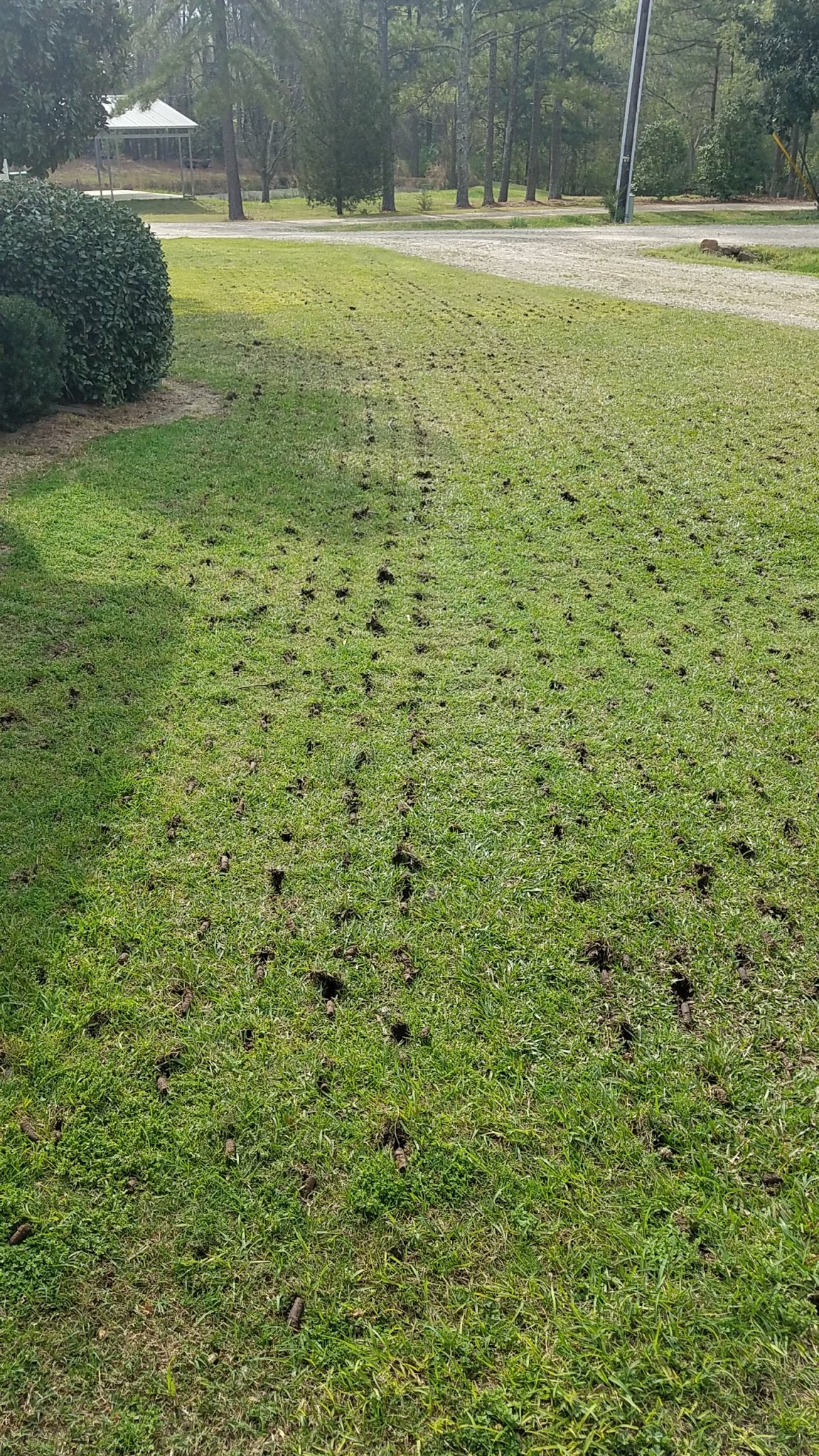

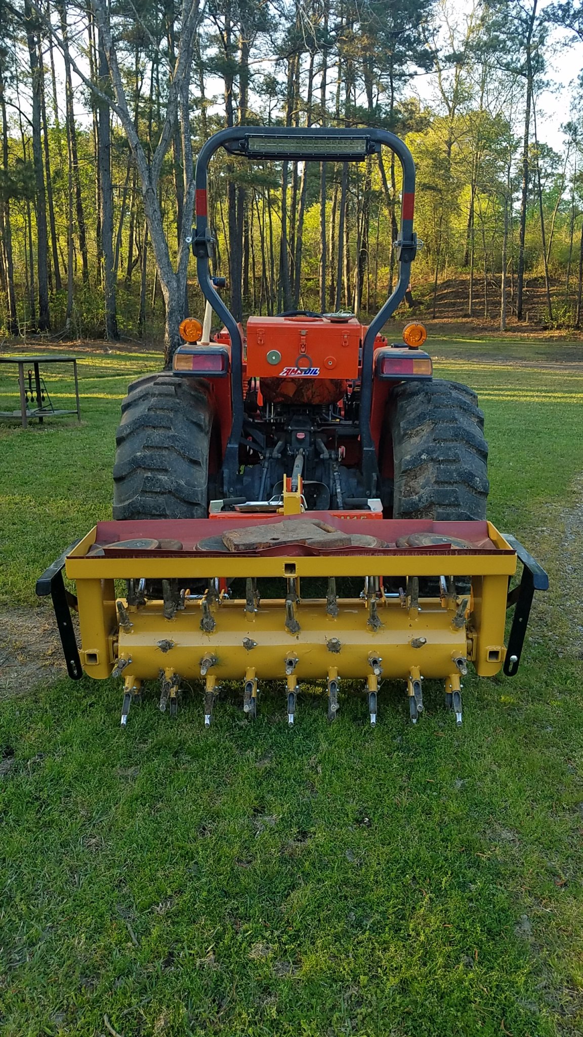

I have both and no real comparison, what do you plan to do with it?
I have a 5' spike I use to cultipack my food plots and garden. Just not enough weight even filled to punch a place in the ground that does not quickly fill in or close up.
My 5' core aerator I use on my lawn and all over the farm.
The core aerator is a beast and pulls nice plugs. It has a tray that I had 300#'s to when I aerate the harder packed areas like around the garden or fence and tree lines where we drive a lot.
Where no driving takes place the weight along of it is fine. It came from Everything Attachments and the drum is filled with sand.
What you plan to do with it really makes a difference.
Not seen a pull behind that was core as you have to lift it to turn or it would bend the spoons.
The core aerator is great for adding fertilizer and seed followed by dragging to lightly cover seeds and fertilizer. If not applying either I leave the plugs on top and after couple cuttings they are gone.
Be glad to try answer any specific questions you may have.
