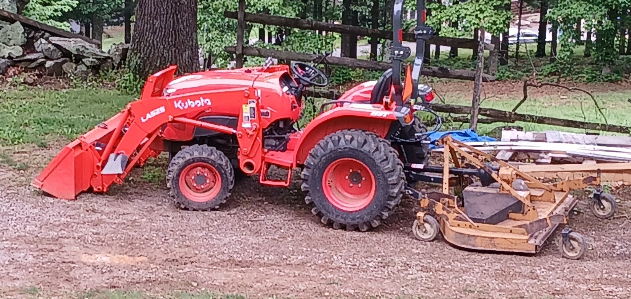

Here is an L3901 with loaded R4s, a loader, and a Woods finish mower ready to mow my lawn. I am very picky about my lawn and the loader and loaded tires are a total nothing burger. A much bigger issue is the quality of cut I get from that Woods mower...

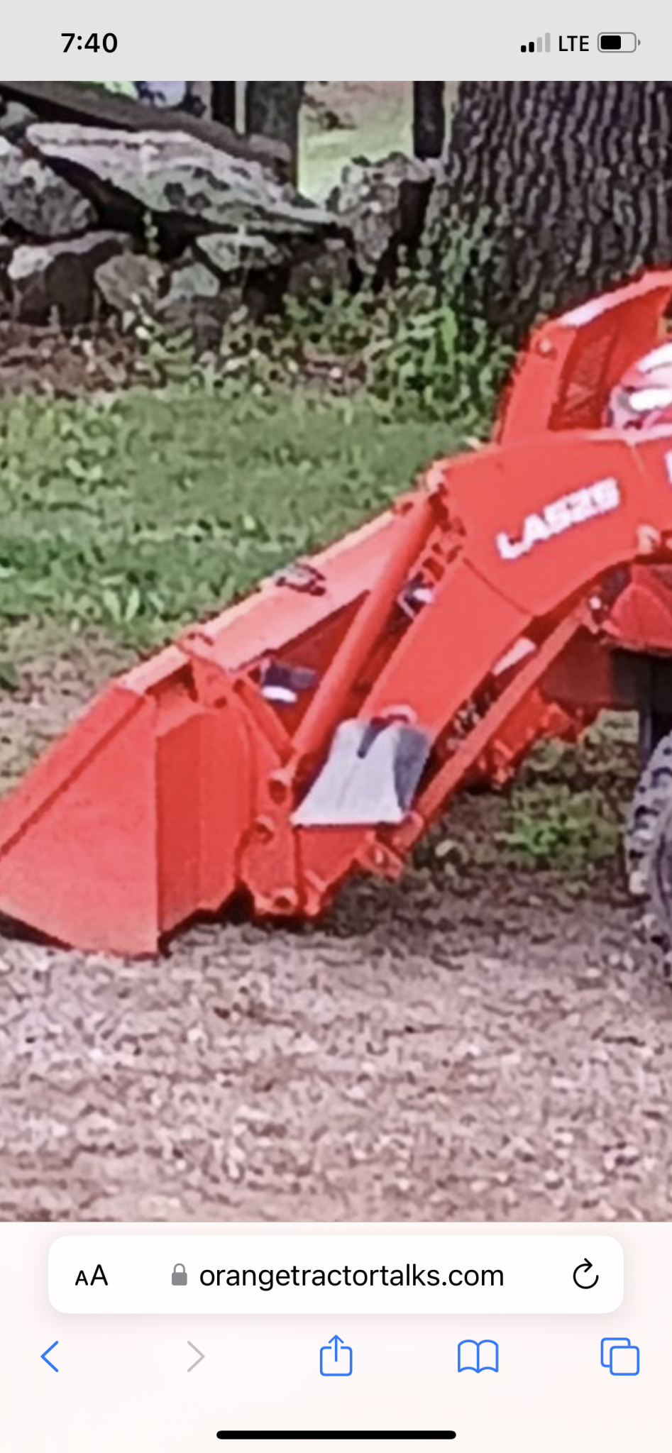

What is on the side of the loader frame just behind the bucket about at the height of the cross pipe in the loader frame?

Oh. Thats my current nemisis - a square point shovel stowed in the cross tube. We go a couple short rounds each day and it akways wins :cry:
That’s funny. 😄 I wondered what that was…such an odd shape there and I never even thought about that being a shovel. 🥃
