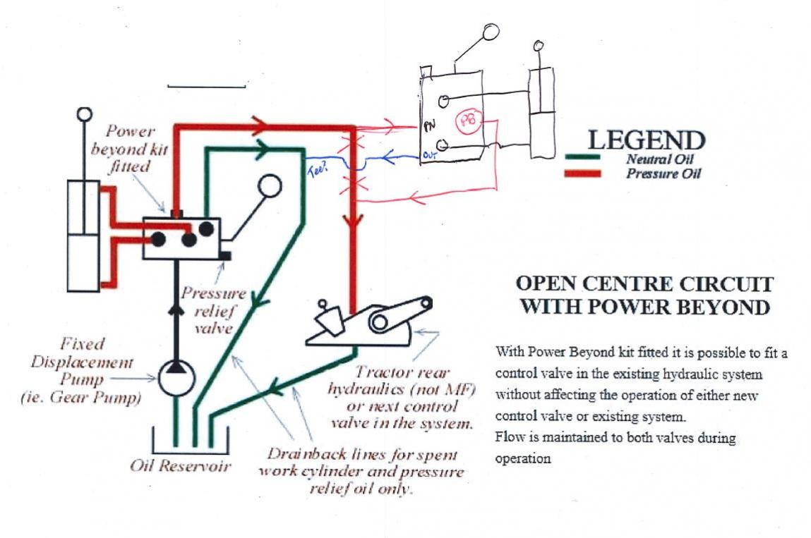

I think i've read all the posts regarding adding a third function or TNT or rear remote to a Kubota. I'm still stumped..! Here is what i'm looking to do to my B2710 with LA402 loader:
Add an additional hydraulic cylinder, powered in both directions. I don't need joystick controls, just another valve block i will mount.
I'd like to understand the whole Power Beyond circuit and plumb this correctly, and on the cheap. I've attached a sketch of what i think it should look like; does this look correct?
This diagram is exactly correct and what I did on my B2150. I cut the hardline that runs down the right side of the transmission tunnel and brazed in two 90* elbows. Come off the front hard line elbow and go to the pressure in on the rear remote valve, then out the PB circuit back to the other 90* elbow that then goes on to the 3pt hitch control. The tank port off the rear remote valve goes into a Tee brazed into the hard line from the 3pt hitch control to the tank reservoir. Hard to see the details, but here's some pics:

Can i do the same after the FEL block using tees and hoses? Not too keen on brazing.
Yes, in theory.
1) Hose out of PB port on loader control to PRESSURE IN on rear remote control.
2) Hose out of PB port on rear remote control to the hose that WAS in PB loader valve.
3) Hose from TANK port on rear remote control to a newly installed Tee in the TANK port hose found at the loader control.
Lots of hoses in that scenario, depending upon where you want to place the added spool valve.
