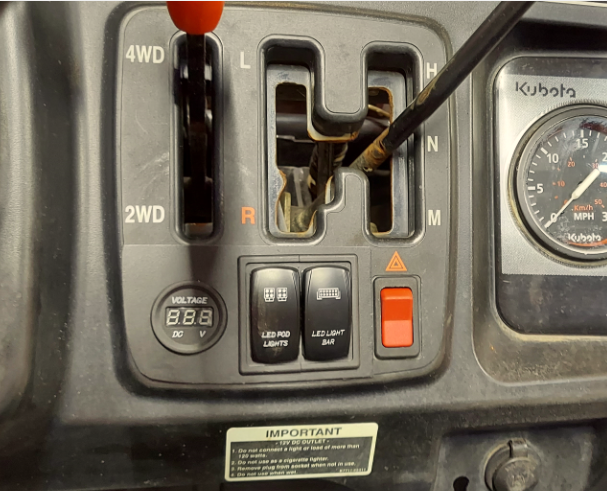

Hi @Clevus
Here's what I did to add lighting to my RTV1140CPX.
Hopefully it will inspire you!
  1. The switches are from Nilite (see amazon)
  2. The LED lights (also Nilite) I added were front and rear (thus two switches)

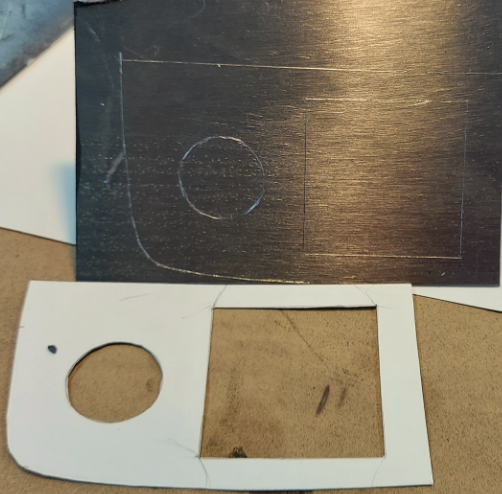

First I made a cardboard template from the area on my RTV.
Then I scribed that pattern onto a piece of metal.

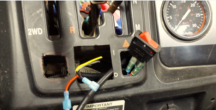

I then cut out the holes for the switches and voltmeter.
I mounted the panel with 3M double sided tape.
Wiring is using relays so that the light load is not thru the switches.

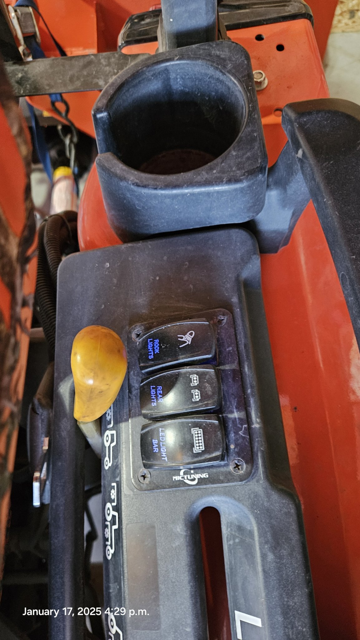

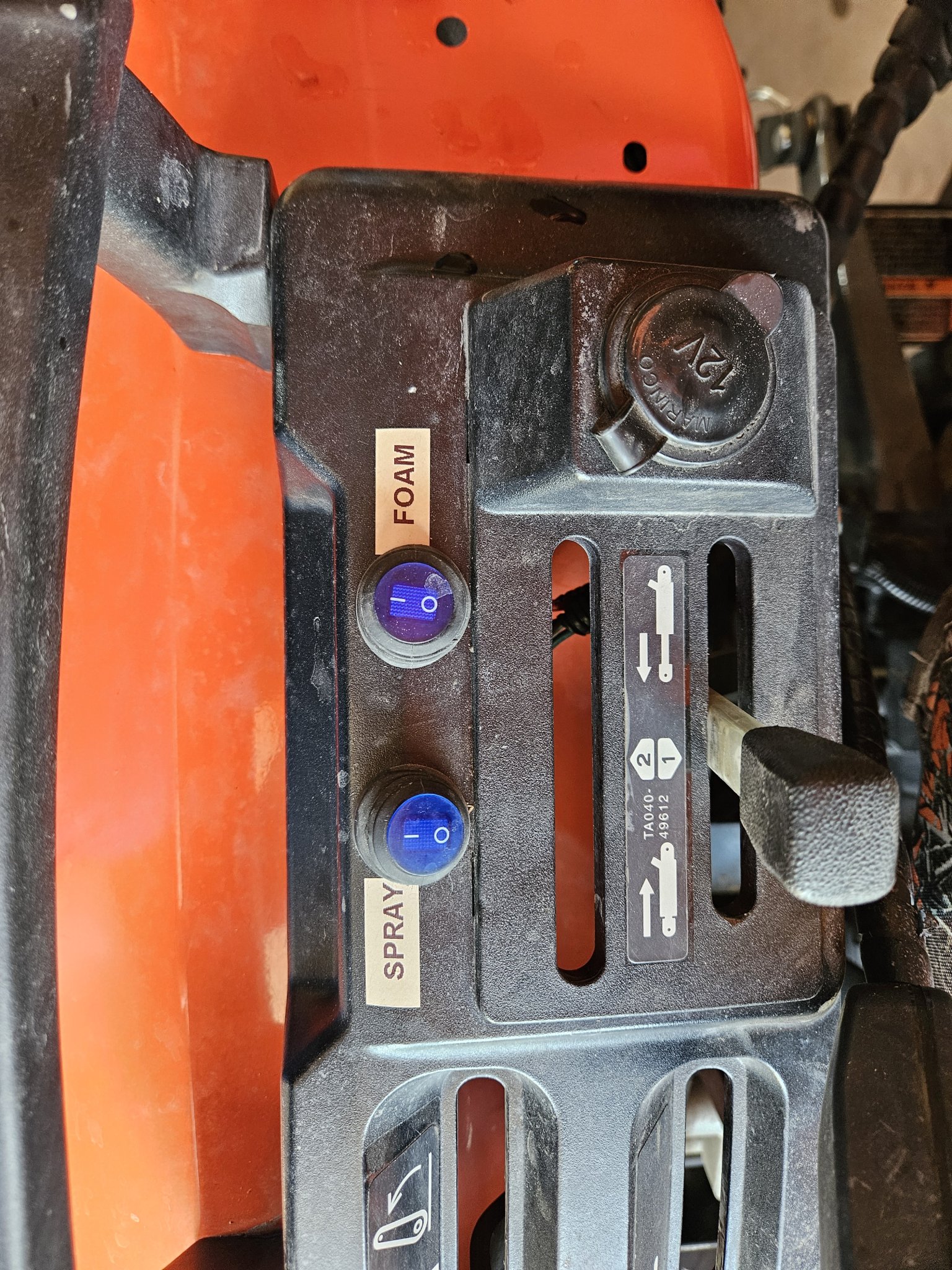

I like the dash idea, however I went a different way on my B2601 . I put the switches in the fenders, as it was simpler and easier than tearing into the dash. The left side is for the ROPs lighting and the right side is for the sprayer and its foam marker.
