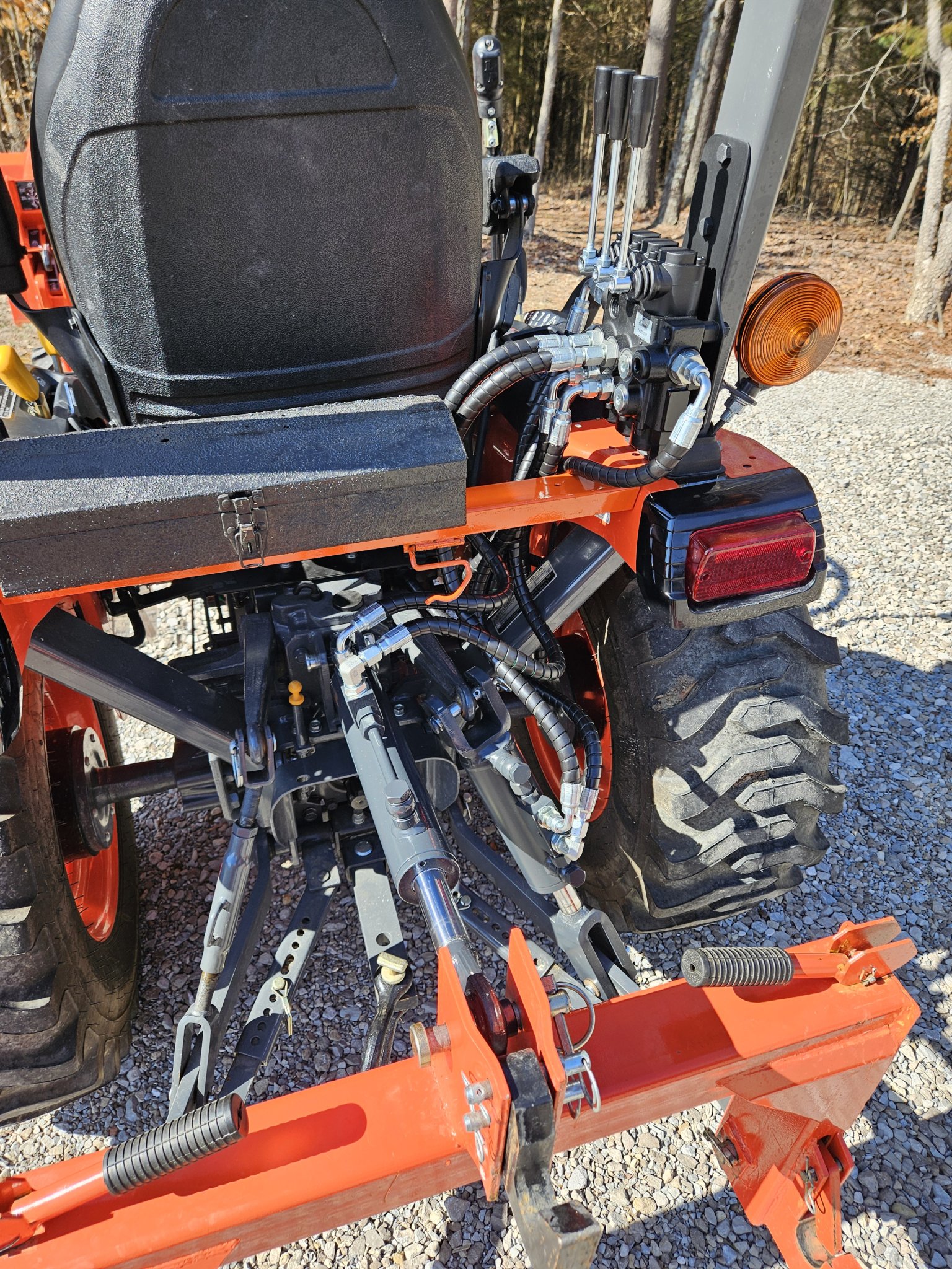

Here's my 3 remote setup with Summit valve plumbed as Dan described off the third function valve body (plus I added top and tilt cylinders). Any new lines I needed I got made locally. Super pleased with how this has been working.

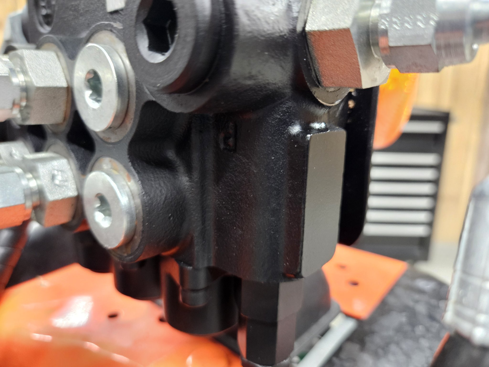

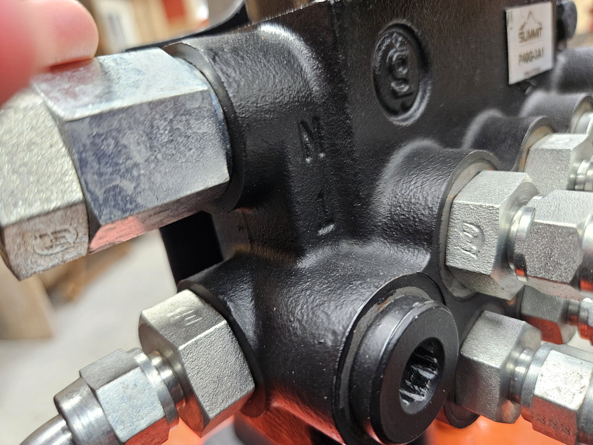

@matt-m: What's the second host leading to the valve block on the left side?
Good eyes!
He is using a manual valve which has both a tank and a power beyond outlet. What I described is Summit's electric valves that only have a tank outlet. AFAIK thats the only 4 valve kit Summit offers.
10,812
5,925
What purpose does the additional outlet serve?
It provides a direct to tank return path for oil returned from the cylinders. The electric valves send return oil to the downstream valves which has the potential for creating undesired interactions.

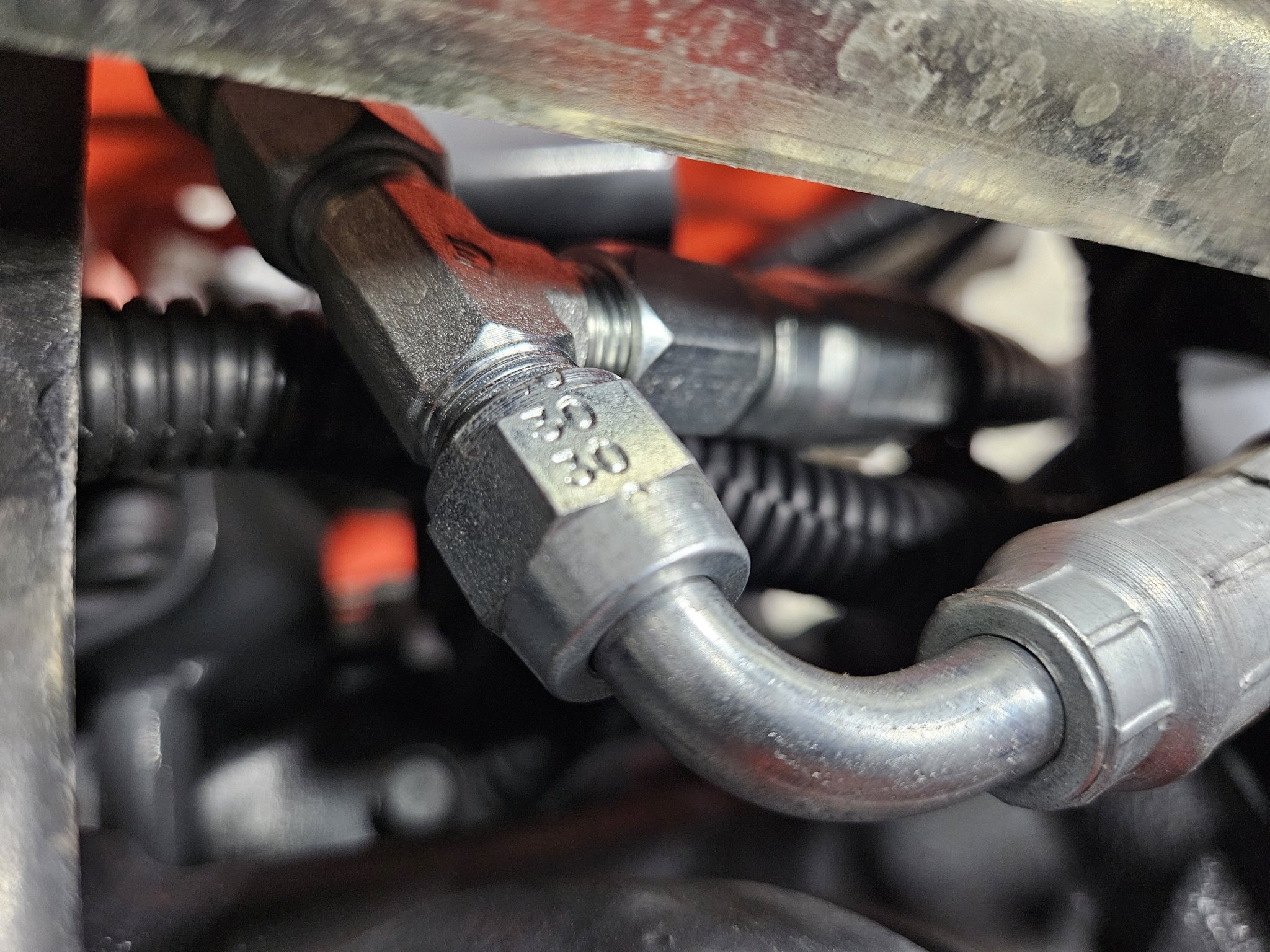

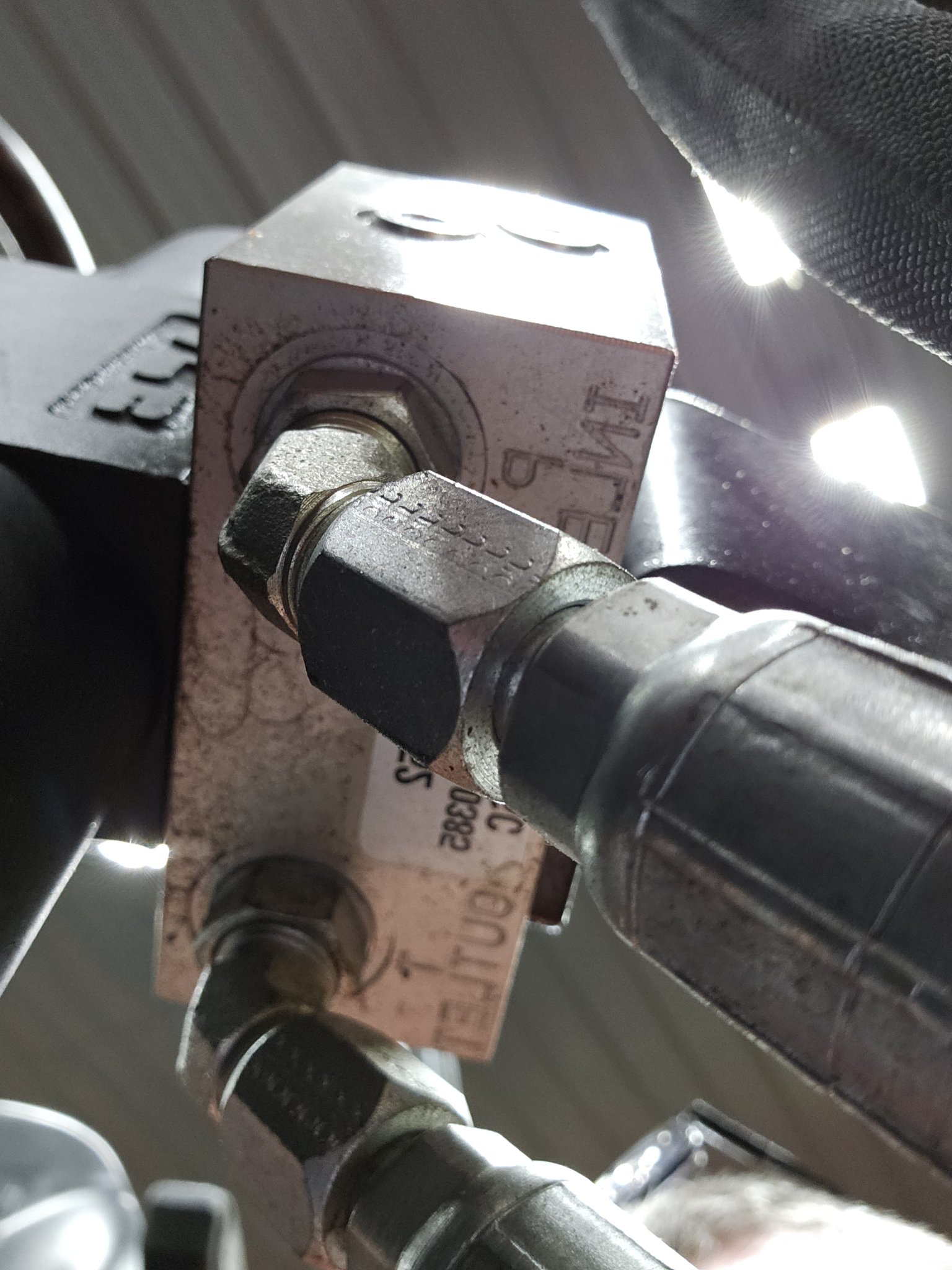

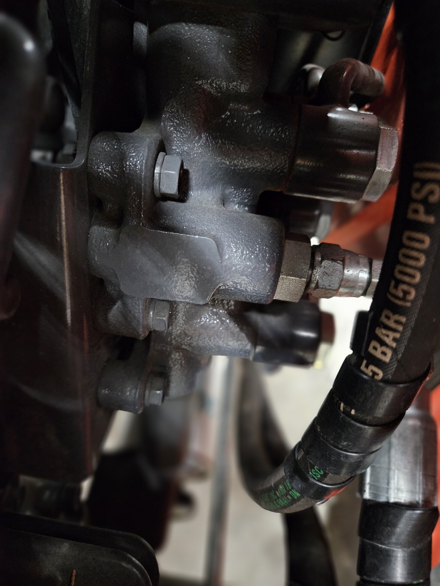

I checked routing again so let me clarify. Not saying this is optimal but it has worked. Also dealer told me Land Pride on the third function but I haven't verified.
I start with this outlet on the tractor (the 90 deg tube fitting with hose exiting bottom of pic):
In to the power port of the manual Summit valve
Out of the power beyond on the Summit
Over to the power port on the 3rd function
Then the tank outlets on the third function and the Summit valve are teed together at the hose connected to case drain port

That "works" but its not right. That connection is not a case drain it is the power beyond going to the 3pt.
You have the T port on the Summit valve teeded into power beyond effectively defeating the power beyond sleeve in tje Summit valve. The T port on the Summit valve is being over pressured every time you raise the 3pt or operate your top and tilt.

Ok what I was calling the case drain is where the tank line from the 3rd function was plumbed as received so I assumed it was a drain. Sounds like I need to find a proper drain location for the Summit tank drain line. Thanks Dan.
10,812
5,925
Your confudion is understandable given the bogus description in the Landpride instructions.
I was actually wondering where you ran the T line because there are not a lot of convenient places on those tractors....
BTW the Kubota guy had you put the Summit vslve ahead of thevl third function so he is probably equally confused.
