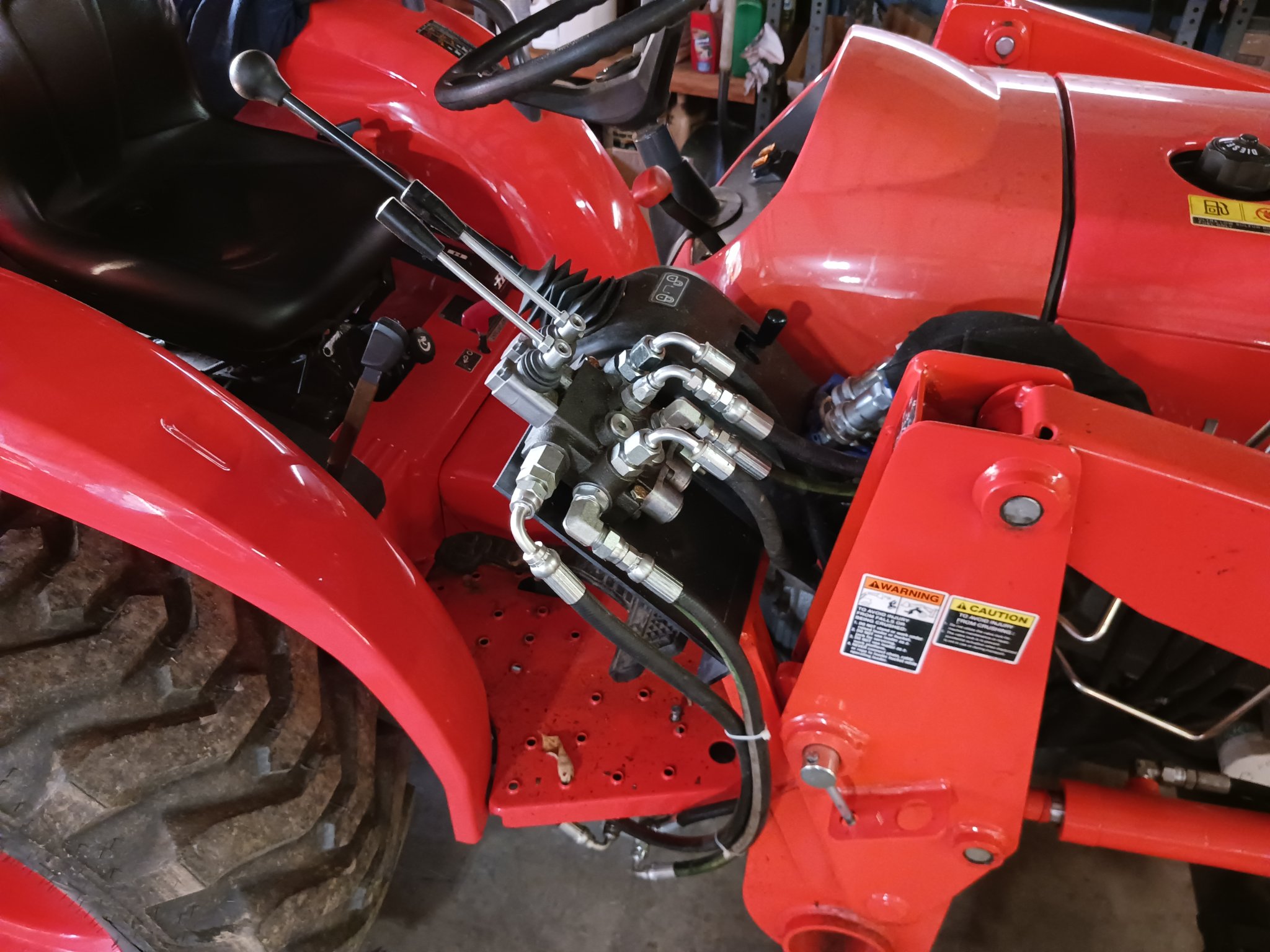

Here is a two spool manual valve on my L3901. Probably cost less than $300 total to install.
