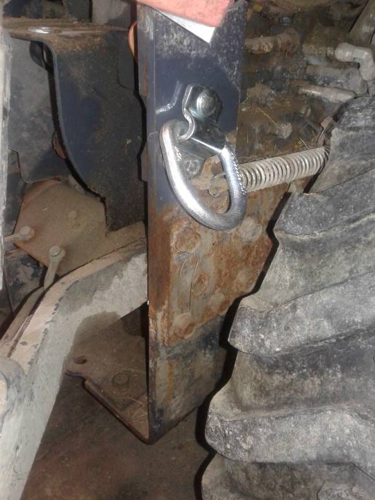

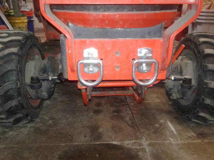

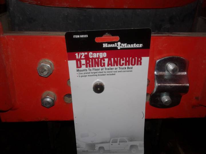

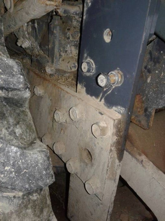

Added tie downs to the BX today. Used 2 Harbor Freight #60323 D-rings (1 7/8" hole spacing)
Used stepped drill bit to convert and enlarge square holes into 1/2" holes.
Not happy with factory bolts, replaced them with 12x1.25mm - 45mm long.

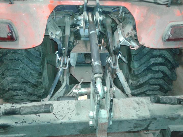

The HF rings may work in the rear. Had left over D-rings with 2" hole spacing
Installed rear anchors diagonally in existing holes. No drilling required, factory bolts were long enough, 3/8carriage bolt in top hole.
