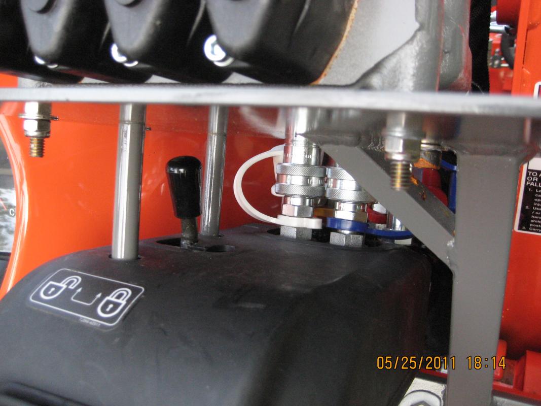

Finished up my rear remote and top and tilt install on my new Kubota L3800 this week.
The spool valve and hoses are from Surplus center. I went with a four spool Wolverine valve.
All of my fittings were purchased from Discount Hydraulic Hose, they're close enough to me that standard ground shipping is overnight.

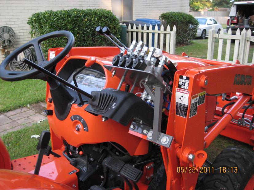

I decided the best place to mount the valve was on top of the loader valve. I fabricated a mounting bracket out of scrap steel from the scrap rack.
Aside from the welding to fabricate the spool valve bracket the entire install is a drill a few holes and bolt on installation.
I wanted to mount the new spool valve lower to the loader valve but needed enough clearance to operate the loader valve lockout. In reality the loader will probably always be mounted except to service the engine.

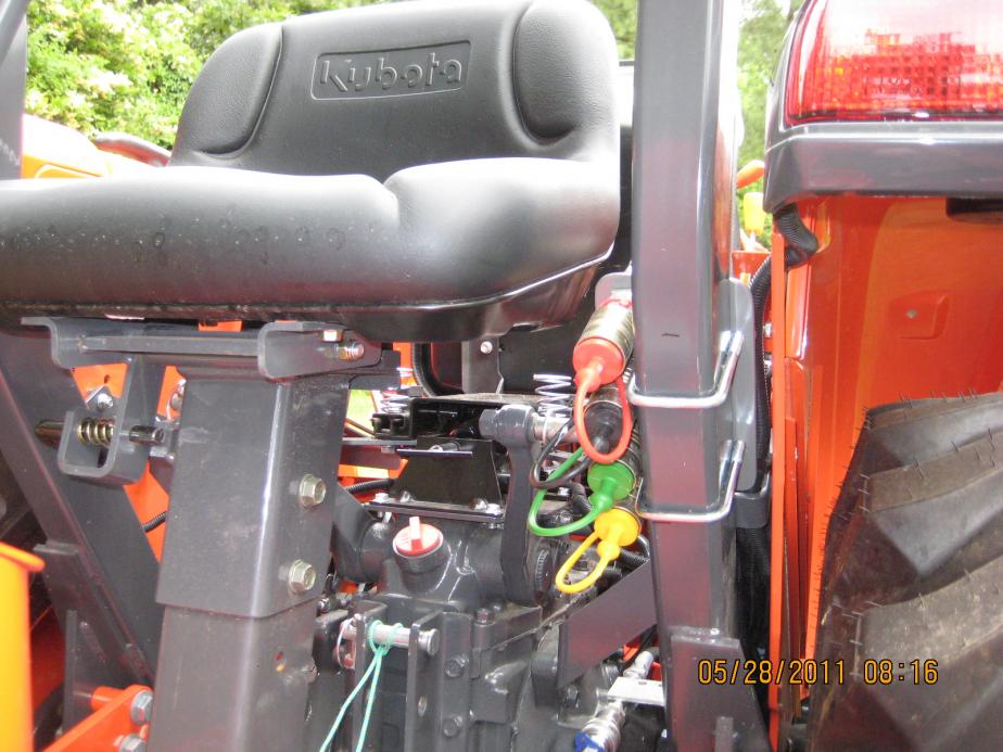

The rear remote mounting location was a challenge. My L3800 has the factory backhoe. the remotes had to be out of the way to clear the backhoe and of course the 3pt and top and tilt. It took a lot of prototyping to make it work. There's not a lot of space back there on the L3800 and I didn't want the install to look like a strap on after thought. My final decision was to mount to the side of the ROPS. I fabricated a mounting plate and used U-bolts to attach. Grainger had the best price on the U-bolts, only because they don't charge shipping if you pick up from one of their branch stores.

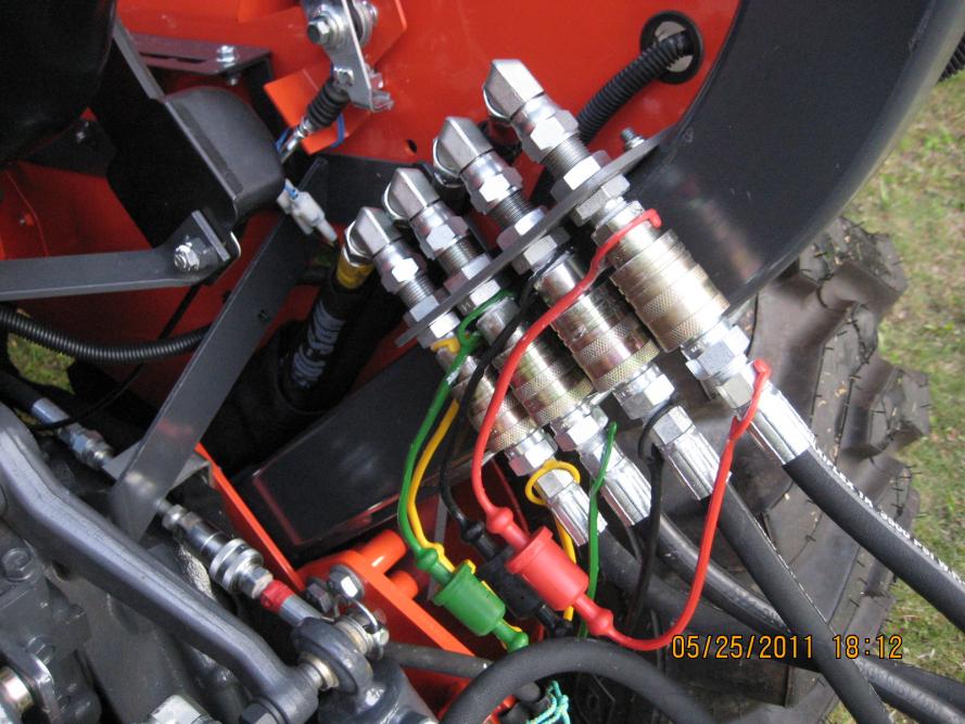

I'm not going to go into a bunch of detail on the hydraulic plumbing. It's really so simple once you understand the whole power beyond concept.
I've only plumbed two of the valves to serve the top and tilt remotes for now. The other two are capped and I haven't installed the handles. Once I add hydraulics to some of my 3pt attachments I'll complete the plumbing and mounting of the other two remotes.

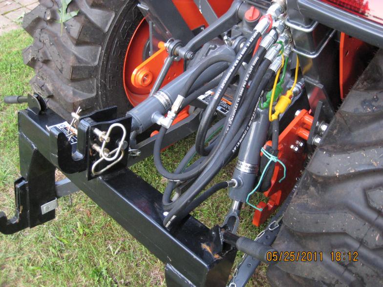

The top and tilt cylinders came from Fit Rite. Brian was great to work with and is very knowledgeable about the whole T&T setup.
And it didn't hurt that he has the best pricing and quick turn around.
I had ordered the T&T cylinder kit from Brian before I took delivery of the tractor. I thought that I was was getting a Kubota L3400. Brady Barlow emailed me and said that since the backhoe sub frame for the L3400 was on back order he was going to upgrade me to a L3800 for the same price. I couldn't complain. Brian at Fit Rite said there were subtle differences in the tilt cylinder length. All-though It seems to work just fine with the HF quick hitch mounted. I'll know for sure once I take the tractor back to the mountain property where all of the 3pt attachments are stored and test the T&T.

Anyone getting ready to order a T&T for your Kubota L3400 or L2800??
When I had my tilt cylinder made I thought that I was getting a L3400 and then Brady Barlow upgraded me to a L3800.
According to Brian at FitRite my tilt cylinder is too long.
I was hoping to trade cylinders with someone that is getting ready to order a T&T set up from FitRite for their L2800/L3400.
I haven't yet had a chance to use my T&T yet. All I've been able to do is mount it, plumb it and mount the quick hitch.
Hey there -- I know this is an older thread but I'm getting ready to add remotes to my L3800 also. If you had to do it again, would you have picked the same location for the valve body (on top of the FEL control)? or would you have put it to the right of the seat/back of the 3PT hitch lever like some others have done?
Your setup looks like it was easier to install since it's in the "open space" on top of the FEL control, but I think the ergonomics of having the valve handles to the right of the seat is better.

I did consider mounting on top of the fender (with added support of course)
But with a four spool valve that's 11 hoses. Pretty busy and potential safety factor if you developed a leak.
If I was doing it again I'd used a dedicated valve for the top and tilt. A loader type valve with one control handle. Probably mounted underneath the seat area, control handle to the right of the seat.
The third function for loader grapple etc. would be a dedicated loader handle mounted rocker switch tied into a solenoid valve.
If you needed more circuits for the three point i.e. blade pivot, offset, retractable scarifiers, you could just add a electric diverter to the tilt circuit.

Paul I realize this is an old thread. Do you have a picture of the mounting of your mounting plate to the tractor? That angle pracing and where it's mounted to the loader frame?
I have the same valve and putting it on a L3301.
Lenny

I traded that tractor in on a L4240 let me see if I have any other photos of the spool valve mount. It was a custom mount that I designed and fabricated.
