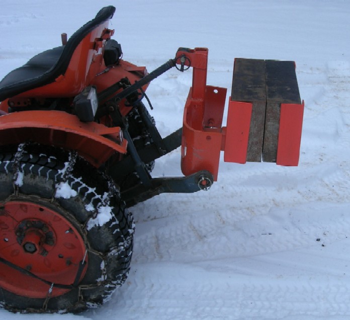

Here is a home made rear weight frame. This goes into a home made 3 point hitch frame for my 2" hitch box connector. The weight frame is just angle iron, welded onto a 2" bar. The weight blocks are iron but were intially just going to be 4 solid concrete blocks, but the steel was free to me, so I built around that instead. I just couldn't see building a weight box that can not be moved around without the use of the tractor. I think this goes around 250#, and makes all the difference on traction on a B6000E with a snowcaster front snowblower. I'm now learning to steer using the rear brake one wheel at a time with the split break pedal.

Jeese those are not inconsiderable chunks of steel. You steal some battleship armor? :) Nice setup. If I ever get around to doing a blower I was going to do something like that or I saw someone who build a 3pt attachment point for a metal trashcan and then filled it with rocksalt.
