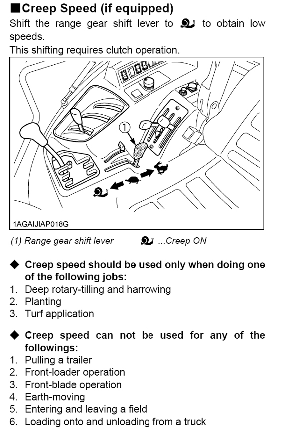

Are all the creep gears slower than low range? If so, tilling is about all I could see it being used for.
Creep speeds are useful for certain implements, e.g., transplanters, etc., but are not intended for high power tractive loads.
From the M6060/7060 owner's manual.
