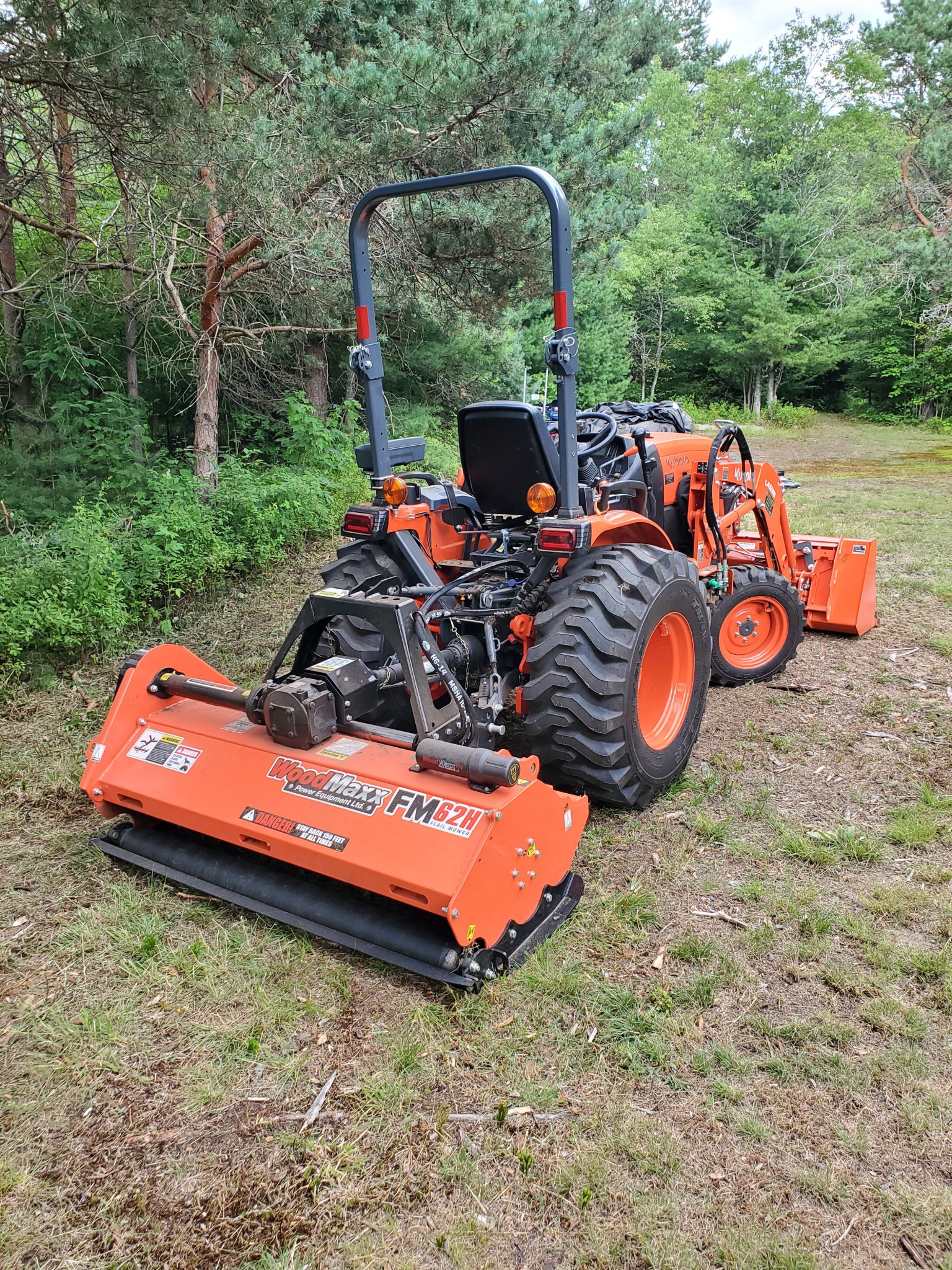

I have a woodmaxx 60 inch for my LX2610su. You will be fine running a 60 inch Flail on your tractor. I have the duck foot blades and it will go through wet grass a foot tall and it doesn't really sound like the engine is even working. I don't typically mow very fast, range lever is in medium with light hst pedal application. My biggest regret is not getting the 78 inch for mine. If you were closer I'd sell you mine so I could go bigger. Here is a picture of my setup

Thank you. This was exactly what I was hoping to hear.
