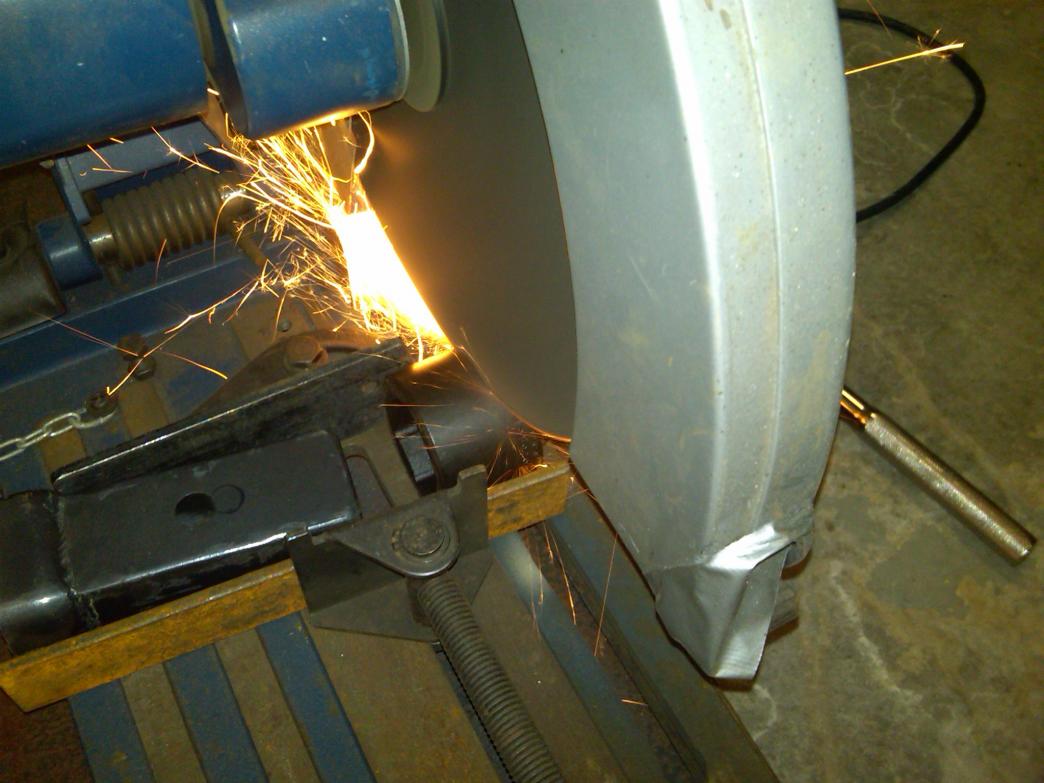

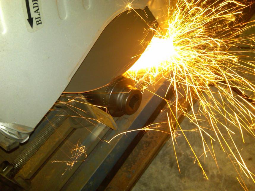

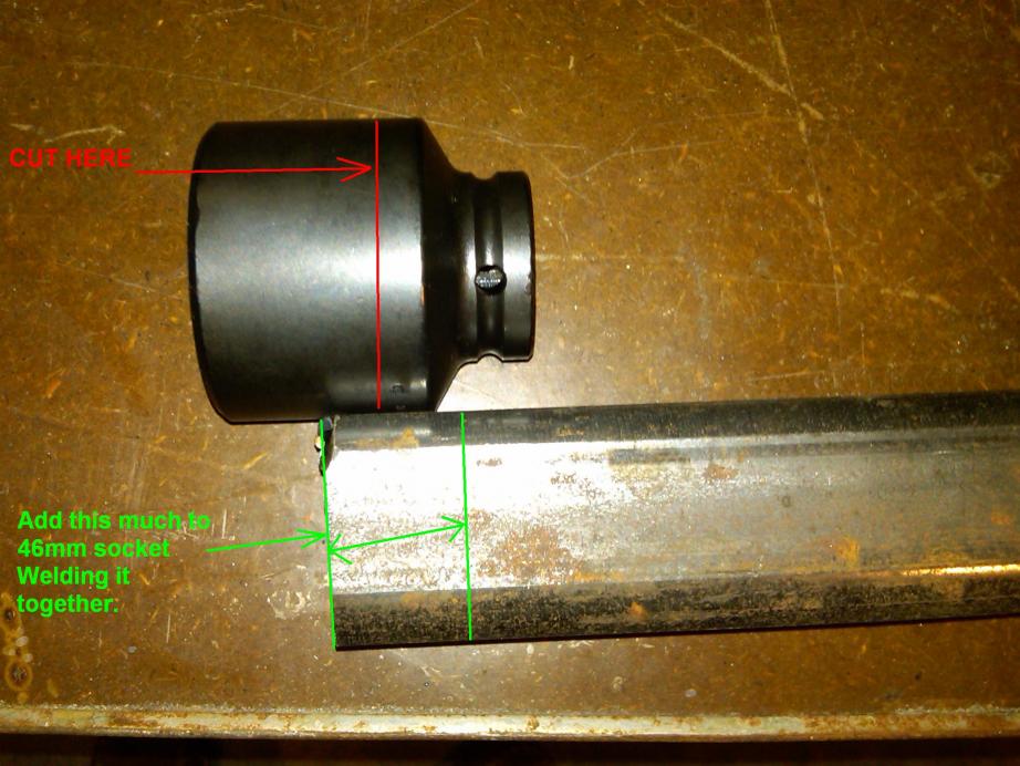

I needed a 46mm socket to remove the crank nut on a L295DT/D1301-A 3cyl motor recently.
Couldn't find one, so I took the size that Grainger had and made it longer with some square tube.
Just some pic's of the process.....for fun
