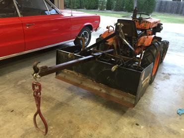

I had this set up on a 26 HP JD when I cleared some land for my house. I took a new box blade, had a cross brace welded in and bought a 2 foot receiver from a trailer supply house. The telescoping portion is heavy gauge box tubing with several holes drilled to lock in various positions. Can't remember where the hook came from but most likey Northern Tool or Harbor Freight. It's come in pretty handy for dragging but might be useless on a 16 HP KUBOTA.
