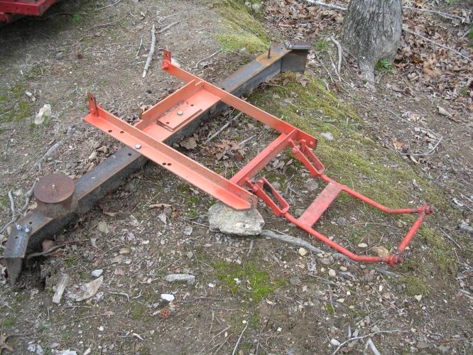

Some where in here someone posted pictures of his rear blade and had made up a set of sides for it , It would only take a couple of minuets to take the side plates off and on,, a great idea, as soon as I can find some descent prices on scrap steel plate
