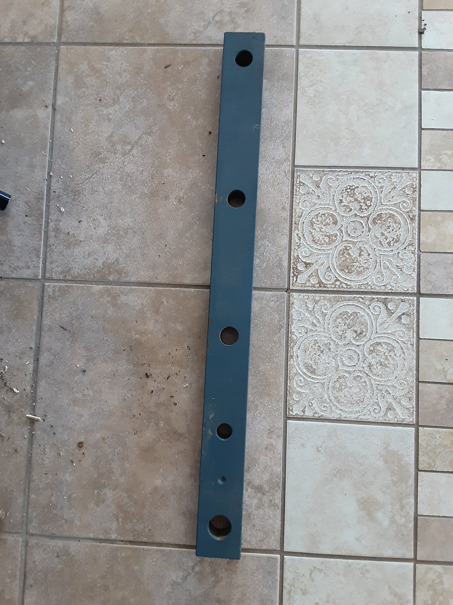

animals45
So After a couple searches I found my draw bar where I put it so I could find it easily.
I believe my L2501 is the same as your tractor just a different engine? It is 23-11/16 long x 2 x 1-1/4 thick.
3 holes appear to be 13/16" at 1-5/16, 7-7/8, and 14-3/16 centers. 4th hole is 11/16 located at 18-3/8 center and the last hole is 1" located at 22-3/8 center.
The picture i hope shows you the layout I described if I errored when I wrote any of it. I switched it end to end before putting the tape on it.

I also checked and apparently mine isn't the same drawbar. Mine is TC 220-29710 and lists for $183.46. Don't know why so different but maybe disregard my post. So much for them being in the same family.

But to add more to the mix I looked at both models on messicks and they both take the same draw bar bracket, but the draw bar is different. So I would assume it is only in length or hole size?
