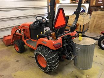

Have BX2200 with turf tires rear and rt4 front. I need weight on the back and was thinking there's gotta be some way to cheaply, easily, and effectively make a weight we can hook to the 3 pt hitch. Looking for ideas.

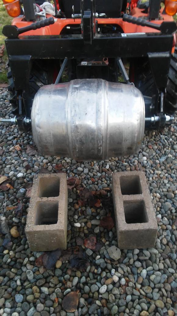

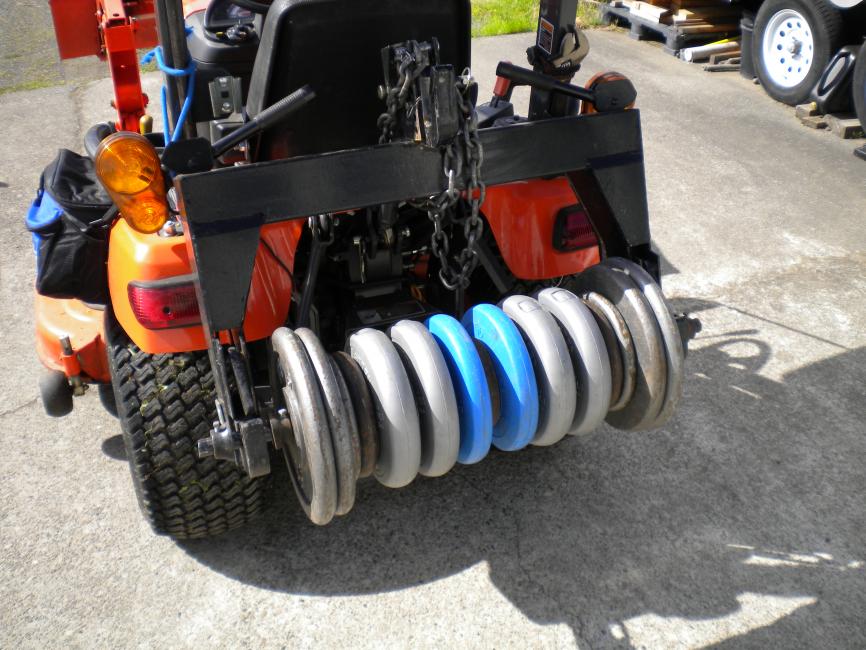

Either of these work. Barbell weights or a beer keg filled with sand or concrete. The keg weighs about 240 lbs filled with dry sand. The barbell weights are 235 lbs but has potential for much more weight when replace the lighter weights with heavier ones. I just need to find some more 25 lb weights for free.

As far as cheap weight, build a box, add some lift point for the 3 pt, and fill box with concrete. There are many threads on the subject both here and on Tractor by Net. Cheapest by far is to use an implement you may already own, like a box blade, snow blower, whatever. A carryall with a box filled with whatever heavy stuff you can find works too, and can serve more than one purpose.
Love the barbell idea and worl work great with a quick hitch.
