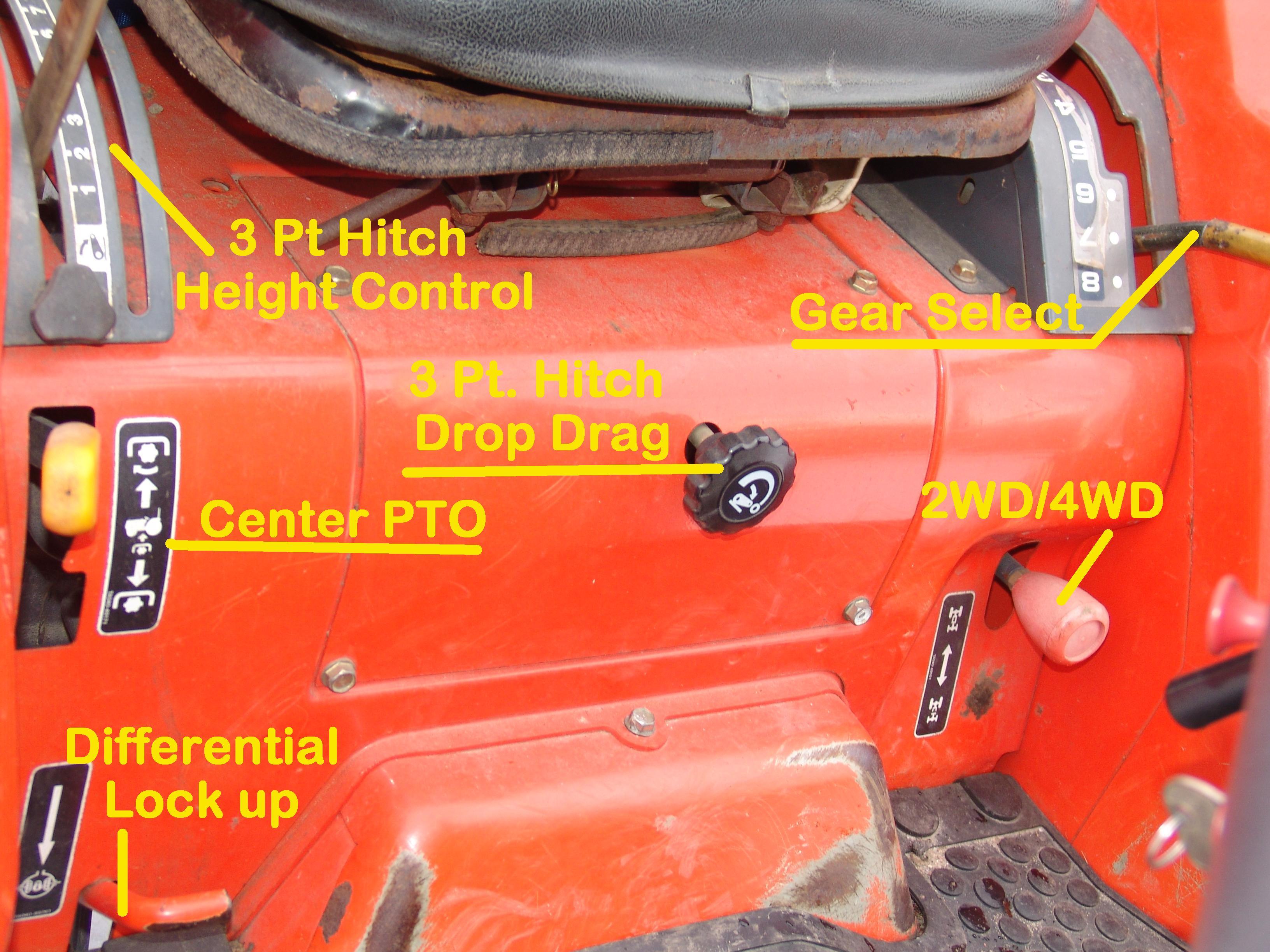

You guessed right; it sets the 3 pt arm height. The 3 pt hitch is always in float because the weight of the implement provides the down-force. The round knob (between the seat?) will adjust the drag factor on the 3 point hitch bars; how fast they drop. When you have a heavy implement you might increase the drag so it doesn't slam to the ground when push the lever down. It only controls the downward force drag and not lift.
Here's a photo of the controls on my L3600GST with labels if that helps.
http://www.oldgmctrucks.com/photos/kubota/L3600GST_Controls1.jpg
